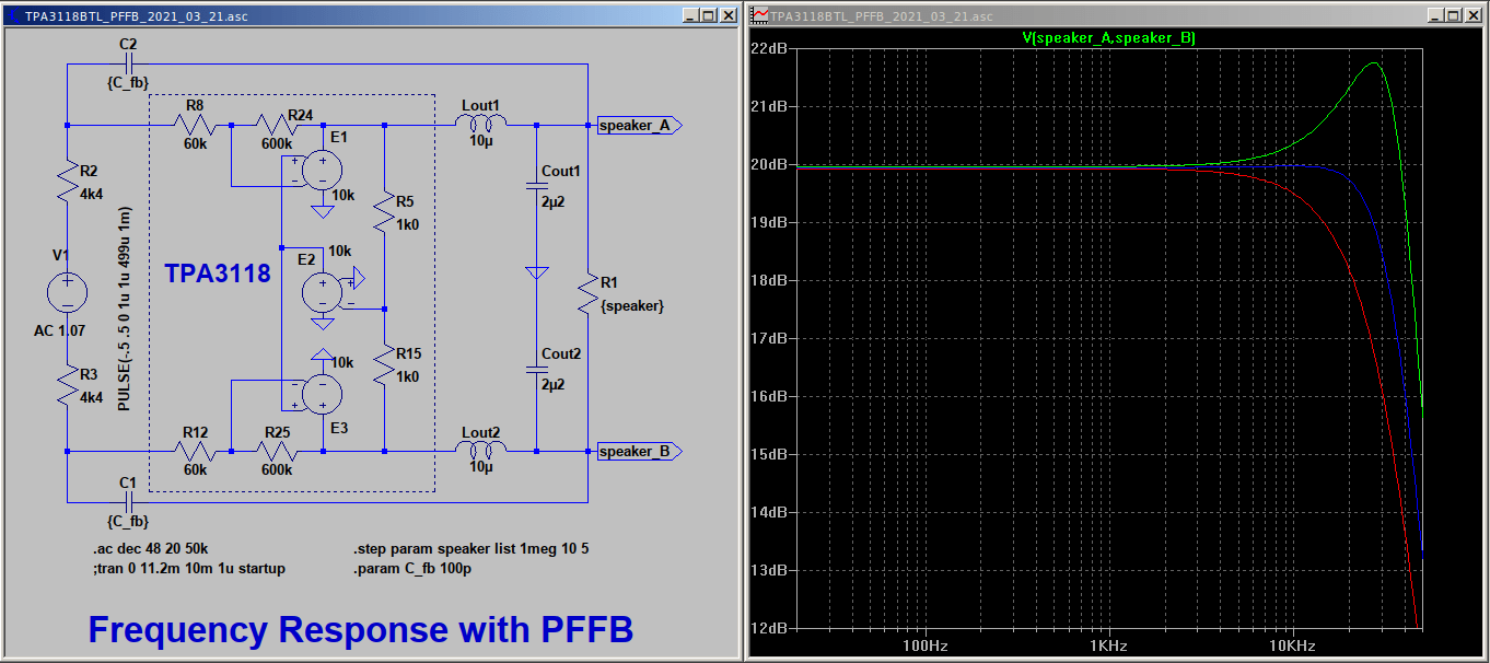

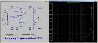

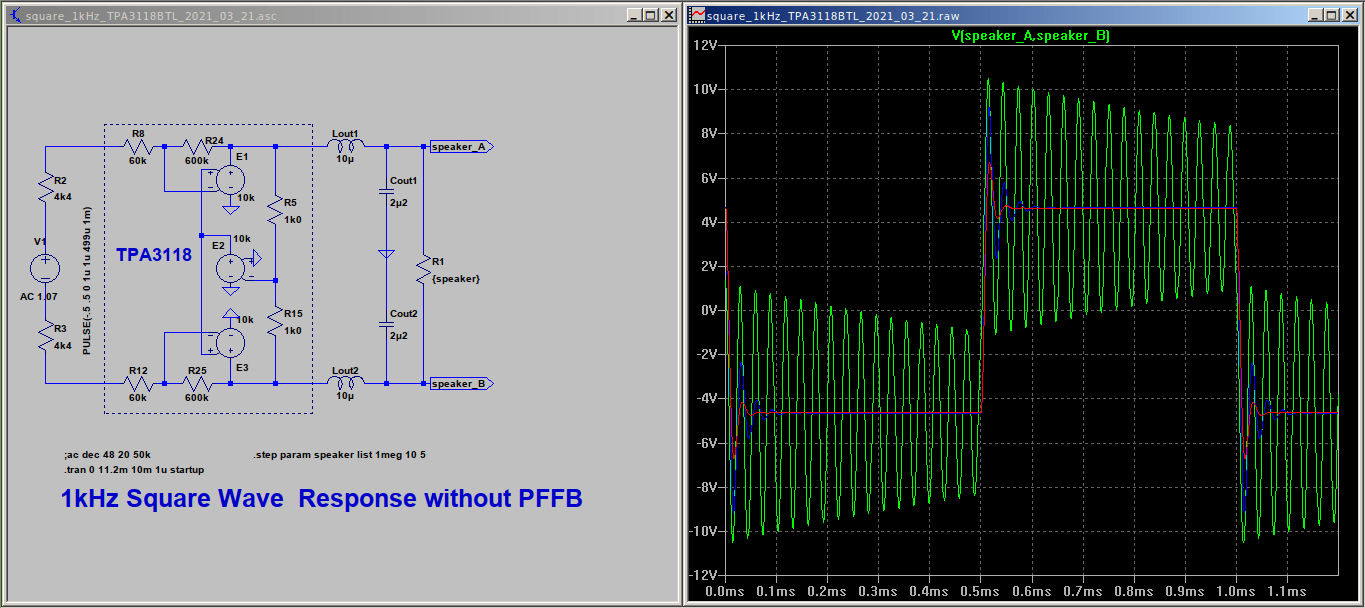

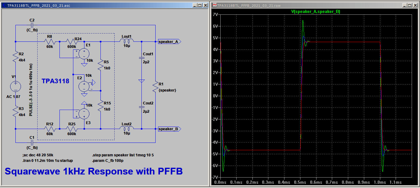

I do not find the old thread, but here are some essential files concerning TP3118. These things apply also for TPA325x and many others, I assume.

Those are some really encouraging and amazing results. So it looks like for TPA3118 or 3116, adding a 100pF feedback from speaker out to signal in is what is needed. For amps that are not balanced input (the negative input is tied to GND via a cap), is the feedback cap still the same value?
I have some TPA3116 amps I would like to try this on.
Where did you get an LTspice model of the TPA3118 amp from or is that an approximation?
