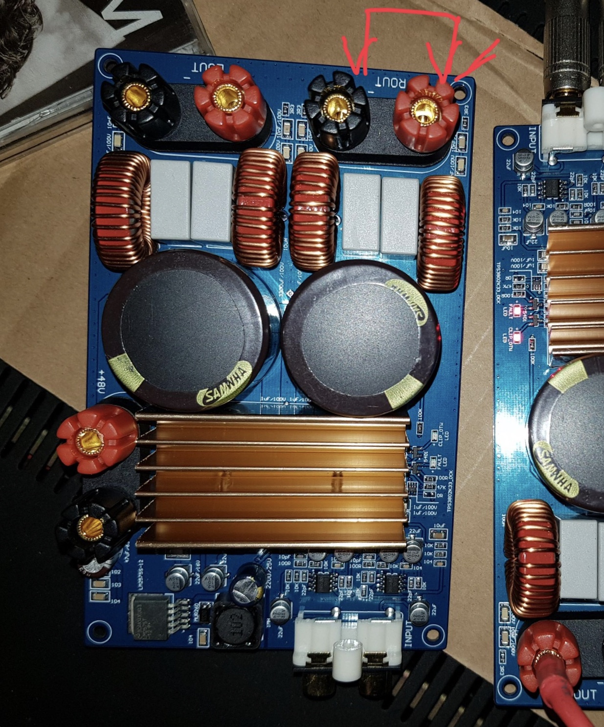

perhaps yours is not in Bridged mode or one or more of the 4 SE channels is not working. You have built many amplifiers and I know you measured across the outputs and not between one output and ground. I have the same board and it easily matches the rated power specs.

The Chinese amp is setup only as BTL. There is no GND terminal at the outputs. Here is an image of the same amp and where I measured.
I think the design is flawed because I bought two from two different vendors and they did the same thing. Both had error lights when they are working. Both could only output 48Vpp with 48V supply.
I might revisit it to see what’s going on. Perhaps the input opamps were not set up right and don’t drive a differential output? In which case, you don’t get bridged mode.
As I mentioned earlier in some related thread it is no good idea to measure (P)BTL against GND because THD relative to GND is one magnitude worse than measured diagonnally. For my knowledge XRK does it that way.
I think I measured the same way you measured using the similar symmetric voltage divider rig that you used. After Dr Mord showed me how you guys did it. Not relative to GND.

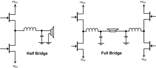

each half bridge output on this amplifier cant give more than 48v PP, it is impossible, you need two of those for 96v PP output swing wich is also impossible if he is shorting one half bridge output to ground with his oscilloscope.
no mistery and one side cant give 96v PP when other side is shorted to ground.

You are right because you consider the instantaneous voltage.
If you, on the other hand, look at the load voltage the way we have done it for decades (X-Y diagram: voltage vertical, time horizontal) you will have +48V (peak) for a positive half-wave followed by -48V (peak) for the following negative half-wave. +48V to -48V is 96V peak-to-peak in our traditional terminology.
The trick of the BTL coupling is that it moves the reference dynamically such that the outputs stay within the supply voltage span.
