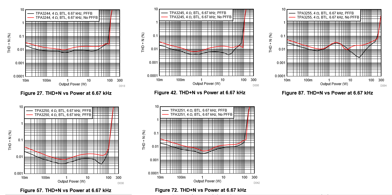

Yes all tpa324x chips are a little superior to tpa3255, so probably tpa3255 sounds close enough to those superior chips.
Why? Are you refering to the datasheets THD plot on the first side? These are measured on the EVM. So if they show somewhat better performance, this is due to a better/different EVM layout and/or a different test setup.
All the Akita Chips (325x/324x) are made from the same silicon design but distinguish in their output FET geometry size due to different maximum voltage levels. That's why the 3255 is having about 85mR RDSon while the i.E. 3245 features 65mR.
Worst case (aes17) as Icepower calls it.

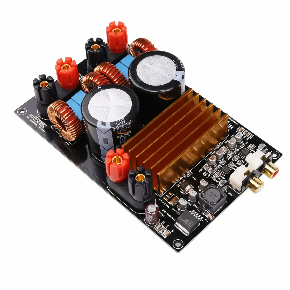

I have one of those tpa3255 boards from Aiexpress (see pic), the sound is very good, but there are problems: the LEDs are always on, and there is a very loud pop sound at connecting and disconnecting the power.
What exactly can I do to fix the pop?
I have seen the png fix from doctormord, but I'm not an electro pro, I don't understand exactly what I must do.
What voltage does your supply provide?
You may use the SHUTDOWN function of the amp to mute while power-up/down.

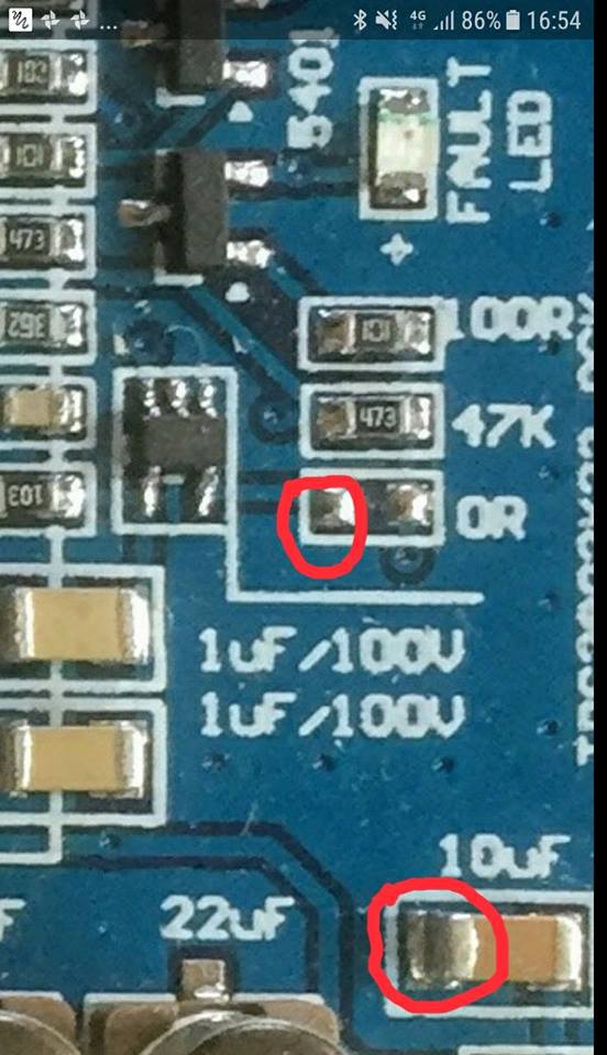

I once made a fix for the blue PCB version like shown in the picture.
attachment.php
It's located on the right side next to the heatsink. If yours look different, send a picture of that region.
Wire a switch between these two points for manual muting the amp.
Thanks!!
My board is black but those components look the same.
I should connect them one moment with a wire and that will put the board in reset state, so I can connect and disconnect without pop?
Or do I keep those points temporally connected while connecting and disconnecting the PS?
My PS is 24V
