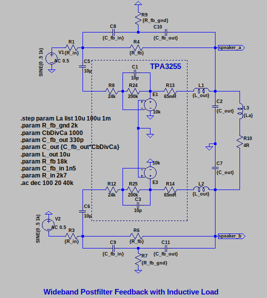

Updated sim file according to TI references.
All relevant values are in the param list

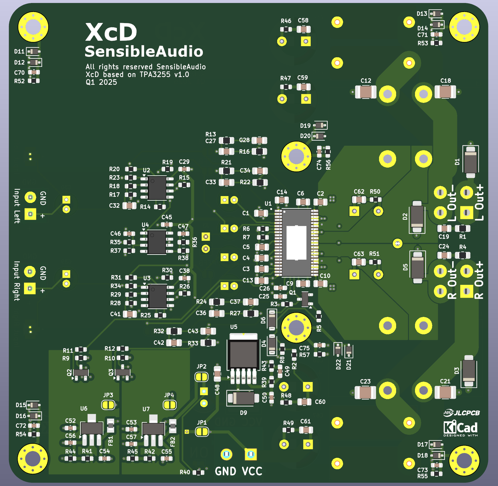

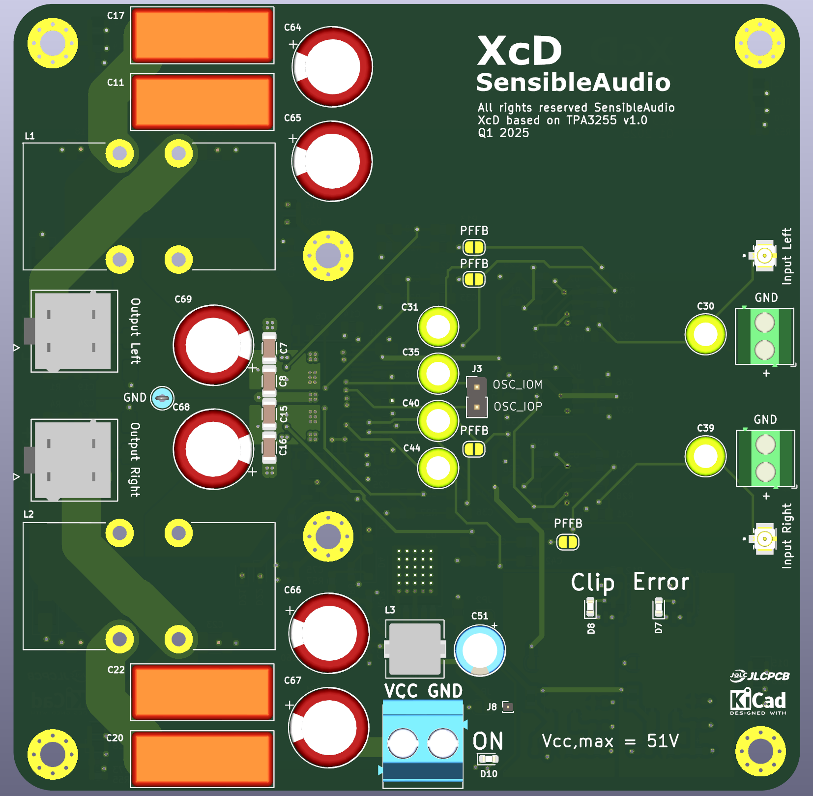

Think I'm close to sending to JLCPCB for my first TPA3255 prototypes (10x10cm 4 layer) 😉
Let's see it it works. Seems to be room enough to implement a ADAU1701 and hopefully a PCM1808 ADC . The 3 opamps on the board can probably be ommited, they form the SE to BAL and Vdd/2 circuit. ADAU1701 can deliver fully balanced output.
But one thing at a time 😉
View attachment 1402815 View attachment 1402816
If you're planning on using Faston tabs for output, how about spreading the L & R outputs apart a bit more and adding a central mounting hole to reduce PCB flex?

4 layer with 1 or 2oz copper for the outside layers? If only 1oz be mindful about max currents.

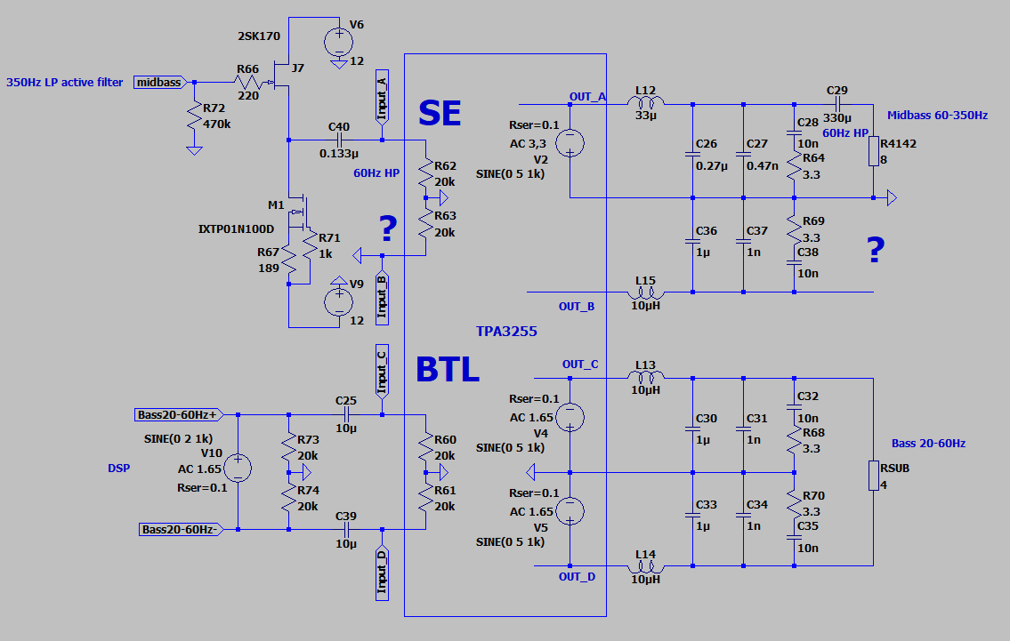

Will use one TPA3255 per side in my quad-amped system for the lower registers w/o using any input opamps. B_input and B-output should be permanently deactivated. B_input can be grounded either with cap or not. About the output it would be conveniant if the filter components could be dumped altogether, but I suspect they need to be kept togheter with a resistor termination after an output cap. If keeping the filter is a must, how small could the output cap be and how large the terminating resistor?
