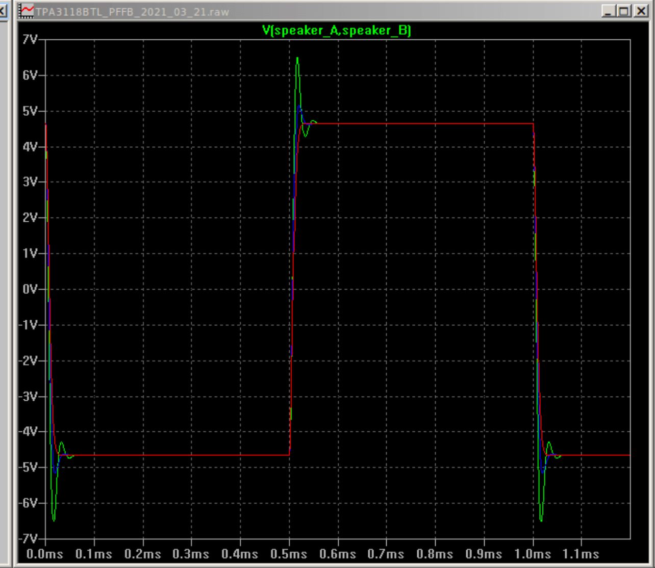

There’s a slick 50pF or 100pF post filter feedback developed by Bucksbunny that was shown to be even better than conventional PFFB. Basically, take output at speaker out and connect to input pin at chip via a 100pF NP0/C0G cap. It gets rid of overshoot and ringing.

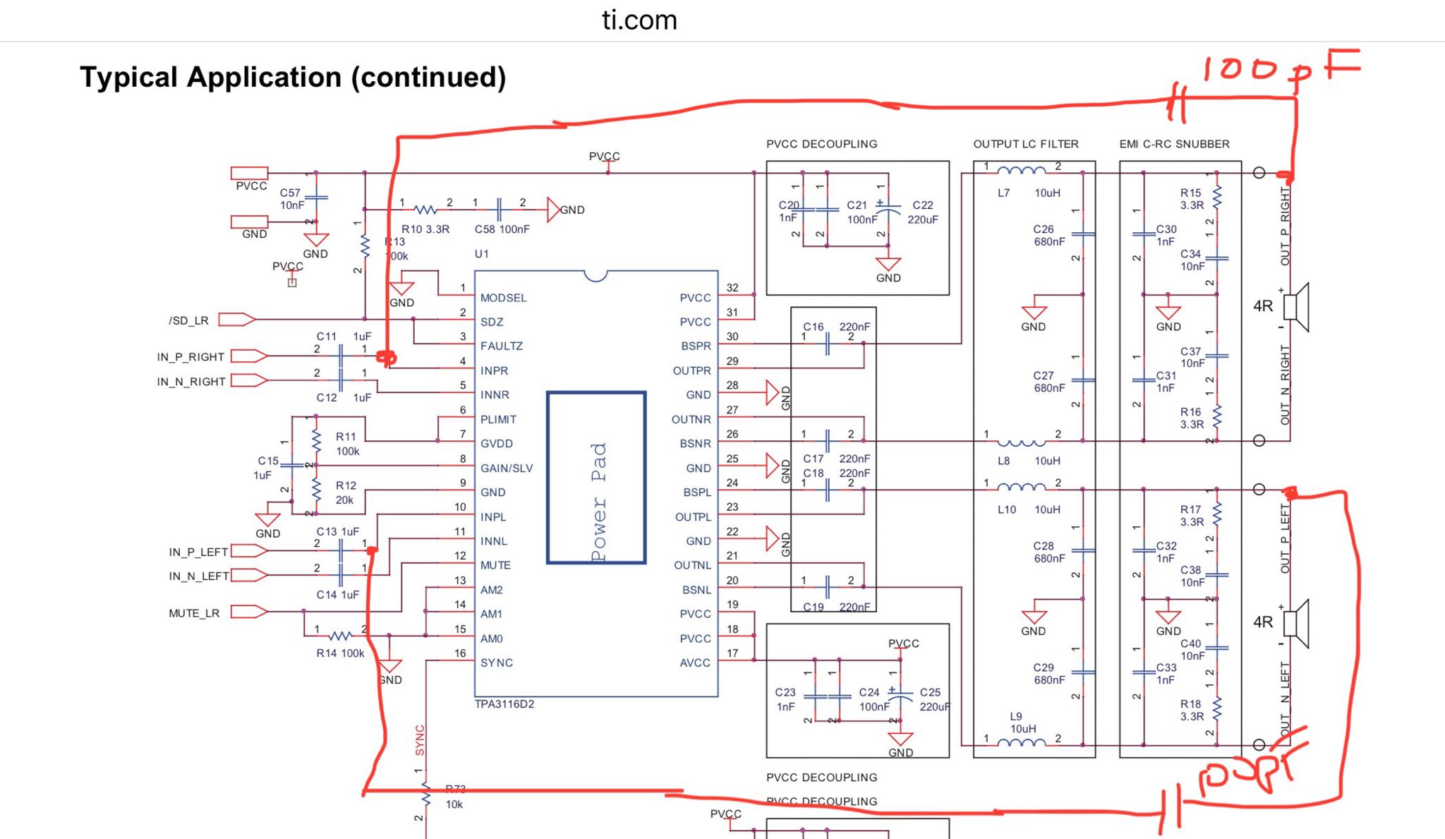

Can you please show (draw ) how this is done in schematics ?
Reactions: xschop
We should get confirmation from @bucks bunny , but from what I could gather, it looks like this based on simulations he made on a TPA311x.
I would connect the output of the amp with 100pF NP0/C0G (rated for 100v at least) to the input + pins like this:
Indeed this is the way I do it since.
Do not forget to add some series resistor 1k0 ~ 2k2 to each input and
drive with a low z op-amp output.
With open input, this circuit will oscillate wildly and auto-shutdown immediately.
Exact values can be found by experiment.

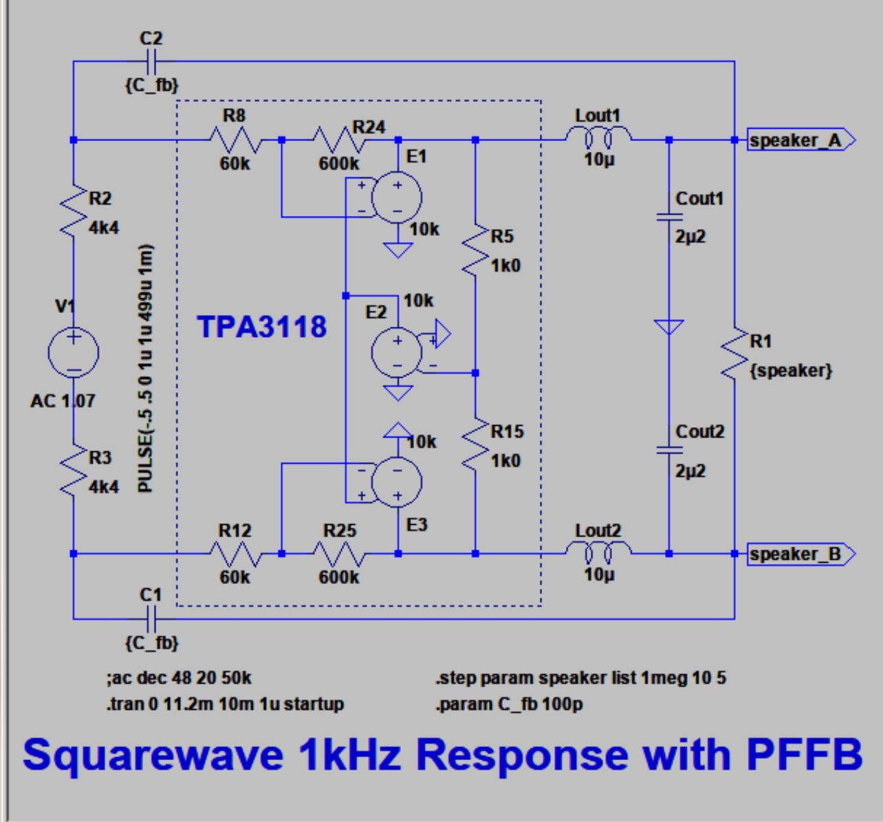

Assuming there is always some inductance in series with the speaker load
I recommend looking for best square wave response without load.
And there is NO BOUCHEROT required until somebody proves the contrary.

How is it an antenna? No worse than a speaker cable as it is after the filter. Also, properly implemented would be a trace on a ground plane short as possible from output to input. Similar to usual PFFB traces.

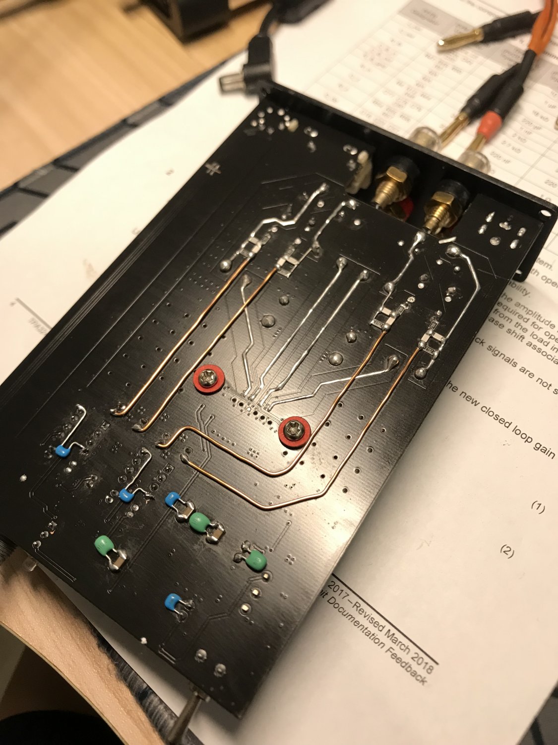

Probably the easiest way to implement this as a mod would be to use a very fine wire like wire wrap wire and connect from output to the through hole 10uF cap on the amp side via an SMT NP0 cap soldered to the pin on one end. Lay the wire flat to the ground plane of the board and tape with Kapton so it is flush with board. This reduces mechanical strain on solder connection as well.
i got pic someone mod his Aiyima 07 to PFFB with successfully like this....
