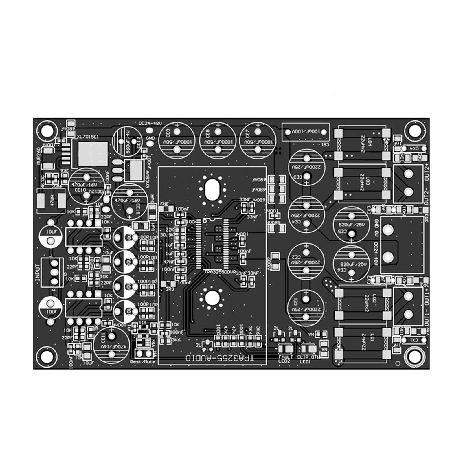

Hello all, I am thinking of building my own setup and using a TPA3255 2x160W 4 Ohm from Audiophonics, However I am completely stumped on what type of power supply to use. If anyone has any recommendations I would be eternally grateful, its driving me loopy. Thanks.
I like the 36V version of the Connex SMPS300RS -
https://connexelectronic.com/product/smps300rs/
Or you could save a few pennies with the 36V 500W version of this -
https://www.aliexpress.com/item/4000523247624.html
The Connex is also available from Audiophonics, for a higher price, but shipping is possibly cheaper, and you get European sales backup -
https://www.audiophonics.fr/en/smps...00rs-power-supply-module-300w-80v-p-9996.html
This is the Connex at 36V on audiophonics:
https://www.audiophonics.fr/en/smps...hing-power-supply-module-300w-36v-p-6311.html

Yes, I have modified some of these boardsHi. Maybe anyone here can help me modify this board from stereo to mono?
Thank you in advance.
