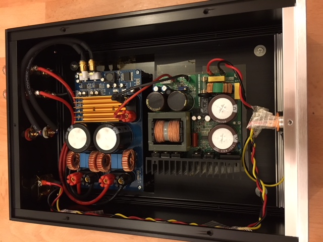

I have the blue douk board and a connex SMPS600RS and a terrible Pop on power up also on power down.

selecting a power supply (SMPS) for tpa3255; also, on/off noises
Guidelines I follow for power supplies:
1. Voltage is far more important than amperage or total watts output power. Choose a PSU with a minimum of 48V. Recommend a minimum of 2A, or ~100W to allow for dynamic headroom. Also recommend an adjustable PSU so you can increase voltage beyond 48V.
2. Choose wattage based on the speakers driven and typical listening level. With lower-efficiency speakers (<90dB) or subwoofers or low-resistance speakers, you could use up to 750W psu to drive the board up to its full rated power of 315Wpc (@10%THD!). But it makes no sense to run this chip beyond 260Wpc because of the THD. So 500W is more practical than 750W. There are many considerations and a lot of flexibility in choosing wattage.
3. I hate fans because they are noisy and leech power, but PSUs over 200W usually need one. Even if you buy a PSU without a fan, you probably need one in the case. A PSU runs more efficiently when it is not hot. Running hot stresses all the components and makes the PSU less efficient than it is designed to be. Many PSUs adjust the fan speed based on load, but many do not. If you get a PSU that has a loud fan or a fan that runs 100% all the time, you can replace the fan with a quieter model.
4. If you leave your amp turned on most of the time, consider idle power usage. For example, tpa3255evm with my 48V/100W PSU @ 53V consumes 8.2W. With my 48V/500W PSU @ 50V consumes 17.5W.
5. I prefer PSUs with efficiency spec of 85% or higher, the higher the better! Beware lower efficiency PSUs in the 75% range...they will generate more heat and require more cooling (i.e., fan). Also, please choose a PSU that has PFC (power factor correction). A PSU with PFC uses the AC waveform from the electrical grid more efficiently.
6. tpa3255evm has negligible turn-on noises unless you switch power too quickly. So it is usually not a problem. But to prevent turn-on noises, use a delay relay to startup with RESET enabled, then switch to NORMAL after a few seconds.
7. tpa3255evm has turn-off noises with every SMPS I have tried. The easiest and least complex way to prevent turn-off noises is to use a 3-pole switch for on/off, and switch V+, AC hot, and AC neutral together.
8. If you turn on PSU first, then turn on tpa3255evm with a separate switch, the tpa3255evm won't start up with some PSUs because it trips the overcurrent protection. There are several ways of dealing with this, but the easiest is to buy a PSU that has an active inrush current limiting circuit.
9. Ripple on most SMPSes is negligible, <250mV. From 48V, 250mV is 0.005% and 100mV is 0.002%. Also, there is good PSRR on tpa3255evm.
10. Finally, be sure to check the grounding scheme for the PSU. At 48V, earth-grounding is preferable to floating/isolated ground.
11. Linear? Given an SMPS with the correct voltage and sufficient amperage, any reason to use an LPS with a switching amplifier? Not for me, considering an LPS is perhaps 60% efficient it wastes a lot of power.
12. Switching frequency: I haven't measured this, but my theory is that higher switching frequency is preferred, in order to push any switching noises further outside the audio spectrum. 100KHz switching is great, 40KHz less great.
Mean Well PSUs are good quality, reasonably priced, and there is a large selection to choose from that meet my guidelines and work well with tpa3255evm. Here are some to read more about:

I don't think delaying power to the amp will help...and it might cause your smps to trip overcurrent protection. To eliminate power-down click, switch the V+ wire on/off along with the AC wires to the smps. This cuts the power line between smps and amp, so the the amp does not get a turn-off pop from the smps.
