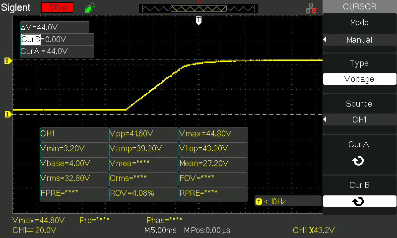

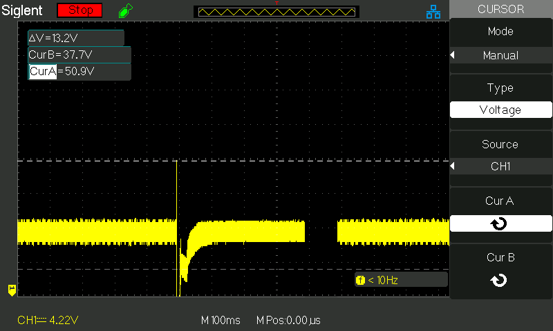

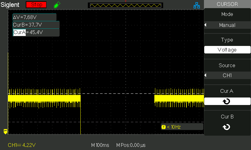

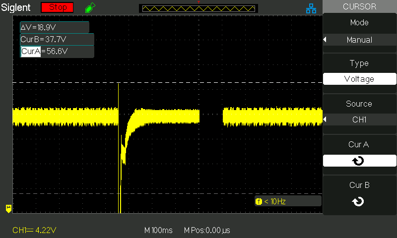

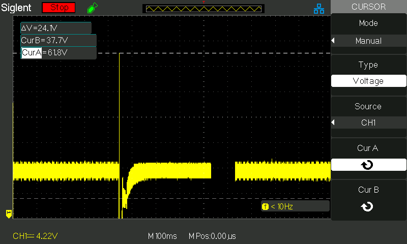

Finally captured the startup voltage spike...but not on the PSU that crashes. I'm still somewhat new to using a digital scope and I haven't yet been able to to capture the voltage spike on the RPS-400. so I used a different PSU, the mean well USP-500-48. This PSU does not crash but it does show the voltage spike. This is measured at the PSU. The biggest spike was one up to 65V, but that was not typical. I also tried different voltage adjustments on the PSU. The last attachment is the PSU that crashes.
I can't see any pattern here, other than the fact that there is invariably a surge on startup. And that is to be expected in some degree with any electronic device. I will have a current clamp for the scope later this week so I can measure the current surge as well.
thanks for the plots. It would be better if you do measure as follows:
1. use 10:1 setting on probes
2. calibrate probes with 1kHz supplied by scope
3. set scope to 10:1 to have correct voltage labels
4. set to DC coupling
5. single shot trigger
6. capture the whole startup transient
From your plots, there's a lot of noise going on and it is unclear what scaling you use for X and Y.

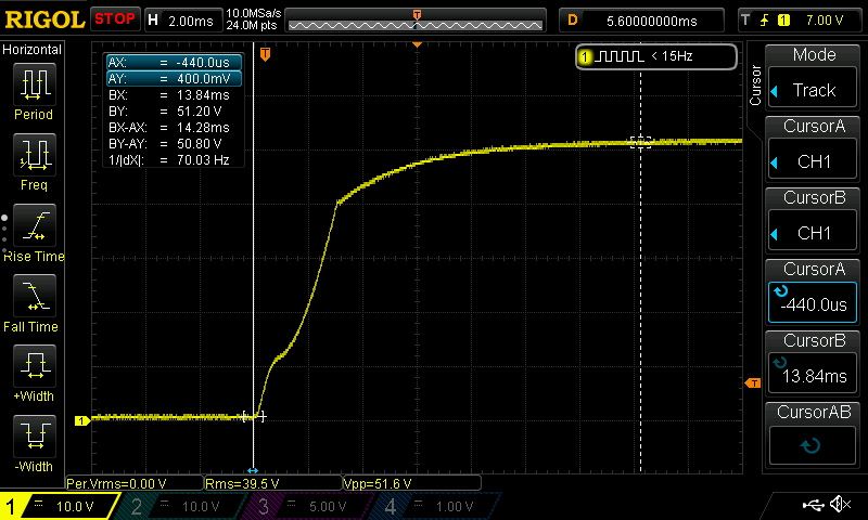

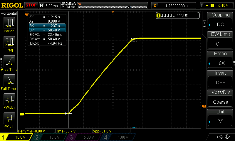

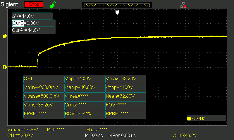

I captured the startup of the LRS-350-48 set to ~51V:
Transient into connected TPA3255 with 2x2400uF:
Transient into no load:
No overshoot whatsoever.

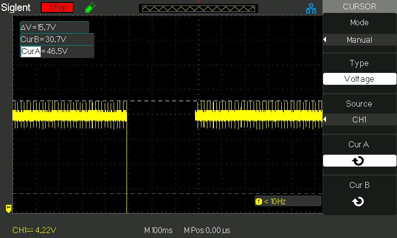

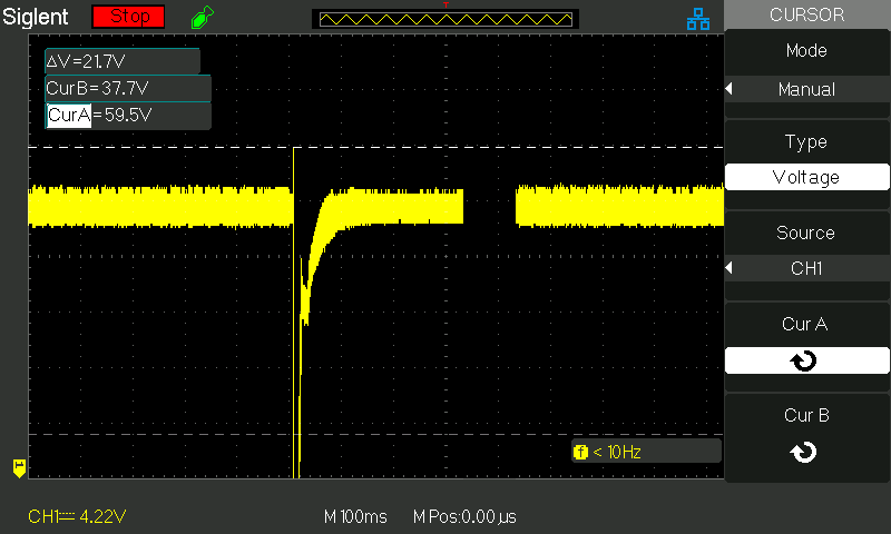

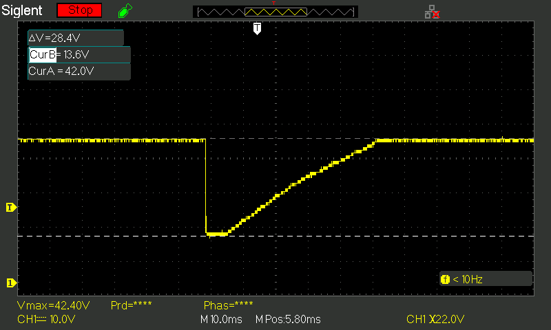

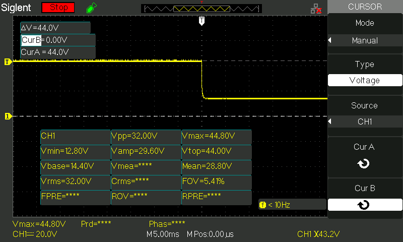

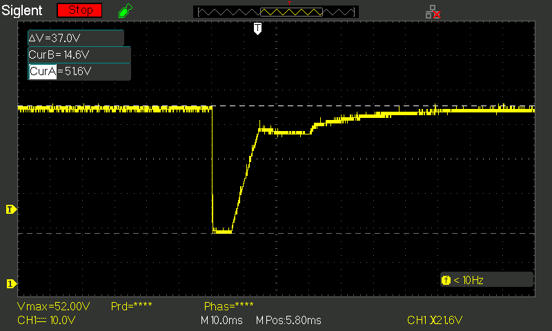

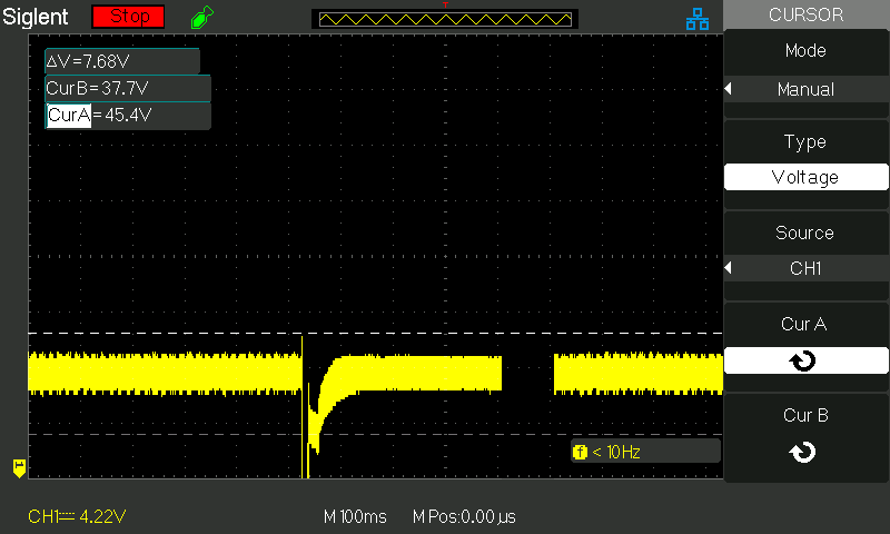

Thanks very much for the tips. I wasn't using trigger in the previous shots. Here are some new ones. I think I am still doing something wrong because in these I only see voltage sag, not a spike. Voltage sag is around 30V.
rps-400-48 no-load startup:
rps-400-48 amp turned on:
usp-500-48 no-load startup:
usp-500-48 amp turned on:
hrp-100-48 amp turned on:
To much capacitance would say. (2x4700uF) What about starting the supply with amp already connected? That should work much better. (With reset held low)

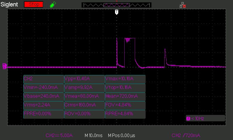

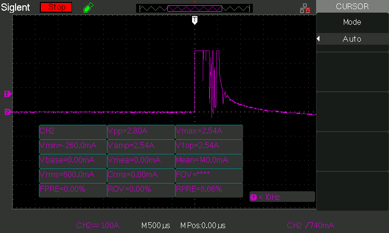

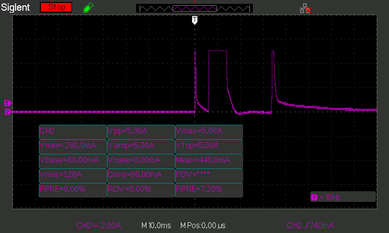

Here are the shots for the start-up current draw...first one is the PSU that crashes, the next 2 are a PSU that works.
The only issue is that the RPS-400-48 can't handle the startup load for the tpa3255 board. Per the spec, it can output up to 8.4A, but it shuts down at 2.54A if drawn too fast. The USP-500-48, with amperage adjusted to maximum, allows all of its rated 10.5A and doesn't crash.

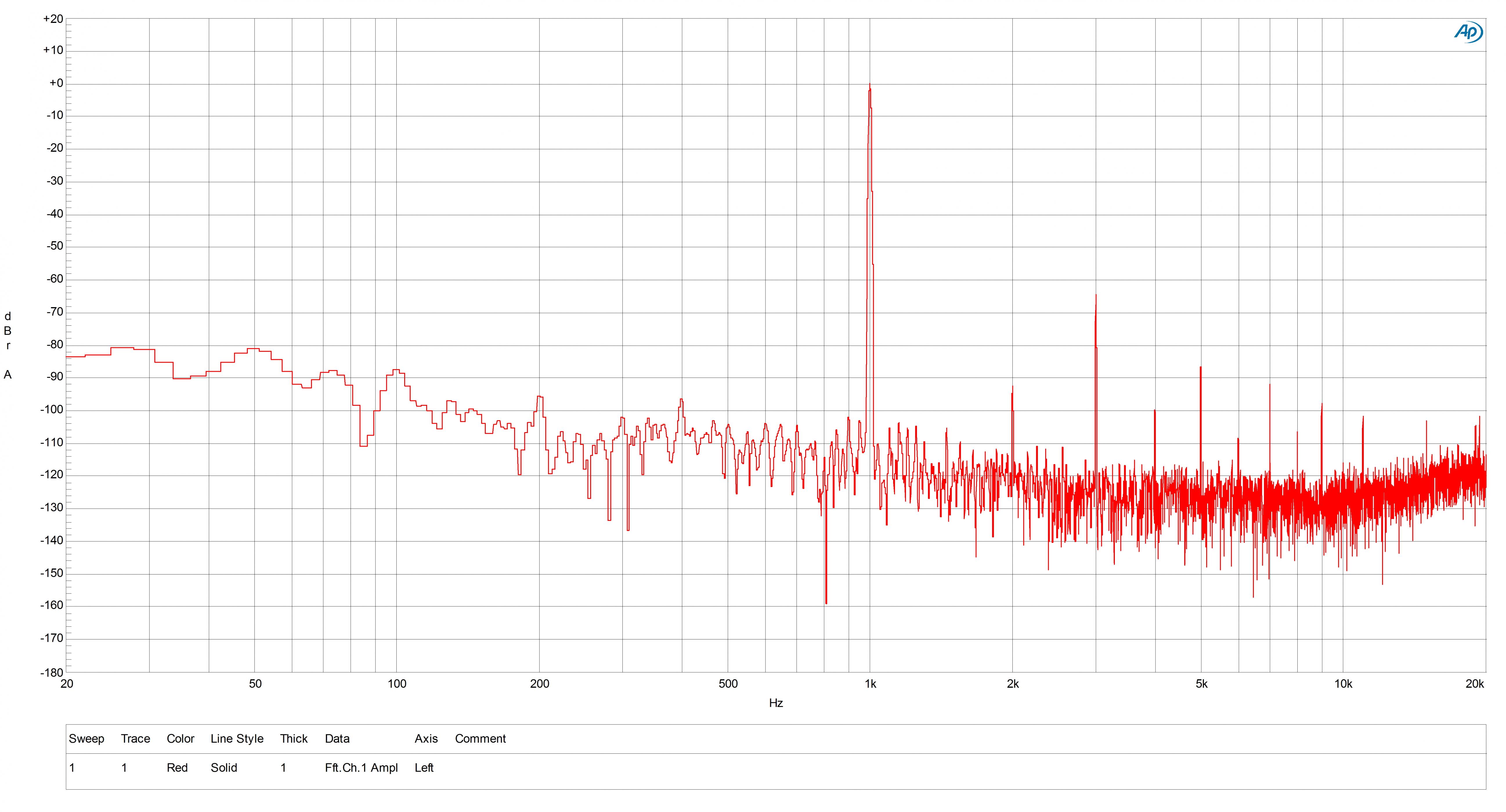

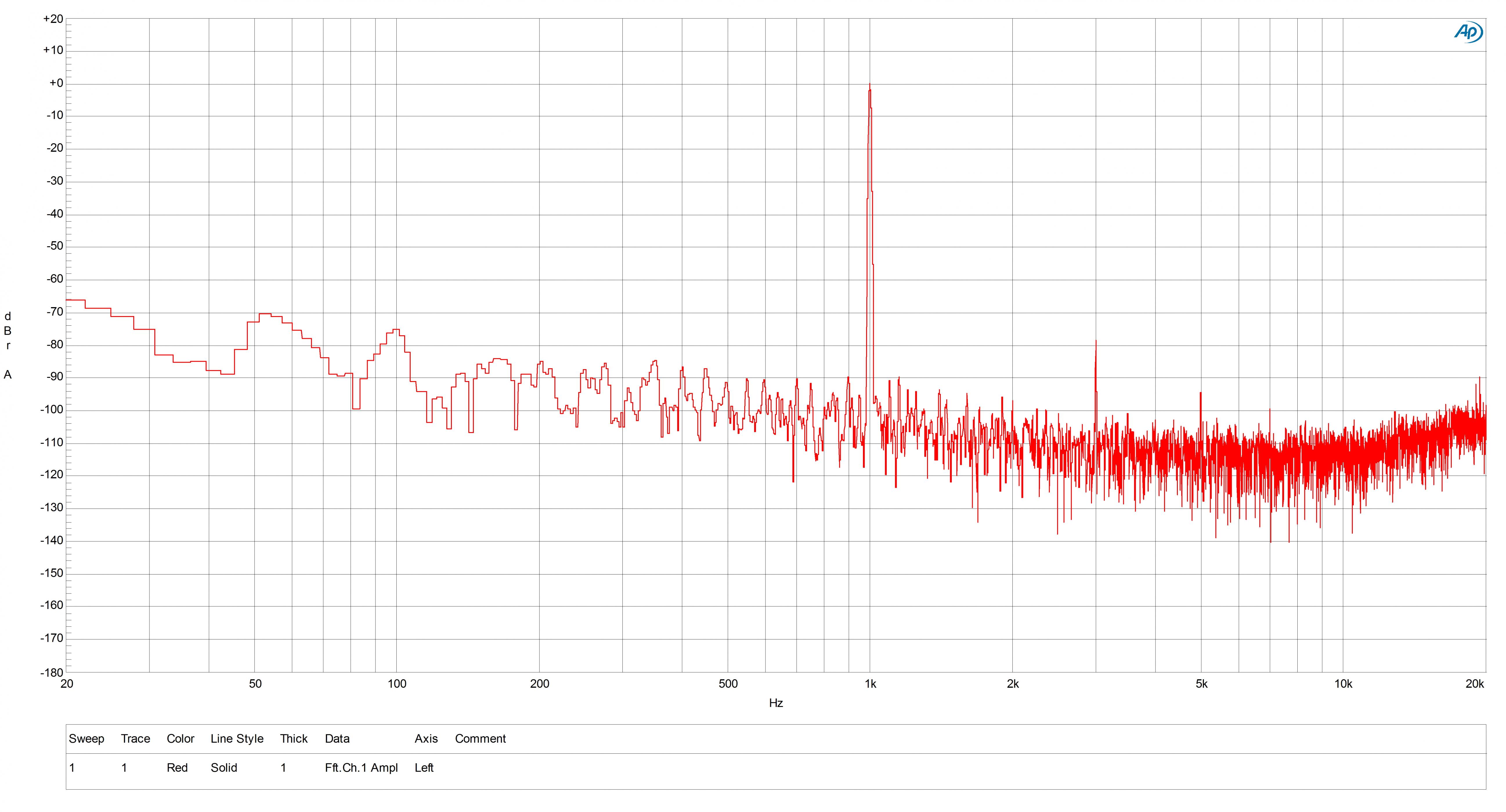

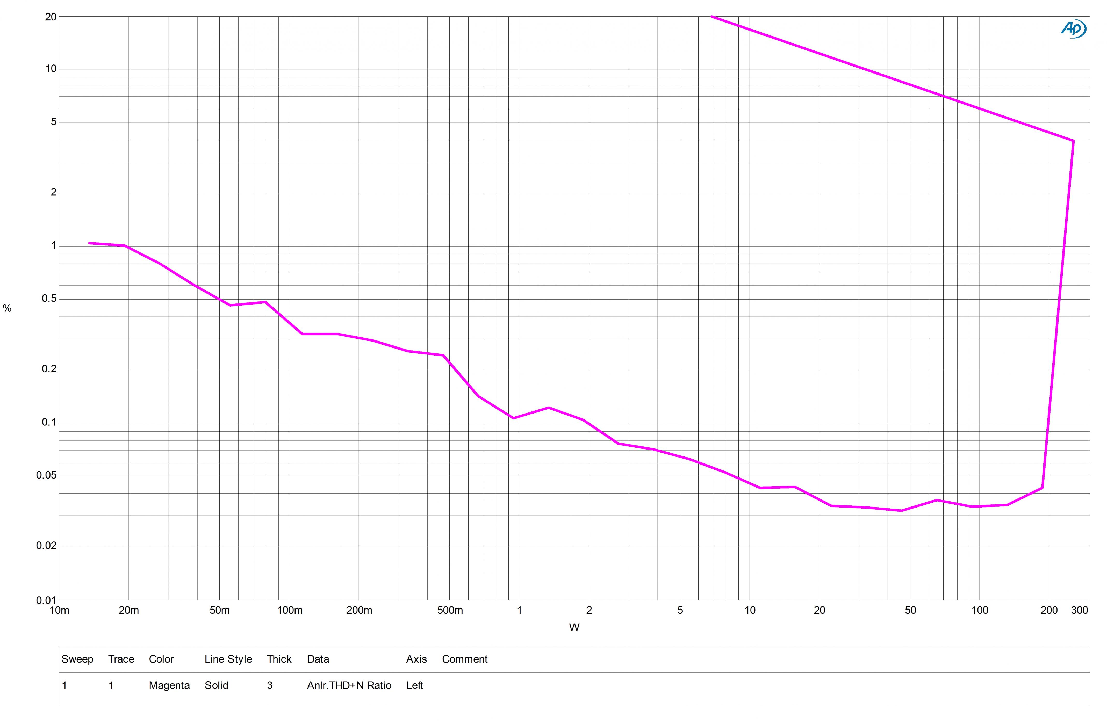

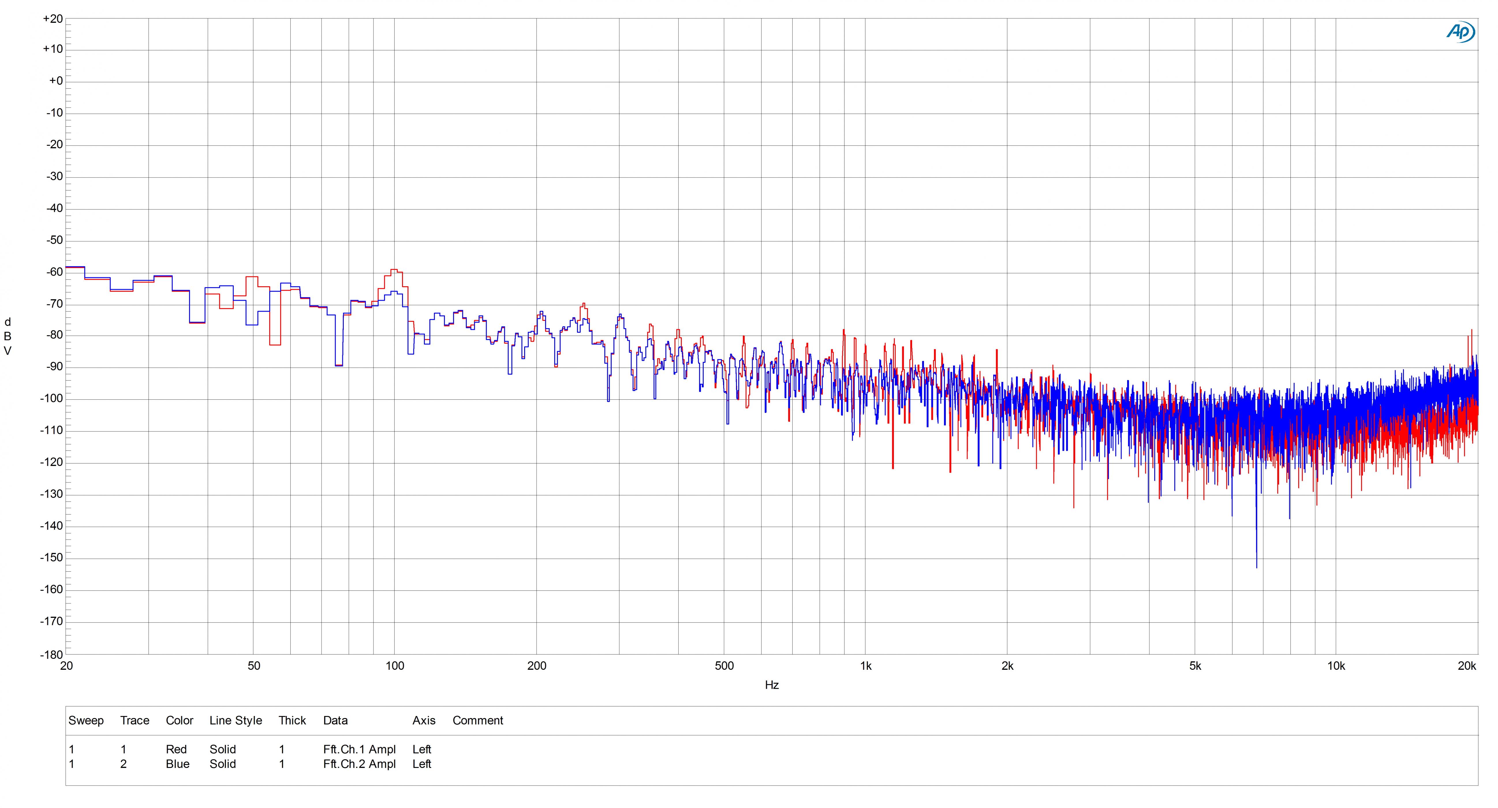

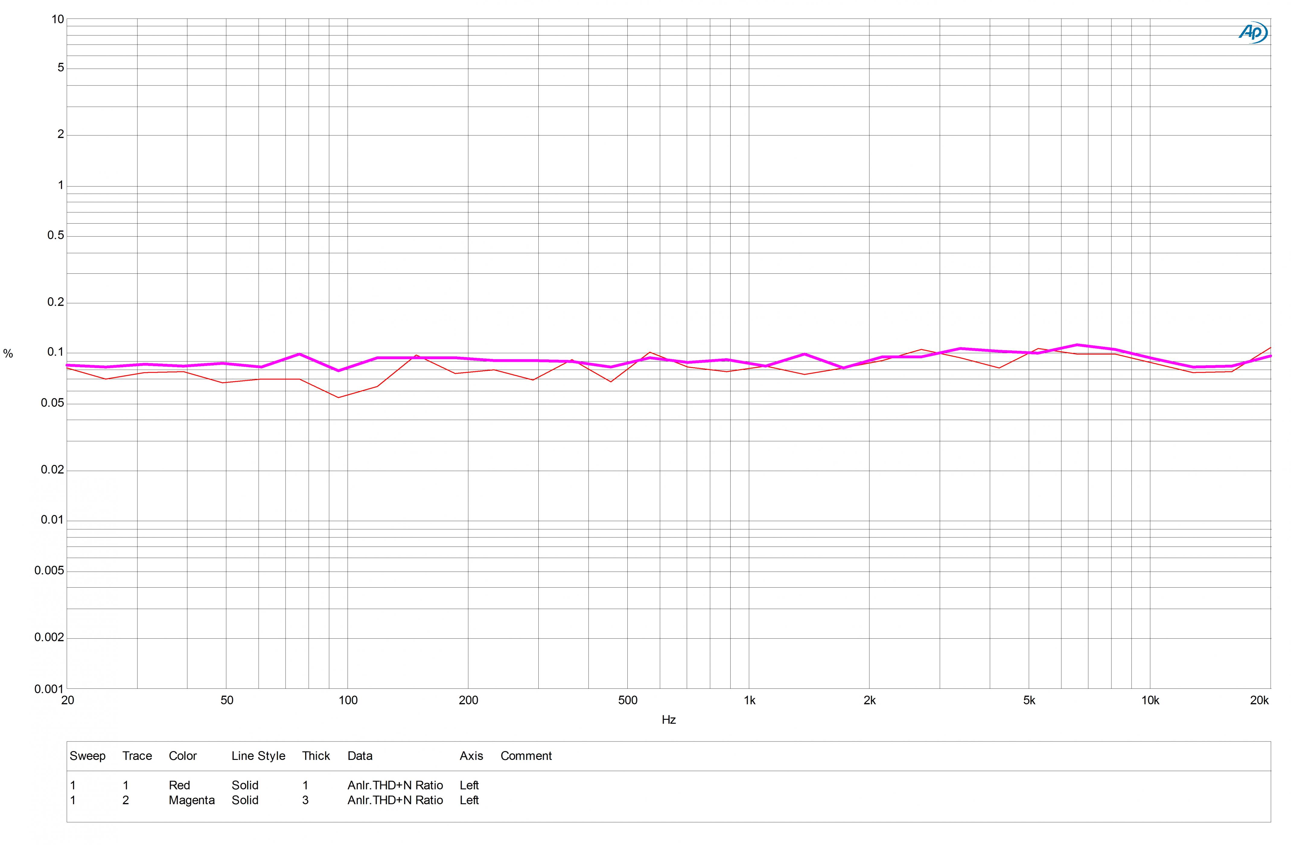

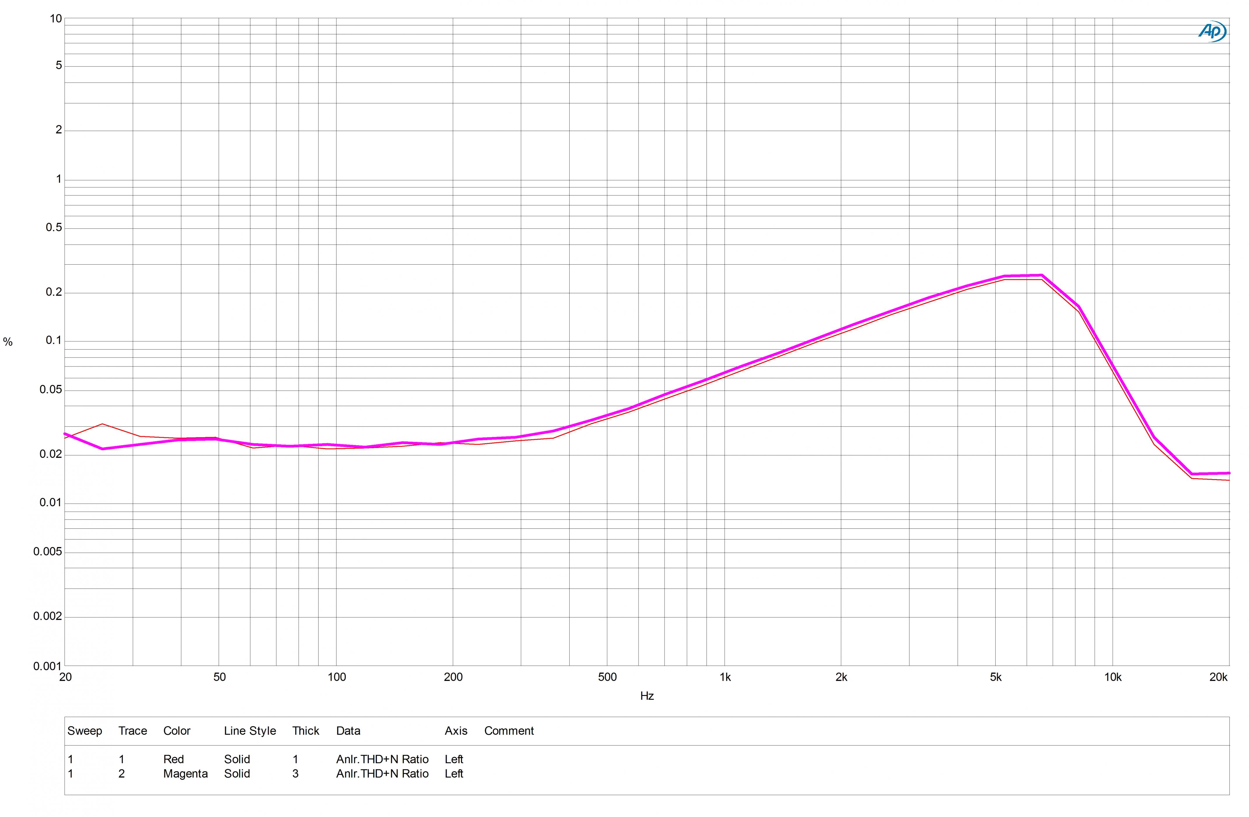

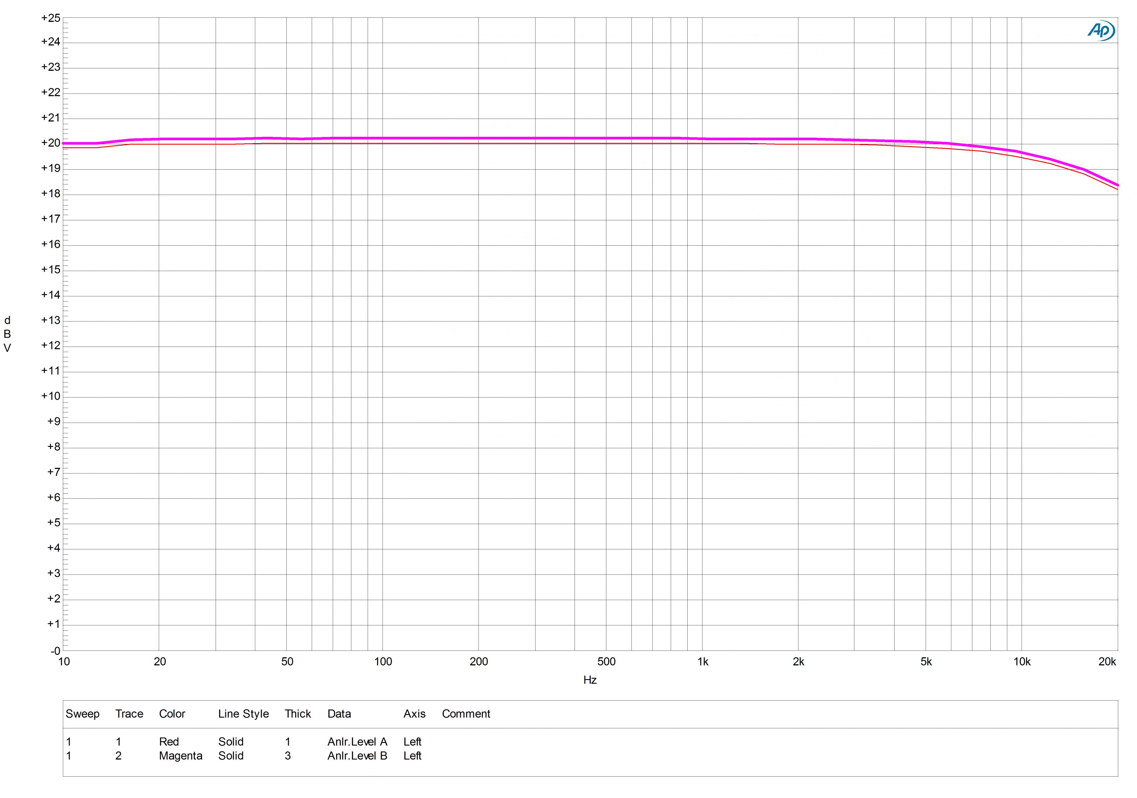

YJ-TPA3255 Board Test
just attach some test data here,with 4ohm load/48V SMPS
from the test it seems this board hasn't achieve the specification according to ti datasheet.
my board is very easy shutdown at high ouput even i re-add silica gel between TPA3255 and heat-sink again,but it didn't help.
so that will show at the THD+N plot, when output > around 250W,it drop due to the board shutdown.
