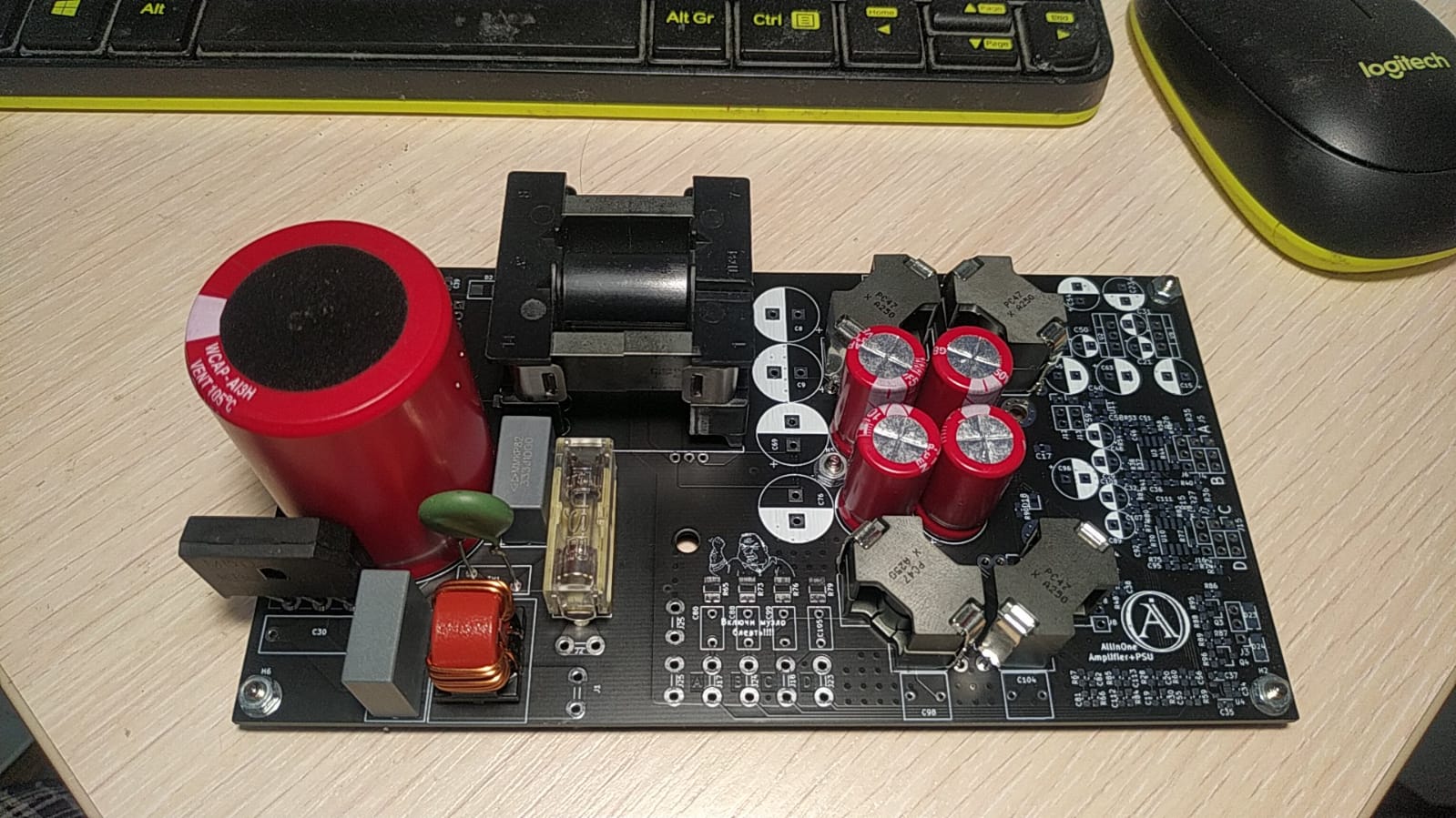

Huge overkill im sure but don't we like building things on here?!
Hahaha, you are correct..I found that adding bigger caps on the Linear PS really didn’t buy me much. The amp always had enough horsepower just as long as you gave it enough voltage in (depending on your speaker sensitivity of course). My issue with the old version was it was not very open & spacious sounding and I couldn’t make it much better than stock. Luckily (or maybe not) I tried instituting PFFB on it to see how it would sound. It worked for awhile but something happened and it just stopped playing and I couldn’t reset the error light so I gave up on it and bought the new version.

So initially I'm going to use 20,000uF on the Linear PSU.
After I have heard the system a lot with this capacitance, I will do the test with 10,000uF and see if I feel any changes.

How many uFs are you using on the PSUs?
I do not recommend using a transformer rectified power supply for a Class D amplifier.
Because the fluctuation of the power supply voltage with respect to the amplifier output is too large.
Class D amplifiers operate on the condition that the power supply voltage is stable.
If you use a transformer rectification power supply as the power supply, the voltage fluctuation will directly affect the sound quality.
If you absolutely want to use a transformer rectified power supply, combine a transformer with a power capacity several times the output of the amplifier and a large-capacity capacitor to minimize voltage fluctuations.
