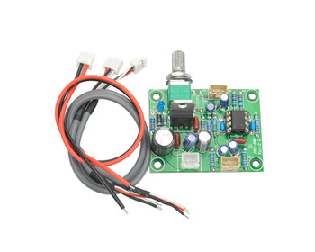

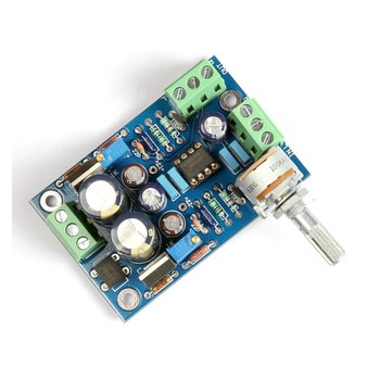

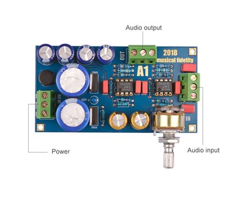

Hi am looking for some advice rearding 3e TPA3255 2 channel board.
Planning to build an amp for my desktop.
Will there be any advantages/cons ,if i use the one of below preamp boards?
are they suitable?
OR a simple pot before input will do?
My speaker specs are as below

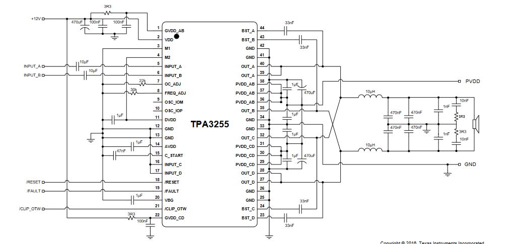

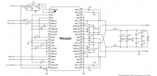

from bottom the left could be pbtl. you have two solder bridges for paralleling one output from each channel to the other. on the input you have to ground one channel and hope it will work^^
look at the schematic for PBTL
no other difference in input.

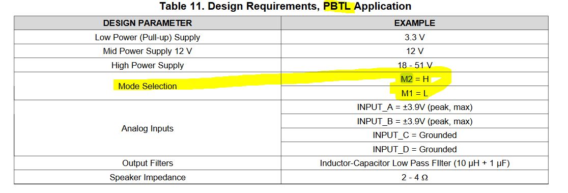

So I did a quick test, grounded the hot and cold of one of the balanced inputs, parallelled the + to + and - to - outputs, and then connected an input and a speaker. It didn't go into fault mode or anything, and I was able to turn it up fairly high.
The audio from the speaker was sorta distorted, though. I tried two different speakers with the same result. Any ideas as to how this could be? 🙂
It was distorting at a very low volume, as well. It wasn't wrong polarity of the speaker.
Thanks in advance!
EDIT: I took another look at the schematics, and it seems I need to activate pin M2 on the chip for it to act in PBTL mode. That's not something that's easy to do on a finished board, is it?

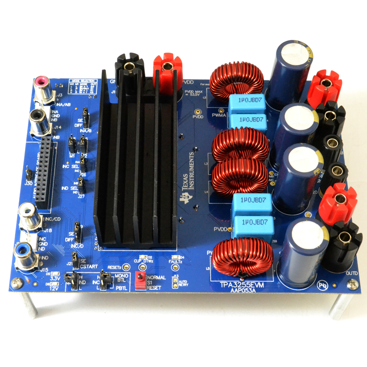

In my build I have my DAC and 3e TPA3255 board and speaker binding posts all isolated from the chassis. Chassis is connected to mains earth of course.
Should I be connecting the signal ground to the chassis somewhere via a GLB or just leave it floating?
If connecting to the chassis, where in the circuit should I take the signal ground from? Is there any problem with connecting the two amp neg outputs together and then to earth via a GLB? Or should I do it on the amps input?
gilera, the 3e amp boards, like the TI EVM boards, have their AGND connected to the board's mounting holes.
So if you have mounted your amp board to the chassis with metal standoffs (as you should), and also connected your chassis to protective earth (as you should) then you have already earthed your AGND. You can easily confirm with a multimeter. Not all amplifiers take this approach, but this is clearly how the TI engineers intended things to be done for the TPA325x.
Of course I'm talking about the input.
Ouch. I would never do this!
No I used nylon standoffs. I always thought that it was good practice not to connect the signal ground to the earth unless separated by a 10ohm or so resistor and a 100nf cap. Is this not necessary? From what you have said, if I wanted to do it this way then I could connect the input agnds together and then to the chassis via resistor and cap.

Thanks everyone. I guess the outstanding question is - do most people just let the signal ground be connected to chassis and earth via mounting hole, or semi isolate it. I guess the manufacturer seems to endorse direct connection if the signal ground is connected to the mounting holes.
That's just one approach, and as the name implies - Ground Loop Break - allows signal GND to reference earth potential - without allowing (much) current to flow to earth.
But another approach is to fully earth your AGND at the amplifier - then ensure all other devices in your signal chain have floating GND. In a professional environment where you are connecting multiple components not necessarily owned or managed by one person, this is impractical. But in a controlled home environment, this is perfectly manageable. And in the case of the TPA325x this is clearly TI's preference. When you buy a TI TPA3255EVM board, it's provided with metal standoffs already attached. Refer attached photo.
