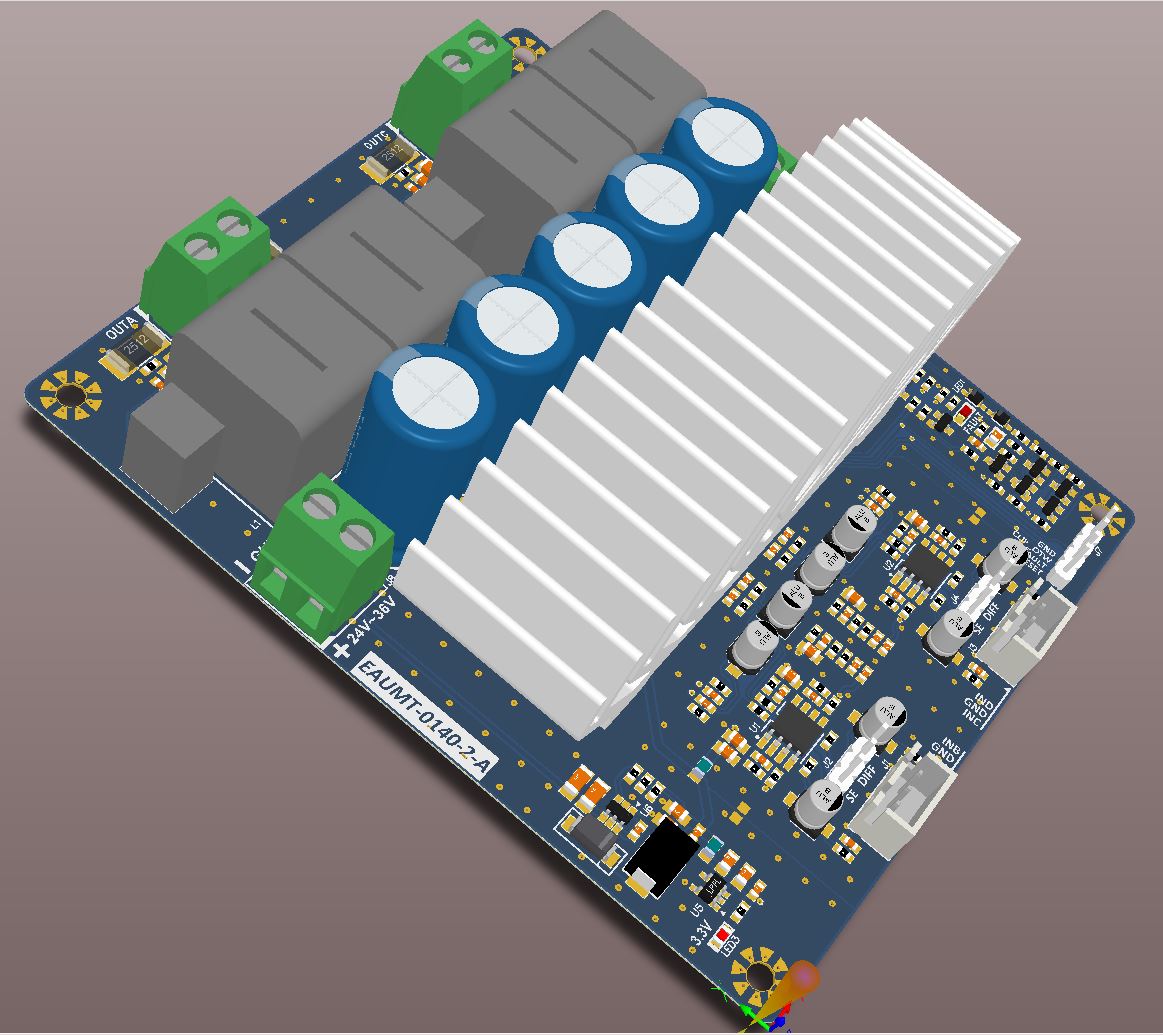

the 2nd version had been released now.
both of Power input and Speaker Output connectors were changed to SCREW type for easier assembly.

Looks like TPA3255 and TPA3250 amps will be offered soon as well at 3eaudio website!
Already there🙂 Looks nice
yea more stock now, all 3 boards available!! yay! i think ill get the tpa3250 and tpa3255 😀

If you could release boards with unbalanced inputs, it would be so much better, as a lot of us still dont use balanced inputs.
According to his website, the boards have a jumper selectable option of both balanced and single-ended input.
