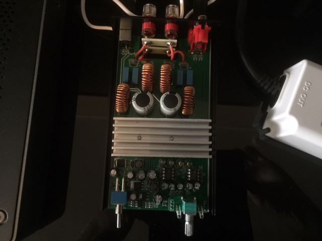

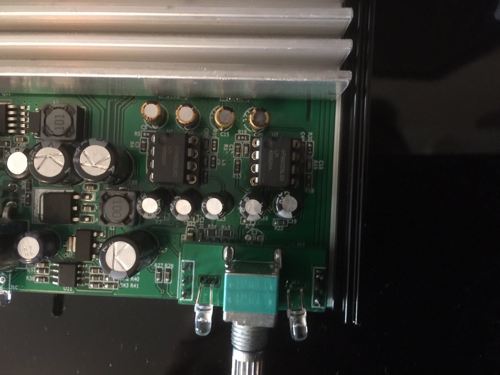

The HF can be a touch bright and grainy with the Aiyima A04 TPA3251 amp. I assume this is the amp you are referring to. By replacing the stock op amps with better ones, everything fell in place in terms of tonal balance and smoothness. I have not felt any need to replace the stock input caps since then.
I would also recommend using your choice of solder and touch up all the solder joints in the signal path including the input caps. I am not sure what solder the manufacturer used, but it doesn’t flow like a good Kester 44 or Cardas quad eutectic solder. I found the best thing was to suck the old solder off with a touch of solder flux paste and then apply new solder. It sounds a bit over the top, but this alone can make a significant difference in sound quality. It almost seems like Chinese manufactured audio electronics is chock full of sub-quality solder joints.
I use lm4562 and the sound is clearly better.

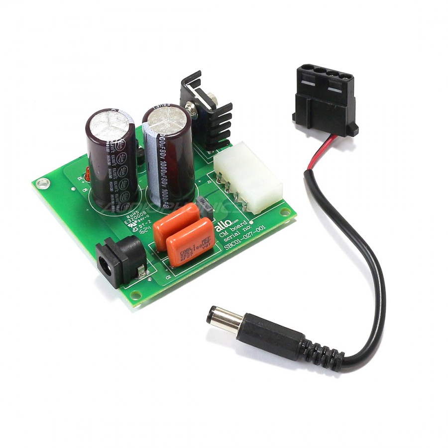

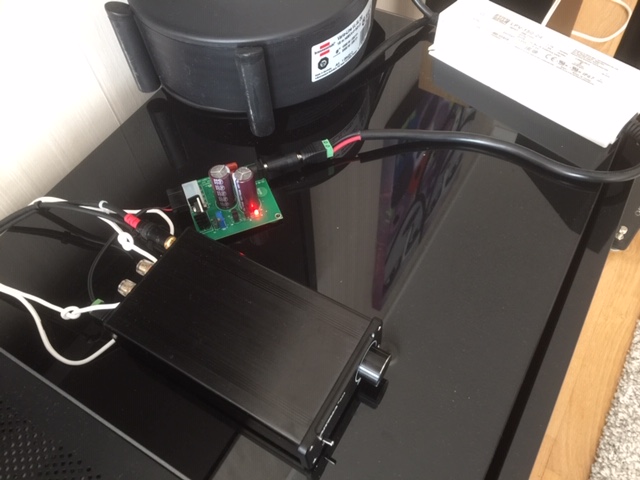

One other thing that makes Aiyima a04 sounding slightly better is the use of a capacitance multiplier between the mean well power supply and the amplifier.
The capacitor multiplier card, made by Allo, can be bought separately from audiophonics in europe or directly from Allo. The price is about 20 dollars.
I can clearly recommend it.

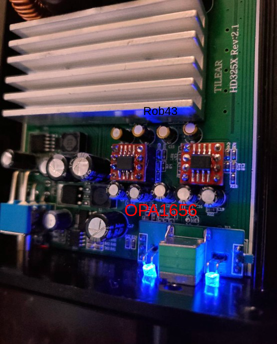

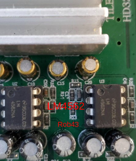

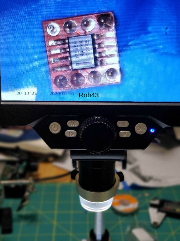

I own several different op amps that were bought from Mouser USA, including the LM4562 & OPA1656.
After roughly a ~100 hours of burn-in on both chips, the OPA1656 is the clear winner in all categories.
