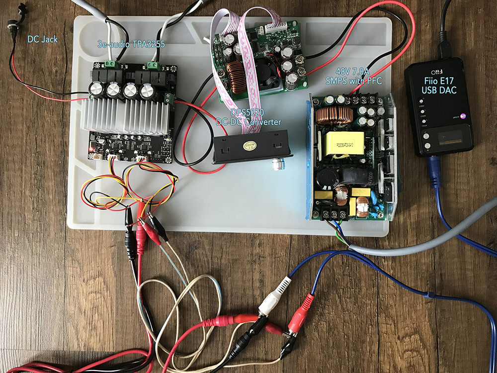

Hi everyone! After reading a lot about TPA3255 in this forum, finally I pulled the trigger. I just received the 3e-audio TPA3255 board 2 days ago. I was so eager to hook it up for testing despite I don't have all the necessary parts to assemble this amp yet.
Here's my initial setup for functional test.
attachment.php
Suppose I should connect the SMPS directly to the amp board, but I would like to experiment with different voltage settings. So I connect the RD DPS5020 DC-DC converter in between to adjust the voltage.
My temporary setup:
Raspberry Pi 2 (Volumio) > Fiio E17 USB DAC > 3e-audio TPA3255 amp > Pioneer SP-FS52 speaker.
Initial test was satisfying. At least everything is working and there's sound :). There's a slight hiss from the tweeter when I put my ear right next to it. Not noticeable when listening to music.

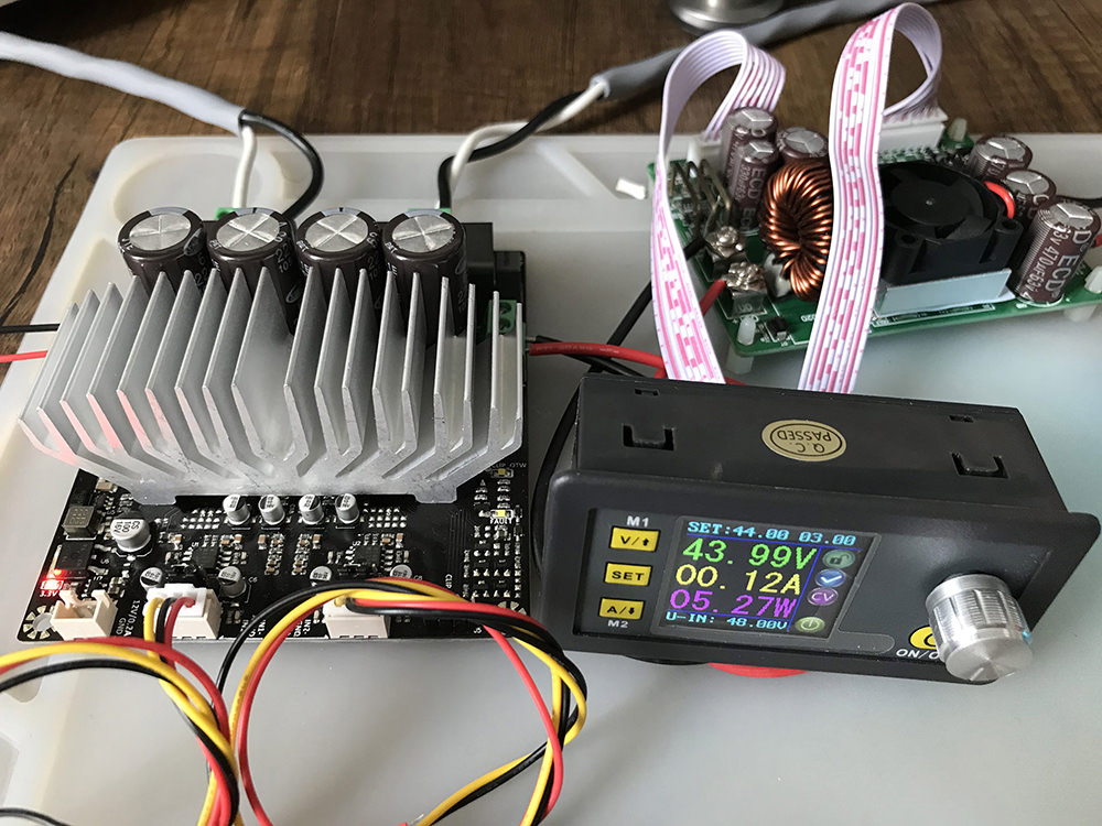

Here's my experiment:
PVDD: 44 VDC
Current consumption: 0.12A
Power: 5.3W
Heat sink temperature: 46°C
Coil temperature: 47°C
attachment.php

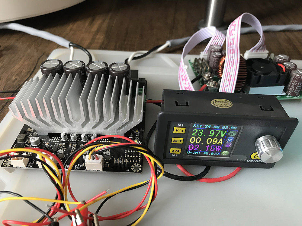

PVDD: 24 VDC
Current consumption: 0.09A
Power: 2.15W
Heat sink temperature: 36°C
Coil temperature: 36°C
attachment.php
Ambient temperature: 30°C
Why the amp is getting much hotter at 44V input even without any music playing? Is this normal or is there something wrong?

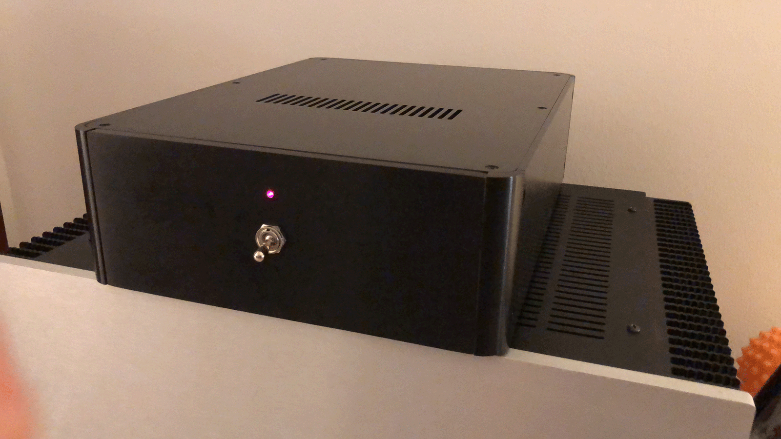

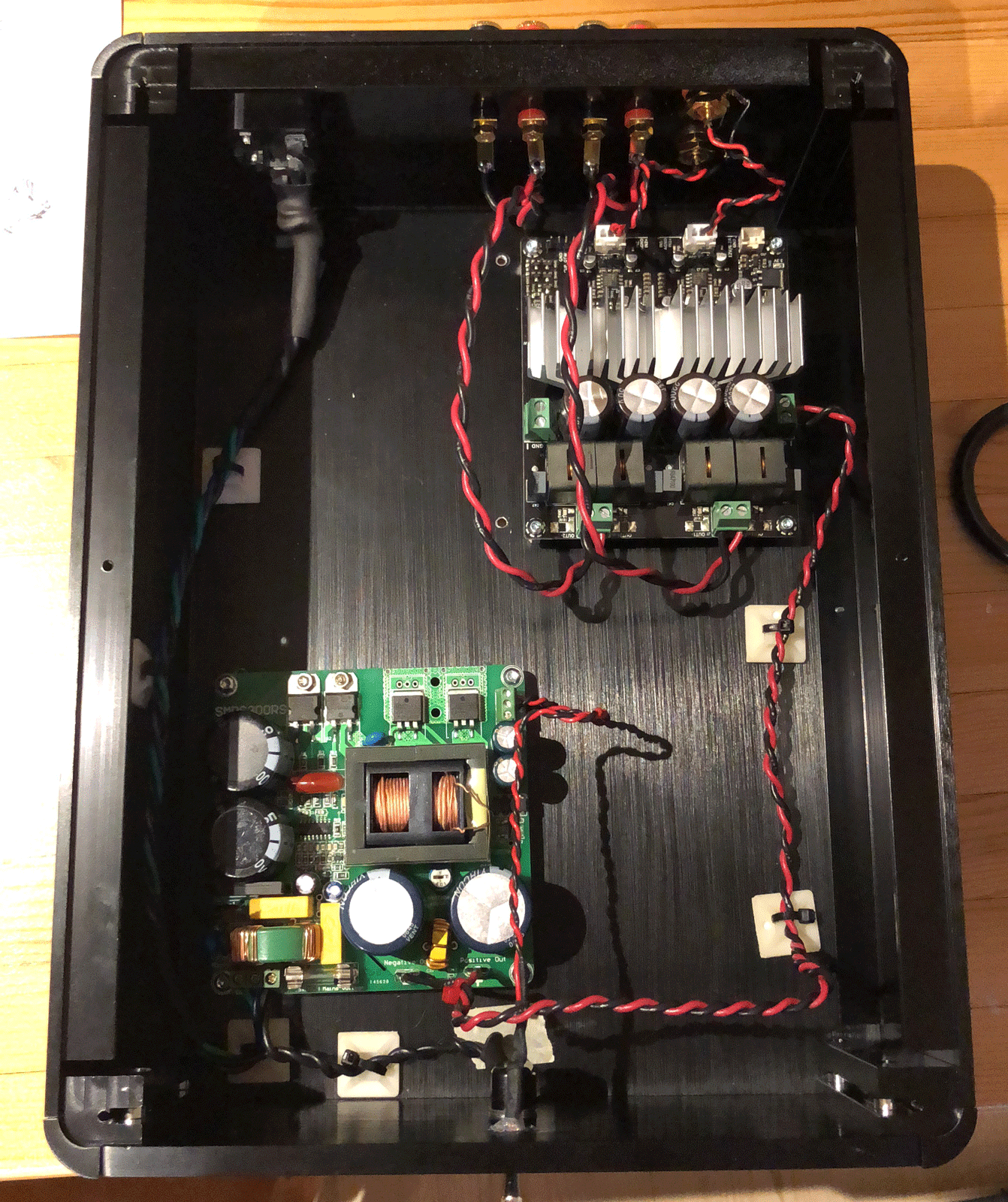

Another build using the 3e module. This was a build for my parents who are moving house and needed something fairly discrete and relatively cheap. These amp modules seemed to hit the spot perfectly. Sorry in advance for the crappy photos...
The plan is to pair it with a yamaha wxc-50, which will do source (spotify and airplay mostly) and preamp duty.Speakers will be a pair of my (currently unused) dynaudio excite x16s (rated to handle up to 150W).
Nothing fancy but i like it. Case and PSU (connext SMPS300R, 32V) from audiophonics. Red LED fed from aux line of the SMPS and a switch on the front.

I've only had a brief listen on the mentioned Dynaudios and my Alpair 10p bookshelf speakers, but my impression so far is very positive :)
Last picture is the amp on top of a DIY F6 in a 4U/300 modushop case for size comparison.
