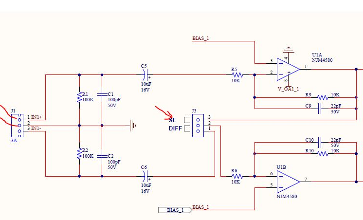

Not sure what the schematic is for this board but 100k during in front of an inverted buffer is a lot high and noisy. Need to check the feedback resistor as well.

Hi DPH
Attached is the schematic for the frontstage.
I would change the resistor to approx 15k to make my 100k lin pot into a "fake" log, but i am unsure if it is messing som other things up.
