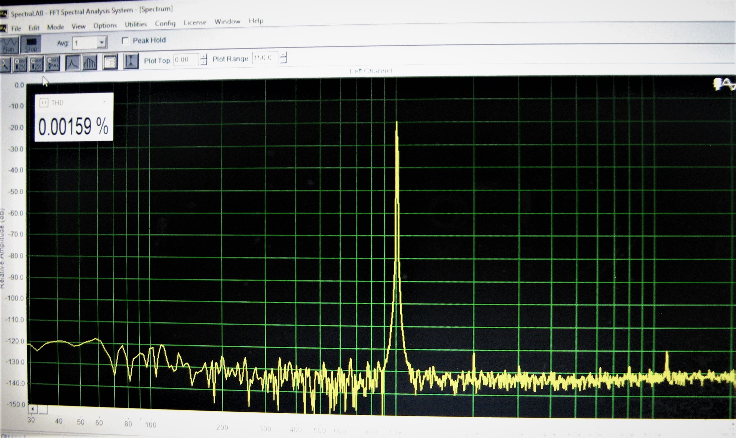

I have an FX 502s pro. Here is the distortion spectrum at 10 watts. Very good, great, but bad sound. I will look for the reason ...

This review and measurements do not match the parameters of my amplifier. I measured THD, frequency response, output power and got excellent performance, post 1108.
