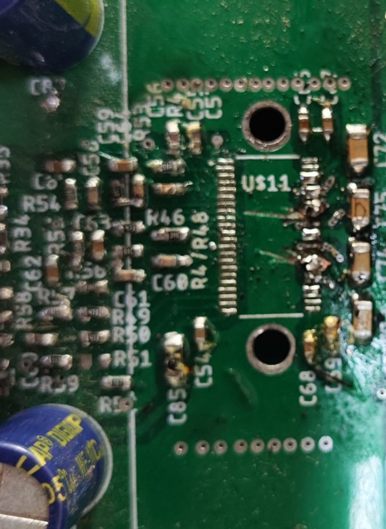

Looking carefully at your photo of assembled board with chip removed, I assumed because it blew up. I see that it appears to soldered this with a soldering iron? The joints are not clean and a lot of excess solder. I suspect a lot of your issues might be related to bridging or shorts on the output wires - you need to use solder paste and hot air or hot air/hot plate techniques. The solder joints need to look neat and clean around the pins on TPA32xx chip or it won’t be reliable.
This is closeup of your board:
Here is what the solder joints should look like if done properly. This is my TPA3255 and I hand applied the paste and used a hot plate on bottom to preheat to 125C and hot air pencil from above to locally melt. The joints need to be clean and uniform. Bridging on 0.65mm pitch pin spacing is very common if hand soldered.
