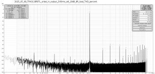

Meanwhile I did some measurements to verify my actual TPA3118 PBTL mono PCB.
Powered with 4 x 18650 LiIon in series the 1kHz clipping point with 8R load was about 9.5Vrms.
1kHz-THD+N at 8Vrms is 0.018%. Pretty good compared to TI spec of 0.1%. To be fair
  • My load is 8R (TI:4R)
  • This is PBTL mono - not BTL stereo
  • Inductors are much bigger than the TI ones.
This may explain the better performance.
The harmonic spectrum looks ugly with hi level distant harmonics.
This is no hi-end reference design - but with a total THD+N < 0.02% @ 8W output not bad at all.
  • 2025_05_08_TPA3118PBTL_unbal_in_output_2V8rms_att_18dB_8R_load_THD_percent.jpg

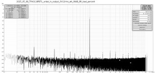

The nice thing is that by reducing the output level THD drops continuously until a sweet spot of 0.0077% @120mV/8R = 1,8mW.
Below that point harmonics are buried in noise.
Which tells us that this amp does not produce any crossover distortion as we know it from linear class AB topologies
  • 2025_05_08_TPA3118PBTL_unbal_in_output_0V12rms_att_06dB_8R_load_percent.jpg
