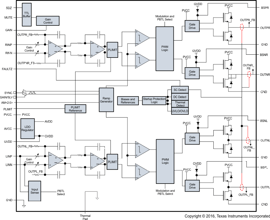

Only working output MOSFETs can be disabled by internal protection circuitry.
Burned ones are melted and short the output to supply voltage no matter what internal protection is doing..
You cannot block a melted MOSFET by removing its gate voltage

Again and I guess we're at an impasse (you and I also) and no offense intended to either you or bucks.
But, perhaps you are both missing the idea behind what I had originally said. "After" the MOSFET (inside the chip). As in either:
1. Open circuit to + or - (between output device and speaker)
or
2. Short circuit to + and - (feeding speaker)
If either of those were implemented within the chip, it is possible to stop shorts at the MOSFETs from reaching the speakers. Of course only TI engineers would know this for certain. Can we say without a shadow of doubt that it's not implemented? Maybe we can. Perhaps I am optimistic that when I see DC output protection on the data sheet that neither #1 nor #2 above are implied.
EDIT: and one more obvious means that I missed: #3 open Vcc or Gnd when there's a fault at an output device.

There is one point missed in this discussion: The mentioned amps are single voltage and bridged. It depends of the state of the second amp how a defective output MOSfet will behave. If both blow and give full rail voltage to the output, the resulting voltage at the speaker is zero. One MOSfet would have to be grounded and the other one at full voltage to harm a speaker.
If such an amp is used single ended, the output capacitor will prevent a DC fault at the speaker.
I don't have practical experience with defective TPA3116 or TPA 3255 chips, so this is only a theoretical thought.
Ok looking at the data sheet:
"7.3.9 DC Detect Protection
The TPA31xxD2 has circuitry which will protect the speakers from DC current which might occur due to defective
capacitors on the input or shorts on the printed circuit board at the inputs. A DC detect fault will be reported on
the FAULT pin as a low state. The DC Detect fault will also cause the amplifier to shutdown by changing the
state of the outputs to Hi-Z
Which sounds like only the gates are controlled. Nothing after the MOSFETs and nothing cutting off the supply to the MOSFETs. Sad but true.
It's a shame that one more MOSFET couldn't have been implemented to switch off the 12-24V supplying the output transistors when a major fault were detected. MOSFET power is pretty cheap these days. I'd doubt that one more transistor inside would have added even a few cents to the retail price of the chip.
