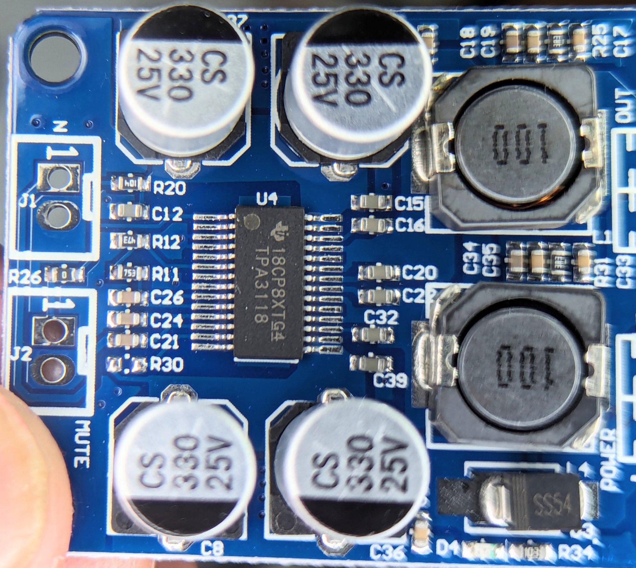

Got these boards from China and am delighted with them EXCEPT the gain is way too high for my application (triamplified speakers in a conventional hifi system).
Gain seems to be ~32-35dB, and my other amps ~27dB.
I have read that the boards use two resistors in a voltage divider to set the gain.

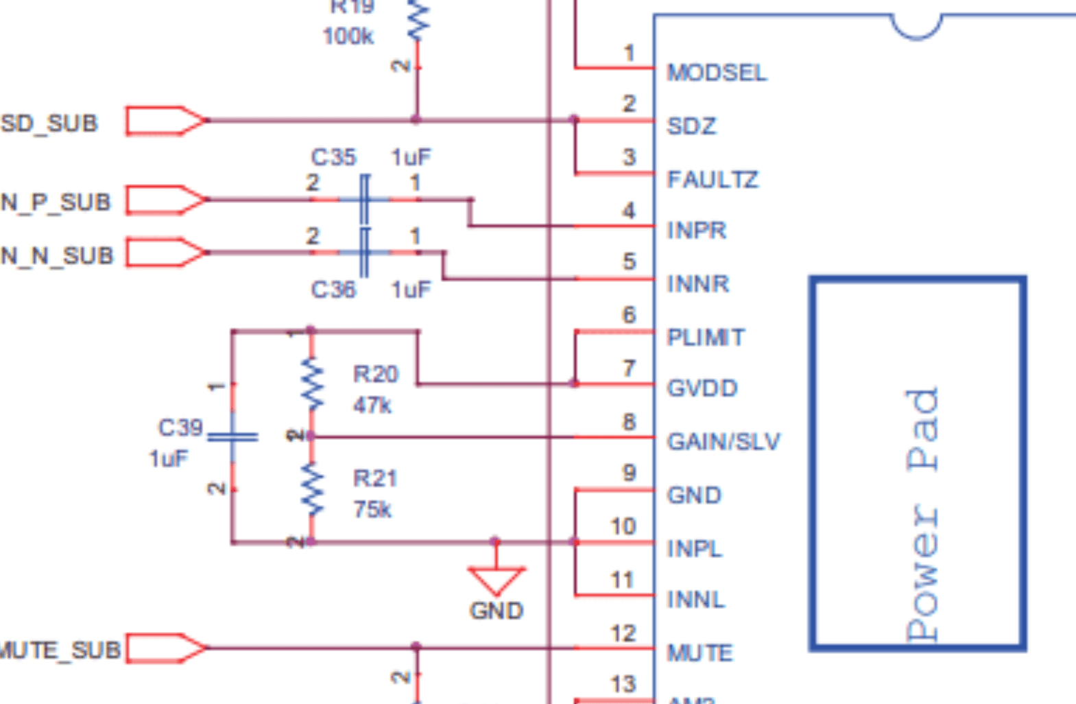

The pinout diagram for y TPA3118 shows a 47k and 75k resistor in the gain-setting voltage divider.
I see R11 & R12 and think these may be the ones to change(I even read removing the larger value will give a gain of 20dB). I'm not experienced nor confident enough to make changes without some positive confirmation. Anyone here have experience changing/removing the tiny SMD resistors and which one to remove? Thanks

R12 on your board is 47K (473 on the resistor means 47 X 10 to the third power = 47 K). R11 is 75K (753 on the resistor). You can see in your board picture that pin 6 goes to R12 and pin 9 goes to C26 and R11. That matches the schematic you posted. From the datasheet, are the different gains you can choose:
R12 R11 Gain, dB
47K 75K 36
39K 100K 32
20K 100K 26
5.6K Open 20
You should get 20 dB gain. Read section 7.3.1 of the datasheet for a full explanation. Do note that at 20 dB gain (10X voltage gain) you'll need an input voltage of 1.41 Vrms to get full output (50W into 4 ohms). The good news is the 20 dB gain setting has the the best SNR (less potential hiss).
