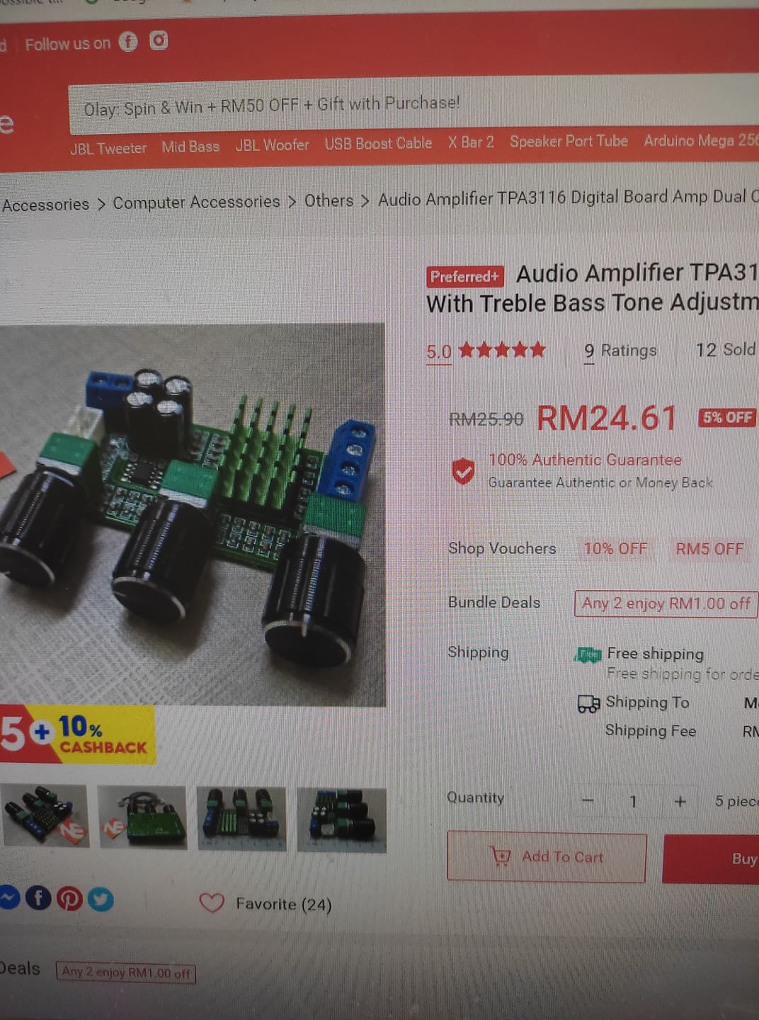

i am looking forward to buy this module TPA3116D2 but another version ... this one has tone controls but it has no inductor capacitor network at the output ... so is it safe to use anyway? as far as i know most class D amplifier will have the inductor capacitor network at the output ... thanks
Actually the linearity could be higher without inductors (the junk is out of band and has no affect on the sound, just on EMI - filterless designs have to be carefully designed to avoid too much RF emissions, normally restricted to products where the speakers are built-in).
