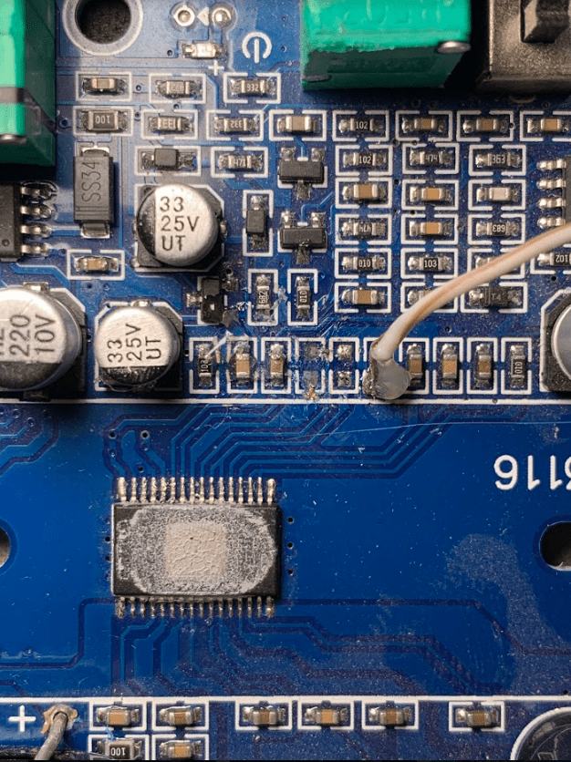

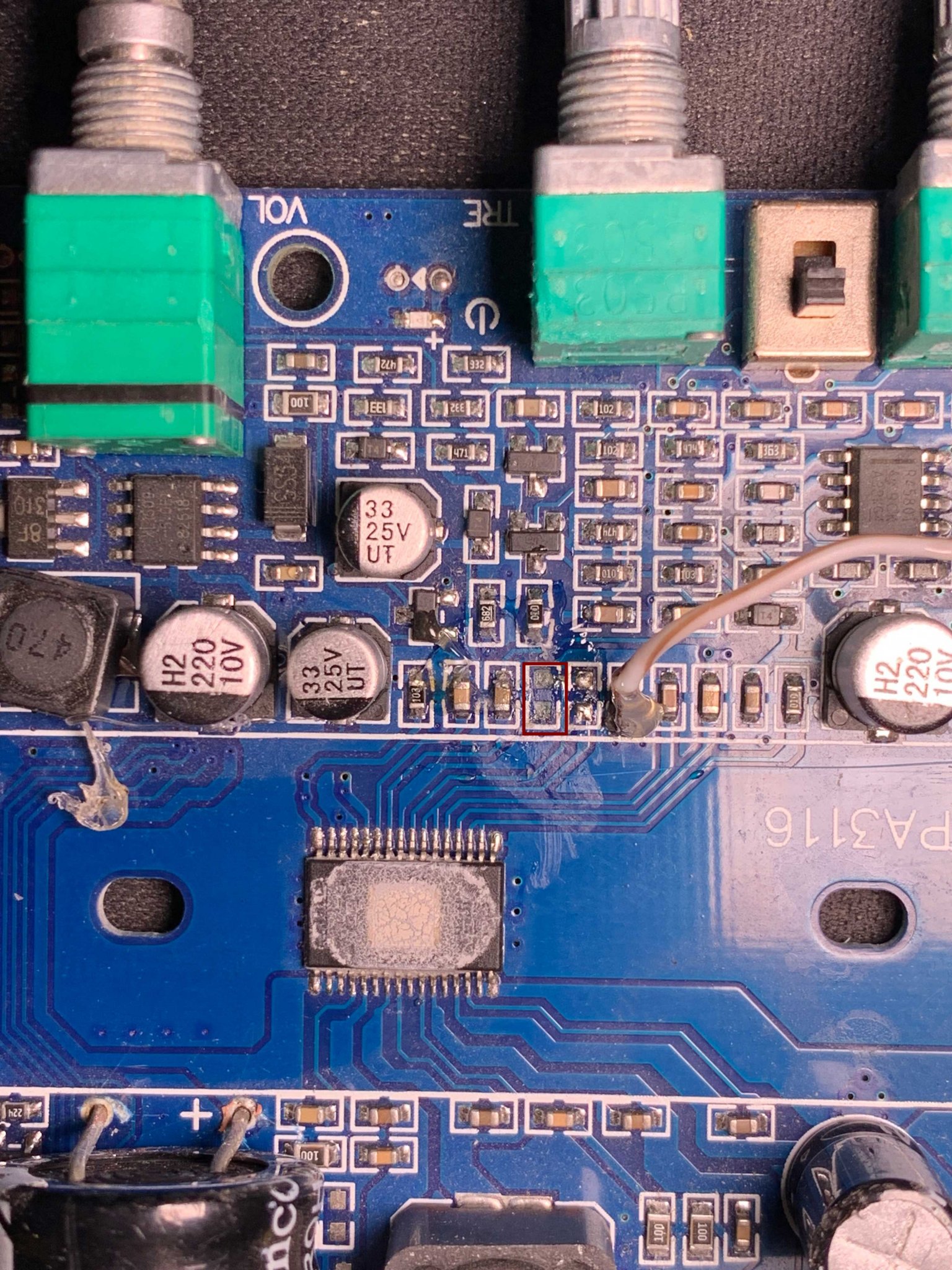

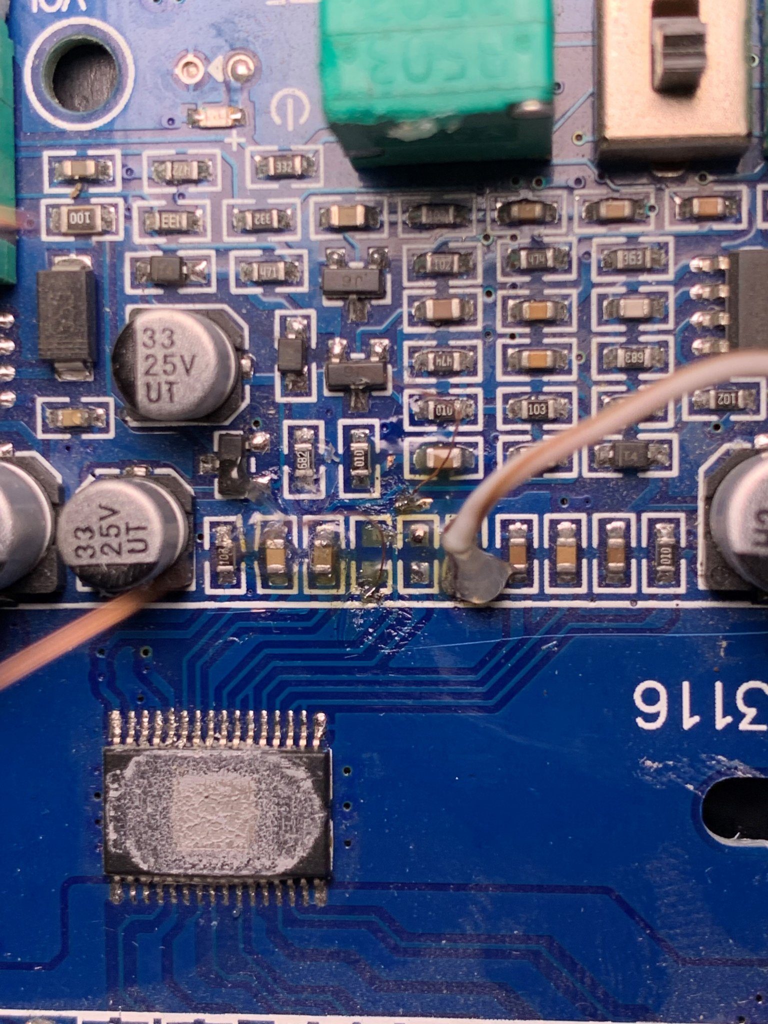

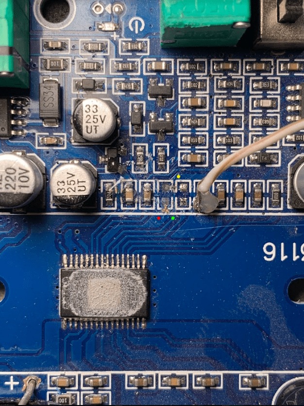

You can try soldering the resistor directly to pin 8 & 9. Though that will make impossible to mount heatsink on the chip. You can try scrapping of the trace which leads to those two pads and solder the resistor across those two points though.@Trileru So I stripped off the soldering pads while trying to solder a 5.6k resistor for the master gain. Any idea where else I could solder the 5.6k resistor?
I have indeed tried scrapping but I did not find the upper traces for some reason, I scrapped and scrapped and only found the bottom one. Which direction should I be aiming for? top left right?You can try soldering the resistor directly to pin 8 & 9. Though that will make impossible to mount heatsink on the chip. You can try scrapping of the trace which leads to those two pads and solder the resistor across those two points though.
Scrap off the traces marked Green, Red & Yellow. If the multimeter shows continuity across Green & Yellow points, you can solder the resistance across Red & Yellow. If it doesn't shows continuity you will have to solder it across Red & Green anyhow.
Thank you so much for your advice. I've managed to scrape the traces of Yellow and Red points (they do have continuity) and solder two copper wires from the points to a 5.6k resistor. When the resistor is in circuit, it measures 0 Ohms, and during operation it measures 0 volts, and also measuring the two points without the resistor measures 0 volts. Is that normal?Scrap off the traces marked Green, Red & Yellow. If the multimeter shows continuity across Green & Yellow points, you can solder the resistance across Red & Yellow. If it doesn't shows continuity you will have to solder it across Red & Green anyhow.
The Resistor used in this position is Gain sensing resistor so I feel its normal to have 0 potential drop across it. If the amp is working okay now then you can simply solder a 1/8 watt 5.6 k resistor directly to those spots (Red & Yellow). Will be much neater that way.Thank you so much for your advice. I've managed to scrape the traces of Yellow and Red points (they do have continuity) and solder two copper wires from the points to a 5.6k resistor. When the resistor is in circuit, it measures 0 Ohms, and during operation it measures 0 volts, and also measuring the two points without the resistor measures 0 volts. Is that normal?
Funny enough the amp worked fine with no gain resistor in place, couldnt hear a difference, how could it be?The Resistor used in this position is Gain sensing resistor so I feel its normal to have 0 potential drop across it. If the amp is working okay now then you can simply solder a 1/8 watt 5.6 k resistor directly to those spots (Red & Yellow). Will be much neater that way.

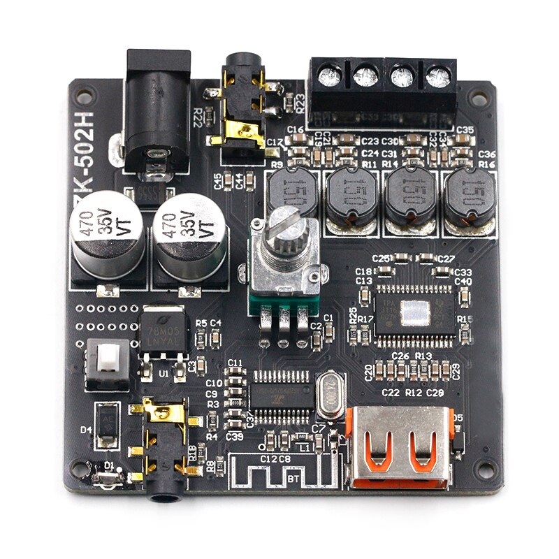

Decided to try the ZK-502H (one particular reason is that is seems to have the output snubbers in place - did not check, just by the count of the parts near the output inductors)
On bluetooth or wired (on aux) to the phone works perfect. But wired to the PC, it has noise with both internal or external sound card. Running on old laptop brick, 19V, I think it's a Delta power supply. Will try another power supply, this one is grounded and maybe that's an issue since the PC ground is wired to GND
Potentiometer is not to be used at very low levels (cheap one, nothing unexpected)
Not sure about the power switch if played at full power, also output inductors look small-ish
Not sure about the usb power claiming to work as both host (insert stick) and device (connect as soundcard to pc) - don't have an usb-a to usb-a cable in the drawer
Bluetooth is unfortunately SBC only, no sign of any decent audio codec
