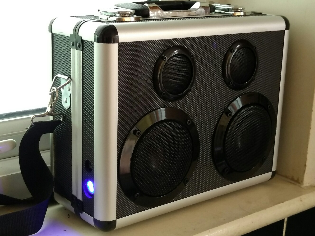

Hi, I'm using this amp board in a BT speaker I've made. I don't have a hiss problem and apart from the annoying loud tones on startup, it's doing a great job.
Martin
