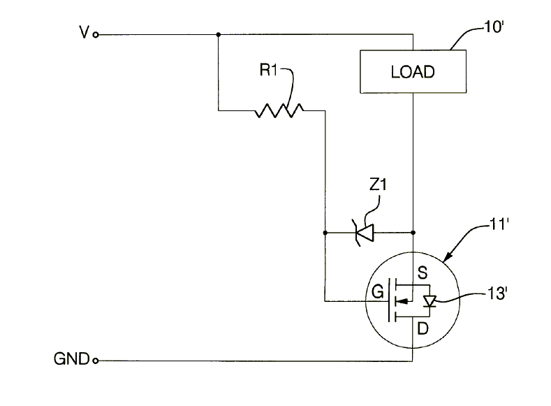

5) Fusing/reverse polarity/over-voltage protection Typically easily done and with the lowest loss by an n-channel mosfet, a zener diode, a resistor, and a ptc

5) a fuse, a fuse holder or a 5W zener are all in themselves and by themselves more expensive and more complicated to use than all the 4 parts I listed. Not to mention with a far greater power loss and parts that have to be replaced on a false tripping where the n-channel FET solution is self-resetting and failsafe.

3) Can you get me a ckt and BOM together as a comparision. I have pcb area available to add a alternative protection method, as you describe.
an n-channel mosfet, a zener diode, a resistor, and a ptc.

Baiscally the same as this
Just add a PTC with a trip in the mA range before R1. All parts are SMD. Total cost for all 4 parts around $0.80-$1.00 at digikey.
I see no short ckt protection with the N-ch MOSFET intrinsic source/drain diode conducting all the time, in the forward direction. I can see it working without the diode however.
Well, the chip itself has over voltage, under voltage, short circuit, over current, over temperature, and dc offset protection so I can't actually see a need for those externally as well. So the FET and resistor for reverse polarity protection is all that is needed really. The zener is optional, yes.
