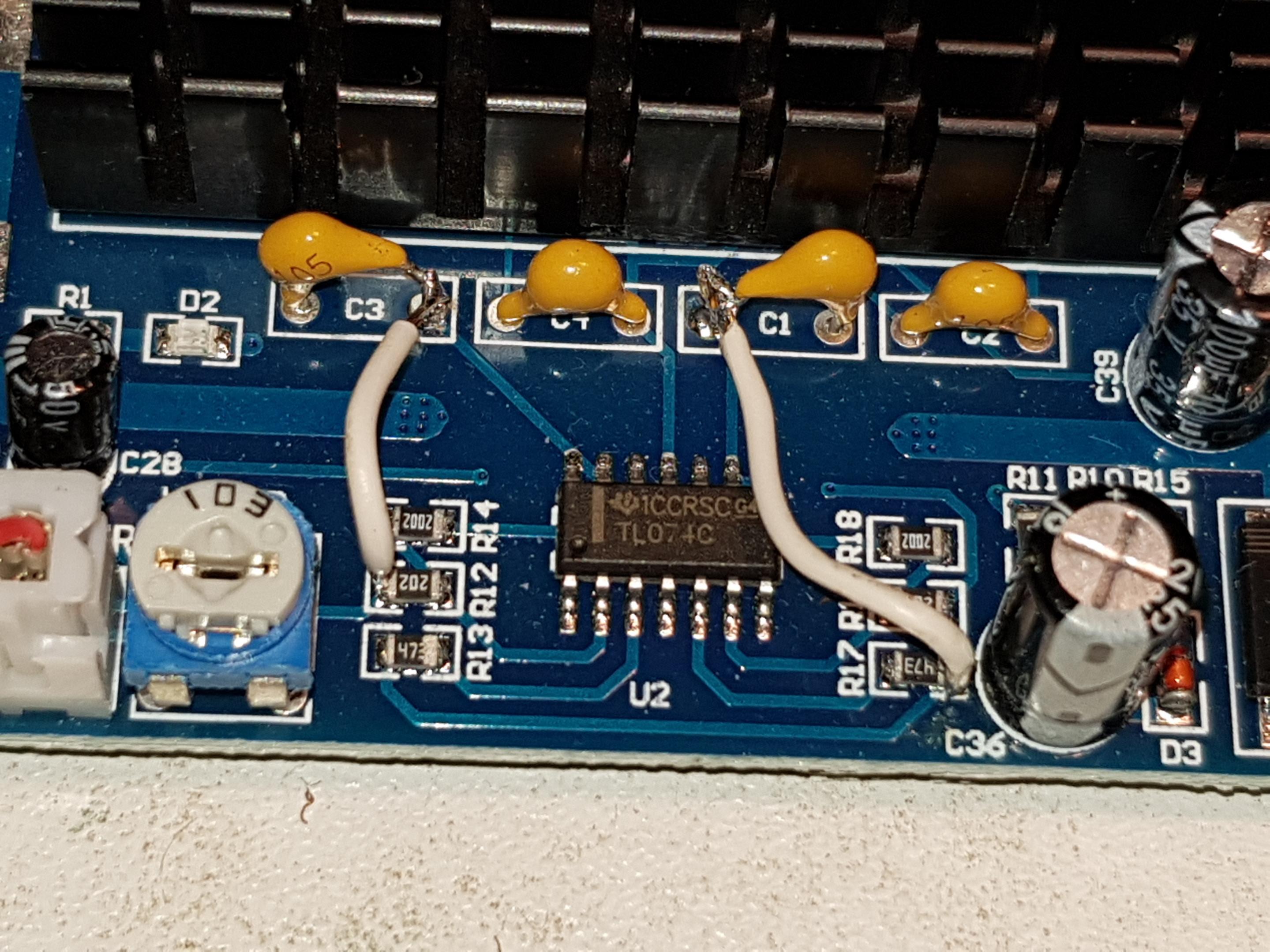

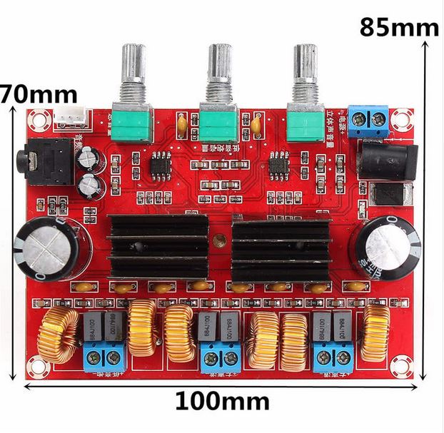

That's what I thought so. But, how?
I should desolder it, and connect input to output, bypass it like it wasn't even there, right?
If I see well, the output signals go to the yellow tantalum and there should be inputs of TPA chips.
Bypass everything from the input socket.
It's done, no more hiss. I don't know why someone thought this op amp was needed, even now those input pots cannot be turned over 50% with regular level input.
Interesting to see only 1-2A at 18V draw when music is really loud. Only thing is, now it turns off like it's not getting enough juice, but this power supply has driven hungrier amps without a problem. New 24V power supply is in the mail anyway so I'll see later

My experience is TPA3116 generates a lot of hiss if it looks into a high impedance (>10K) at the input. iIt may be an impedance that is only high impedance at higher frequencies, like a poor ESR capacitor.
I always try to put 4K7 across (to ground) the input terminals if the source allows that.

Ok, input caps are bypassed now. Now that op amp is gone, they are in series with yellow ones anyway, I think I'll just replace them with polypropylene 0.22 uF and that's it.
Got new power supply, 24V 6A (9A peak, or so they say) so it is running in good conditions. Can't say much about SQ yet other than "it sounds nice", but wow this can be loud. I think power supply gets to its limits before amp but at those levels it is too loud, except testing I will never go there. Interesting how much can this little board give 🙂
Reference calls for 1uF input caps 😱
Thanks for the info.
And I typed double wrong. There are 2.2 electrolytic caps on input now (not 0.22), but that value was because of (now missing) TL074, then there is a yellow tantalum in audio path between op amp and TPA. So I should go with a better 1uF, that yellow one should already be 1uF
You can bypass those input pots and very bad elcos on input line.

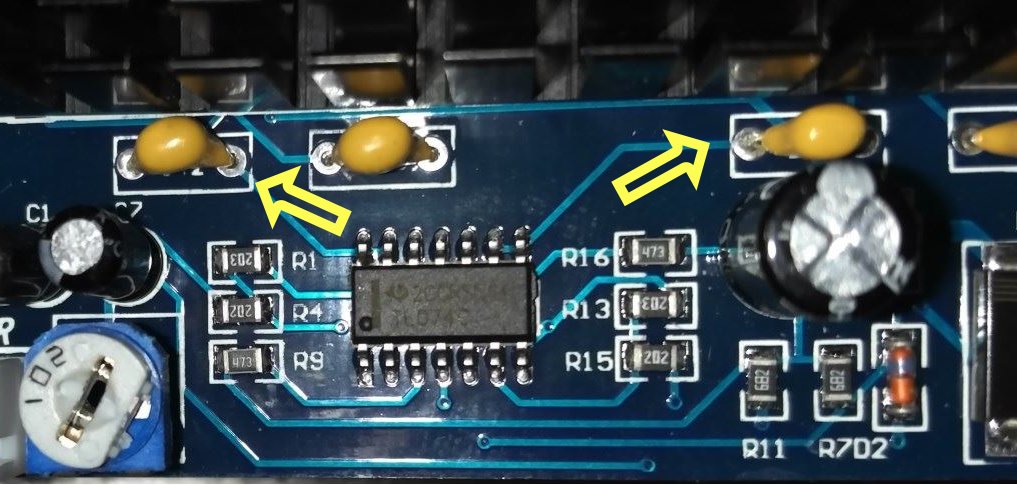

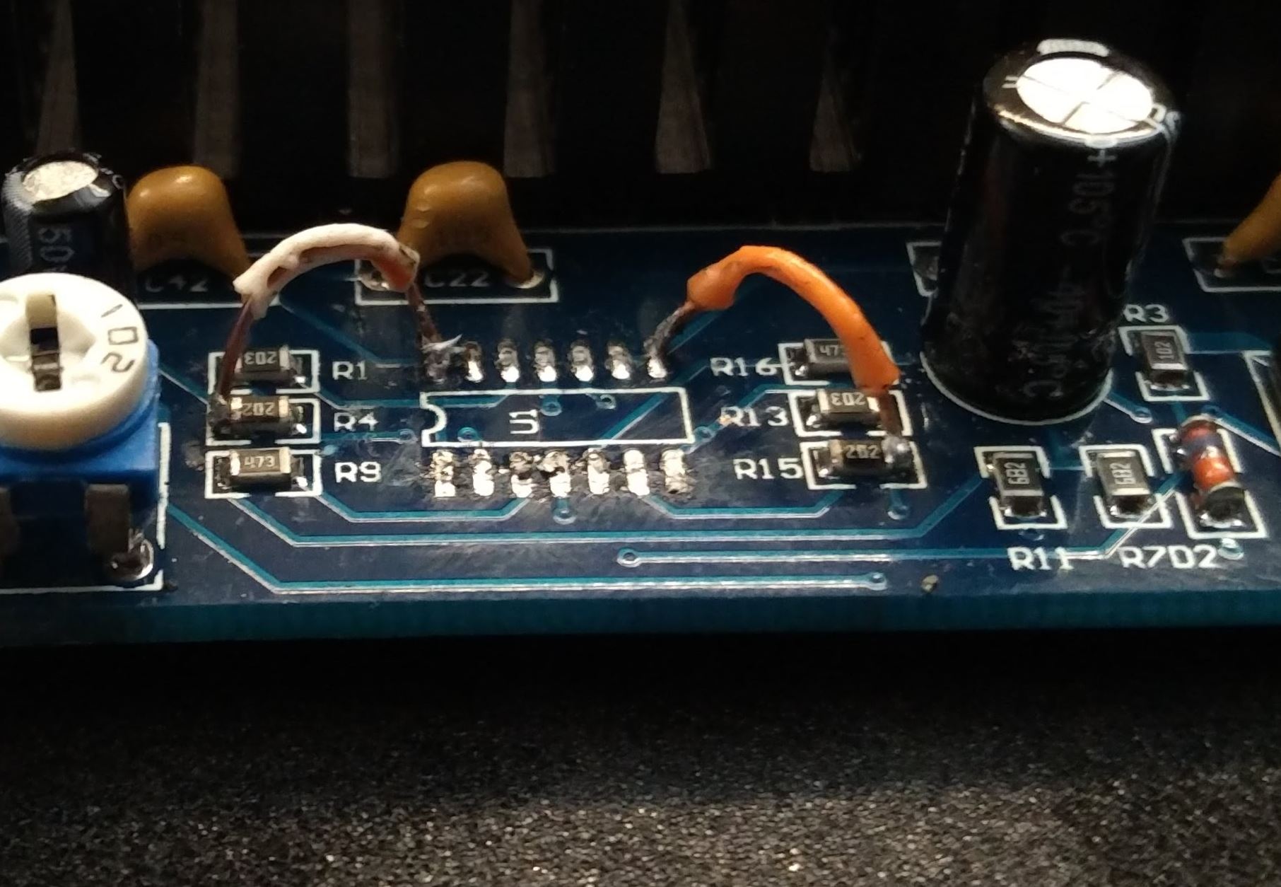

I have an amplifier thats almost equal to the one of Dac0908, but there is some difference in the position of the yellow capacitors and the layout. Nevertheless I gave it a try. I thought just bypassing the opamp should be sufficient and I made the connections. Unfortunately there is no music. Have I made wrong connections or do I have to remove the opamp? Not clear visible in the picture: the leg of the capacitor that is connected to the wire is disconnected from the board.

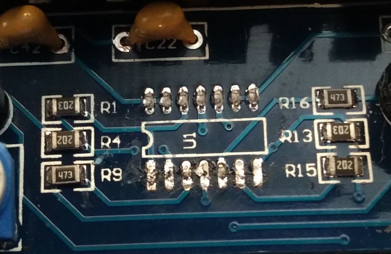

I have the same board as you. Unsolder the 074 completely. Find the resistors marked 202 on R12 and R16. Solder R12 to what was pin 14 and R16 to what was pin 8.
If that yellow one is 1uF you have a little limited bass, needs to be 10uF for full extension according to datasheet
😕 Those are input caps and datasheet calls for 1uF nonpolar caps
I wouldn't put 2.2 ecaps cos their ESR is ungodly but if you have those yellow caps they might just be MLCC...
Ceramic ESR is very low but their sound is poor.
Ok so those yellow tantalum caps are 10 uF? Honestly I couldn't tell, there are some letters on it but its's a smidge, really small.
@taita, I think that @whoever got it right. We have a bit different boards, mine is dual chip. It's just about following audio path from input through pots, caps, some resistors, TL, yellow caps, then to TPA. Basic thing is you need to skip TL074. But if you don't get rid of it, it will be working and amplifyng (10x as irribeo said) until you cut its's power so really, my advice is just pry it off like I did.
