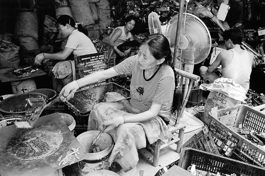

And what exactly is that "lady" in India expected to do with these on her skillet?
melt components off PCBs for re-sale/re-badging
I tried to find the picture showing this but I gave up after 30 seconds so you'll just have to imagine a woman, or man, sitting by a steel drum fire with a plate of PCBs scraping off components.
That would be a chinese lady ....
