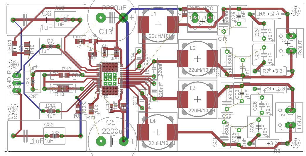

Here its a little pic of what Im doing...
look at the input caps on the left side, top and bottom of how there is the print of a large cap like a jantzen cross cap, then a wima 7x5mm and a 0603smd like suggested in the datasheet of the TPA3116EVM board.... The same with the other 1uF caps, the gain resistors... will do the same with the 220nF at the output side of the IC...

Thanks for the dedication to designing this board and providing enough thru-holes to include our preferred components. In looking at your layout, it looks like there is a missing connection between R9 and C28 on the left channel output.

What I showed its how its going... Not finished yet... I still have to add the option of smd for the output... And recheck everything... Then the last step its to make all the GND plane...
Saturnus, please comment freely whatever you see... All Help its all welcome without offense, as I said before Im a total newbie in electronics, so its easy that I make mistakes...
Well. There's several comments
1) The chip has differential input so all 4 input caps must be identical. Also the ones connected to ground.
2) There should not be connections under chip other than GND connections to the GND pad.
3) Bootstrap capacitors should not be polypropylene or similar. It must be ceramic or tantalum and must be as close to the chip as possible. No more than 5mm maximum.
4) Filter inductor should either be grouped 1x4 or 2x2. If space does not permit that then should be placed so they are a little apart from eachother and grouped around the chip.
5) Filter output GND should be connected directly to the GND pin associated with that particular output and then to the GND pad.
6) All analog GND should be connected directly to the analog GND pin and then to the GND pad
Then there are some routing mistakes but I reckon they'll be cleaned up eventually as the other points are corrected so I won't comment on those yet.

I see you are combining through-hole and SMD, that is exactly what I was thinking about my design.
@Saturnus: Thank you for your advice. I can see you have a lot of knowledge about this.
