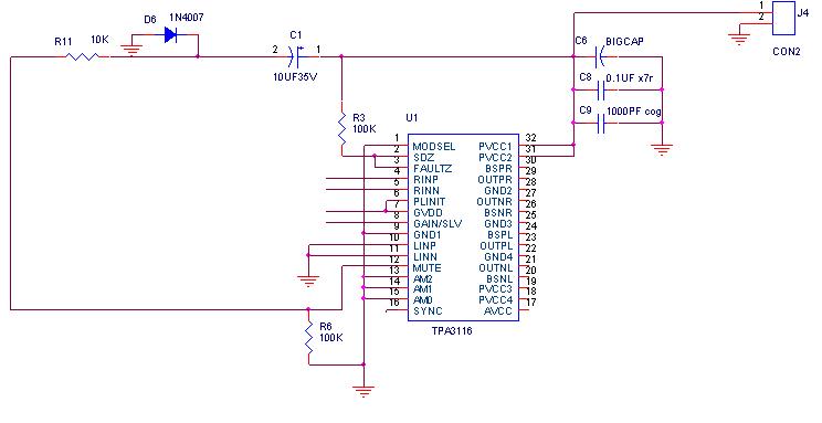

If that's true, then I'd look to the power supply. Is it guaranteed to meet spec? I've pushed 26v through a similar TPA3116 2.1 board at max volume for hours w/o issue. However, on some tracks at a frequency where the woofer draws maximum amps, the SMPS shuts down then comes back as it can;t handle the amp draw.
I think I read about Giancarlo mod against power on POP having same effect sometimes, muting when at higher power levels. Is there antipop on these boards ??

The muting at higher levels caused by anti pop was discussed in this thread or in Dugs groupbuy thread, and I didn't really follow or really tried to understand why. Dug or Doctormord know how these things work, I don't.
The circuit I use would go to mute if the supply recovered (positive going) from a drop of a few volts. (Probably >2.5)
In theory you would hear the first 1/4 cycle of the bass note (or heavy load) and then as the power supply recovered the mute would be activated.
Never drove mine loud enough for this. (or my supply/caps were sufficient to handle the loads)
To test this theory, ground the mute pin hard after power-up and test.
