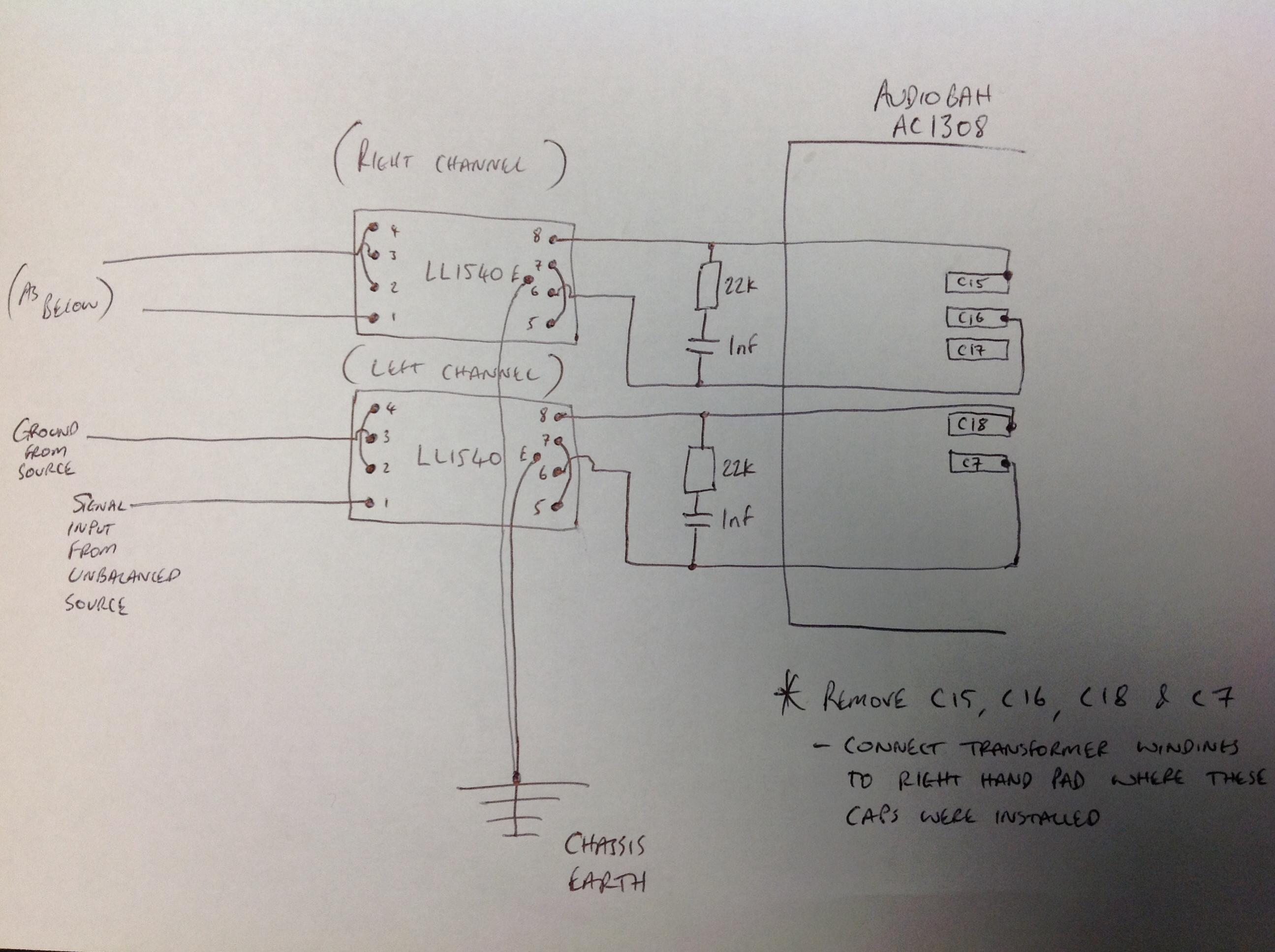

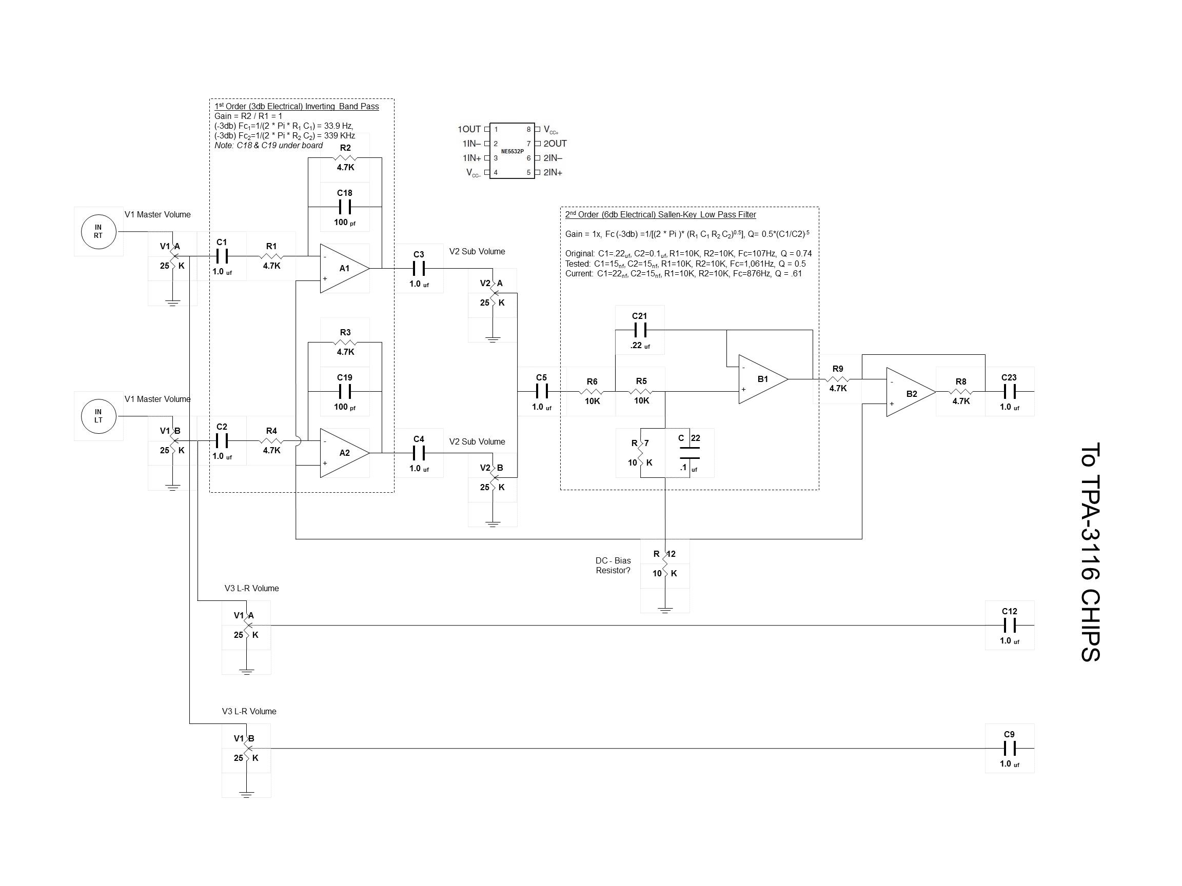

Hers a rough schematic ... It's easier to read if you download it to your PC and open with Windows photo Viewer or similar app.
C23, R8 not correct connections.
If this is single supply then there needs to be a resistor to Vcc and a cap to bypass "bias point" to GND.
If +/- supplies then just GND the +inputs.
edit: OOPS...did not pay attention to the "rough schematic" part soon enough.

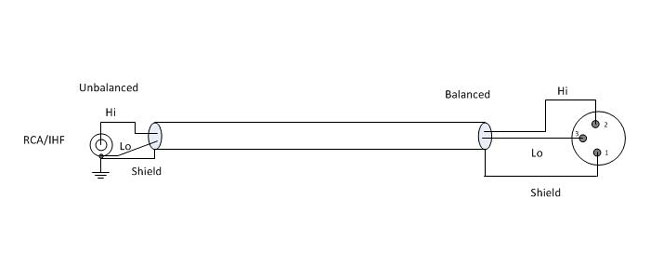

Check out the attached image below, it's Figure 2 from Rane: Sound System Interconnection. If I'm reading it right, it says XLR pin 1 (i.e. signal ground) should be shorted to chassis, and in turn the chassis is earth grounded. Doctormord hinted at this above... but (1) I did try shorting signal ground to the chassis, and it did nothing for the squelch, and (2) my chassis isn't earth grounded, because the mains power supply is in a separate box.

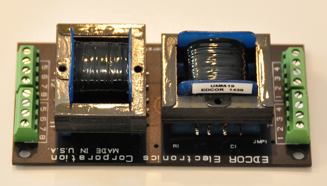

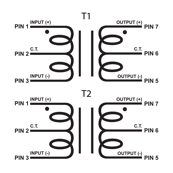

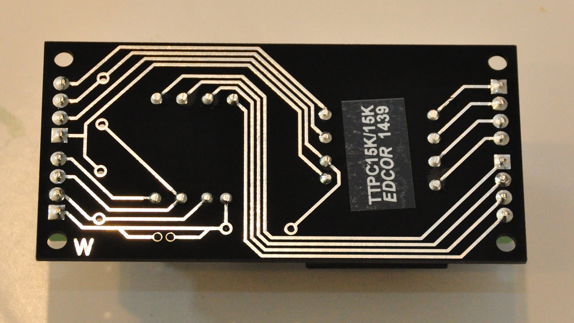

On the transformers... waaaaay back in this thread, in post #3696, Sharpi31 posted a picture of his tpa3116 implementation using Lundahl LL1540 transformers for unbalanced to balanced conversion. Later, in post #3718 he posted a schematic of how he wired the transformer. His schematic is basically straight from the Lundahl LL1540 datasheet. I reproduced Sharpi's pictures below, but there is a fair amount of discussion about transformers that takes place, though much of it is over my head.
Interesting is that he has a 1nF cap and 22k resistor in series between input POS and input NEG (on the amp side). This is per the LL1540 datasheet's suggestion. Also per the datasheet are some jumpers on either side of the transformer... From his picture, it looks to me like he's leaving amp input GND open.
Edcor doesn't document what pins 8 and 4 are on their transformers. I'm trying to get a datasheet and/or some application note document from them. I don't know why these aren't readily available on their website. If you look closely at the pics of the Edcor PCBs, they left holes for R1, C1, and JMP1... I would think a document would explain when and why one might want to use those.
At any rate, I'm thinking the implementation of these two transformers ought to be similar?

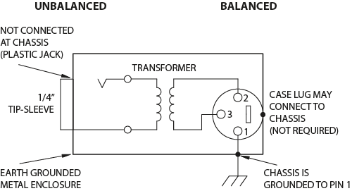

In this thread there has been discussion about ac1308 standoff holes not being isolated and chipfailures because of that in combination with smps. So sharpie31 ampboard gnd is chassis I think. He did mention noise, could be same amount you find annoying.
edit: maybe this is very wrong, but it looks like source chassis/gnd could be connected to amp gnd chassis, just like it is connected through pin 1 when source and amp use xlr ??

About the hum, in post #3696, he says, "no hum from speakers, just slight hiss with my ear to the driver (as good as I've had from any amp)". This is the same post where he provided the picture of his implementation. So I'm pretty sure he's not getting any noise.
This is what he says about his amp board/chassis grounding, from post #3707:
One slightly odd thing about the Audiobah board is that the ground plane on the bottom of the PCB extends to each mounting hole. I used brass PCB pillars so the amp board ground is connected to the chassis at four points. Incoming mains earth is tied directly to the chassis via one of the power transformer fixings. I haven't added any wires linking mains earth to PSU ground, but there doesn't seem to be any problem with this connection coming via the aluminium chassis and brass PCB pillars (I know this isn't best practice though). My approach was to wire things up this way and then review the scheme, if hum etc. we're an issue. The incoming signal and ground are only connected to the Lundahl transformer primary, so isolated from the amp. The Lundahl datasheet suggests that the centre tap of the secondaries should be tied to ground, but I've left this floating given the 3V bias of the amp signal inputs.
It is a single supply as are all TPA3116. There may be a resistor & Cap somewhere else, I was only interested in the signal path.
Why do think there is a problem with C23 and R8?
