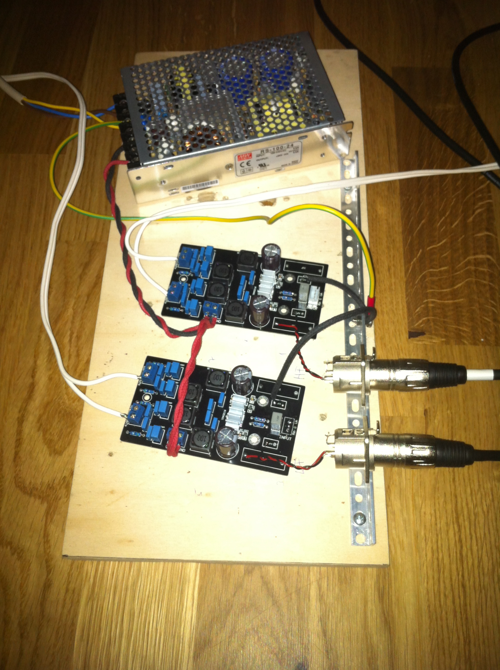

OK, so in this case i leave the negative outputs open and just connect the common negative input to (chassis) ground, right?
Your YJblue ampboard has single ended inputs like that, YJ only connects the positive inputs tpa3116 chip to inputconnector and connects negative 3116 inputs through (little cubes next to bigger blue cubes) capacitors to gnd. If you want you can do the same with outputs from your balanced preamp and also throw away half signal there, you don't need it for YJblue.
Can you improve that? Yes you can undo the negative input to gnd connection on YJblue ampboard, then you don't have to throw away half of your source/preamp output. Both ways you only use transformers to isolate source from amp, there is a good chance you already have transformers in your source/preamp, so that also seems like trying to double bridge the ampboard. But I don't know, I just think I saw xlr from your source going to transformers.
Yes, you are right: my balanced preamp has output transformers. OK, now i got it – the additional Edcors are useless in this case.
Many thanks for the explenation!
The ampboards work perfectly with this mod! I kicked out the input capacitors since the balanced signal comes from an output transformer and now even the off-popp is gone.
Today the amps ran the whole day and now i can definitely understand why they are so popular.
Thanks again for the advice!

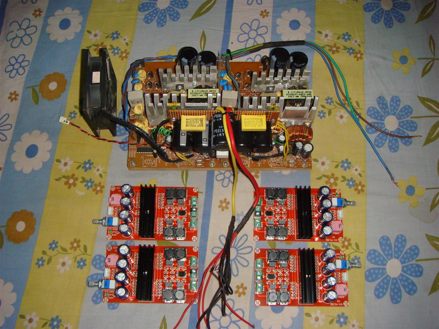

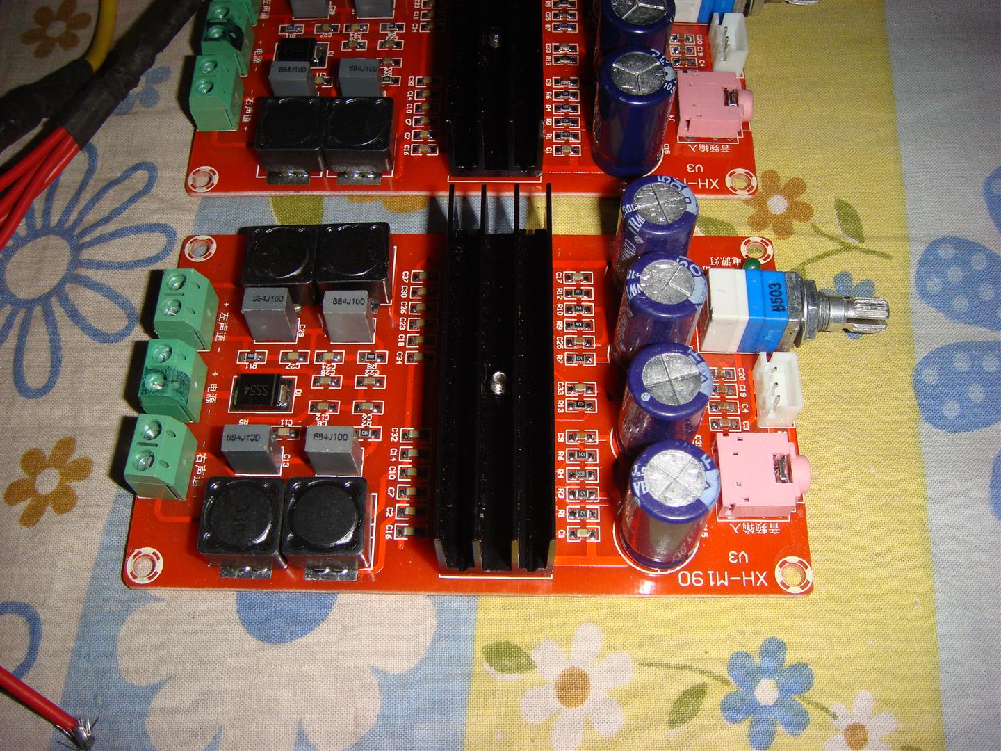

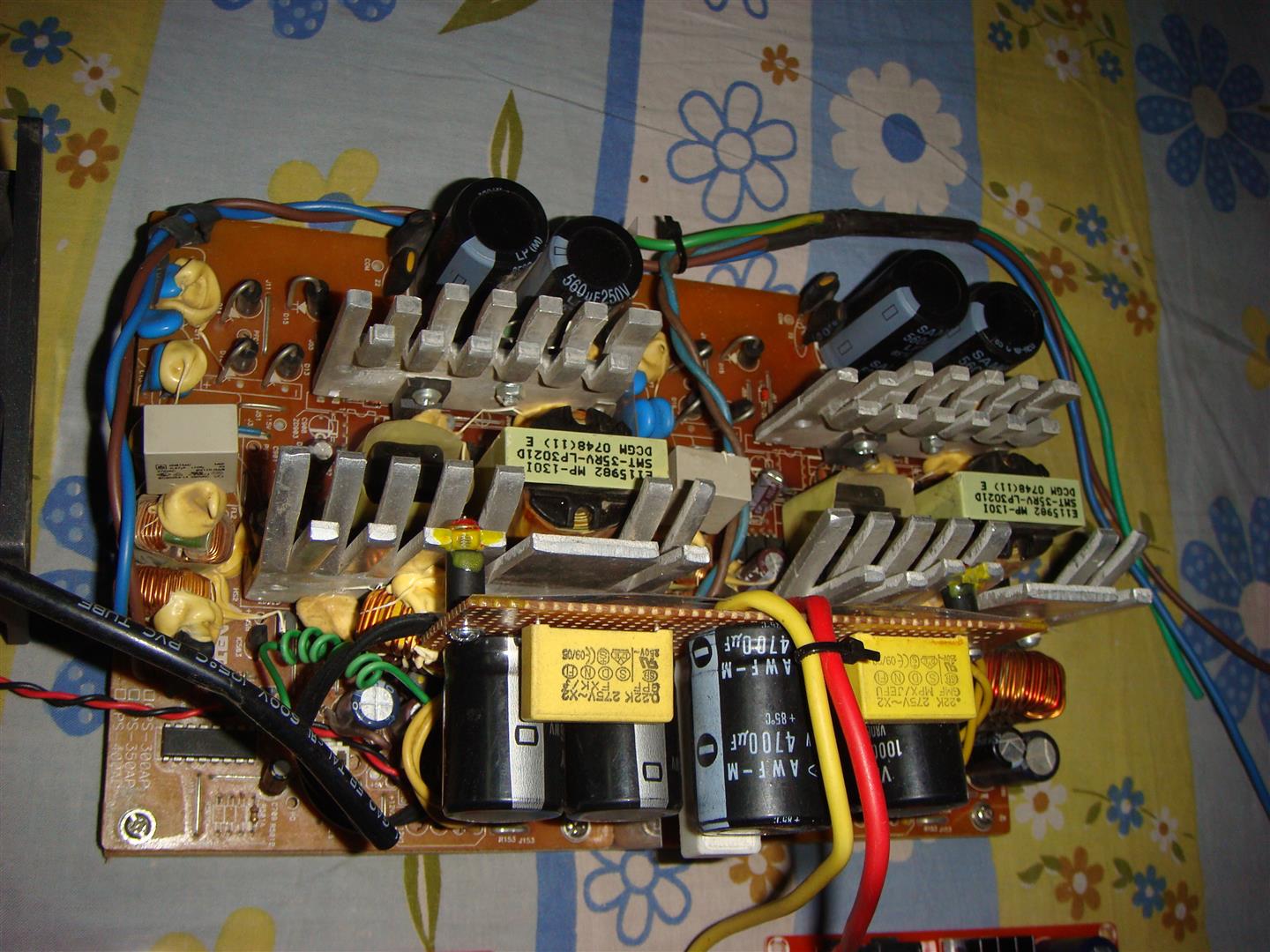

After waiting a lot, finally received my TPA3116D2 dual Chip 100 + 100W Class-D amp kits. For power I am using two old 400Watts Delta PSU in series, each giving 12v at 25A for total of 24v at 25A. Without any mods this amp sounds real good with ASUS Xonar DX as audio source
