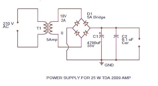

I would like to try a linear power supply (~21V) with a toroid transformer for my TPA3116.
Do you know where I can find shematics and documentation?
Probably it should be possible to buy one, but I don't know where I can buy one.
Any help?
Single voltage PSU can be a simple as a transformer, bridge rectifier and smoothing cap(s). to get 21v use a 15v transformer, 120va or larger. Caps should be 10,000uf or more, 35v or more. Filters and snubbers can be added but this is the basic and will work fine.
Here is a sample one I grabbed off the web. C2 isn't needed as bypass caps are on the 3116 board. Try to find a good quality cap with low ESR, using multiple caps to get the required capacitance lowers ESR as well.
post #5685
That darn web.
It put the bridge rectifier in wrong.
Rotate it 90 degrees clockwise and it will be OK.
