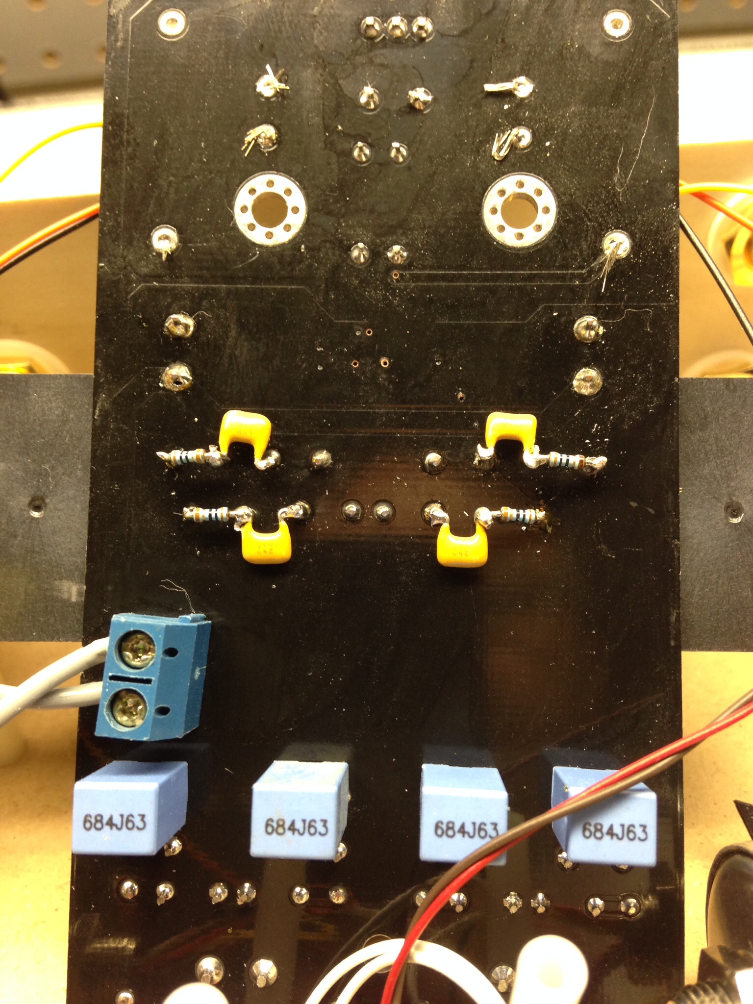

Sorry quote made very long post so deleted. Did you check if the left 104 decouplingcapacitor in your picture is making contact?
Wiring to speakerterminals and pcb silkscreen have a Sure Electronics touch 🙂 PCB silk probably mixed up polarity and then the Positive got soldered to black speakerterminal, which could make it correct again, but better check. Newer boards do not really care about polarity I would say...if components on pcb are not fakes they are good, complicated layout btw with 4th bootstrap cap placed after the inductors

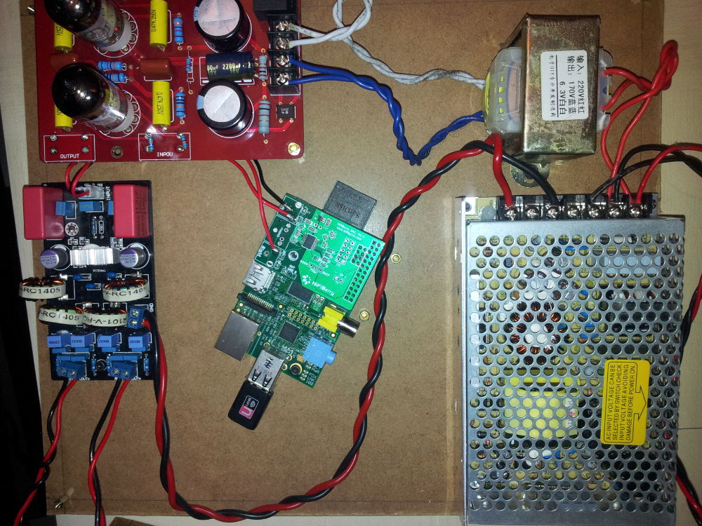

Here is my system based on tpa3116:
yj board upgraded
raspberrypi + DAC (not usb but i2S to lower the jiter)
custom MPD setup based on raspbian, all musics played from my network at 24bits without loss.
I can change the music, volume, playlist etc... from my android phone
DAC is linked to a chinese buffer (upgrade in progress)
then the buffer is link to the modded tpa3116.
Well, I have no good amplifier to compare for hifi. I just have my DENON home cinema amplifier.
I can say it is very easy to ear the differences between the two, in favor of the TPA 3116.
Here a picture of my ststem (not complete)

Thats a great little setup there, well done!
I'm also using an R-Pi with mpd (just usb dac and tripath), its been a very reliable and quiet running setup for nearly two years as well.
Well. This is not a raspi and 3116 only
But maybe we can start another thread for 3116 systems and this one to talk about modding?
