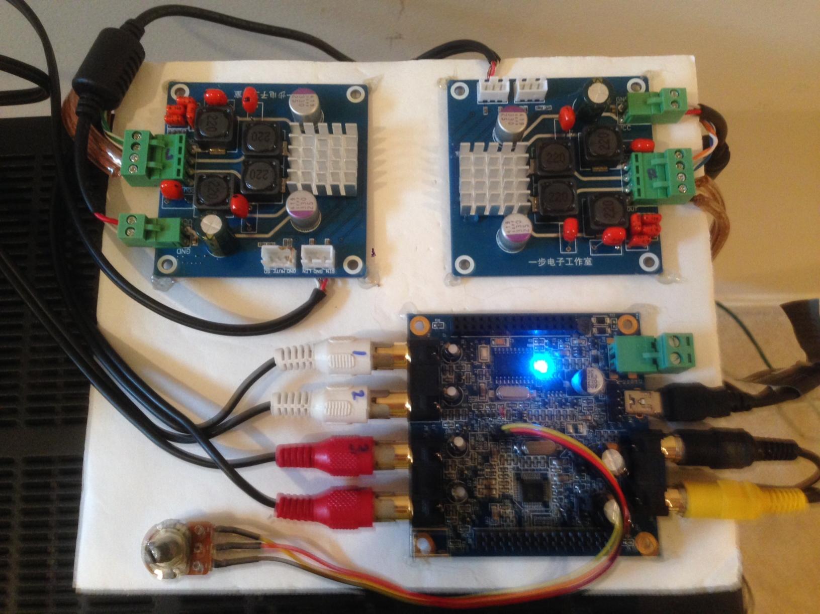

Rhing, xrk, others: what do you think about doing the inductor swap on the Sure board? The stock ones on the YJBlue board I believe were universally acknowledged as lousy. I don't know enough to judge Sure's, other than to say they are physically smaller. I would assume that there is some correlation between size and current capacity. I measured the Sure inductors to be 10mm square. Just from eye-balling it, it might be possible to put the big Coilcraft SER2900 inductors on the Sure board, though the caps would definitely have to be moved to the bottom, and the stock heatsink replaced as well. 100% match up between board solder pads and inductor leads certainly won't happen.
Another possibility might be these Sagami 7G14A inductors; they have favorable specs and less than 10mm width.
If the inductors don't get too warm or hot I would go with it stock. There is not much room there. The SEr's are *HUGE* maybe MSS series like unused on YJ is better fit - still those are 0.6in square. Other inductors to try are Bourns radial leads thru holes and bend pins to solder on SMT pads. They are very low profile as they stand up straight.
Panasonic EEU-FM1E471, 470uF/25V, 5mm LS, 10mm dia. x 16mm length. You can get these from Mouser or Digikey.
As for the minor turn-off pop, this diminished once I installed the 8x Panasonic FM caps and the Epcos X2 safety cap. I installed these at the same time, so I cannot tell you which contributed to reducing the pop.

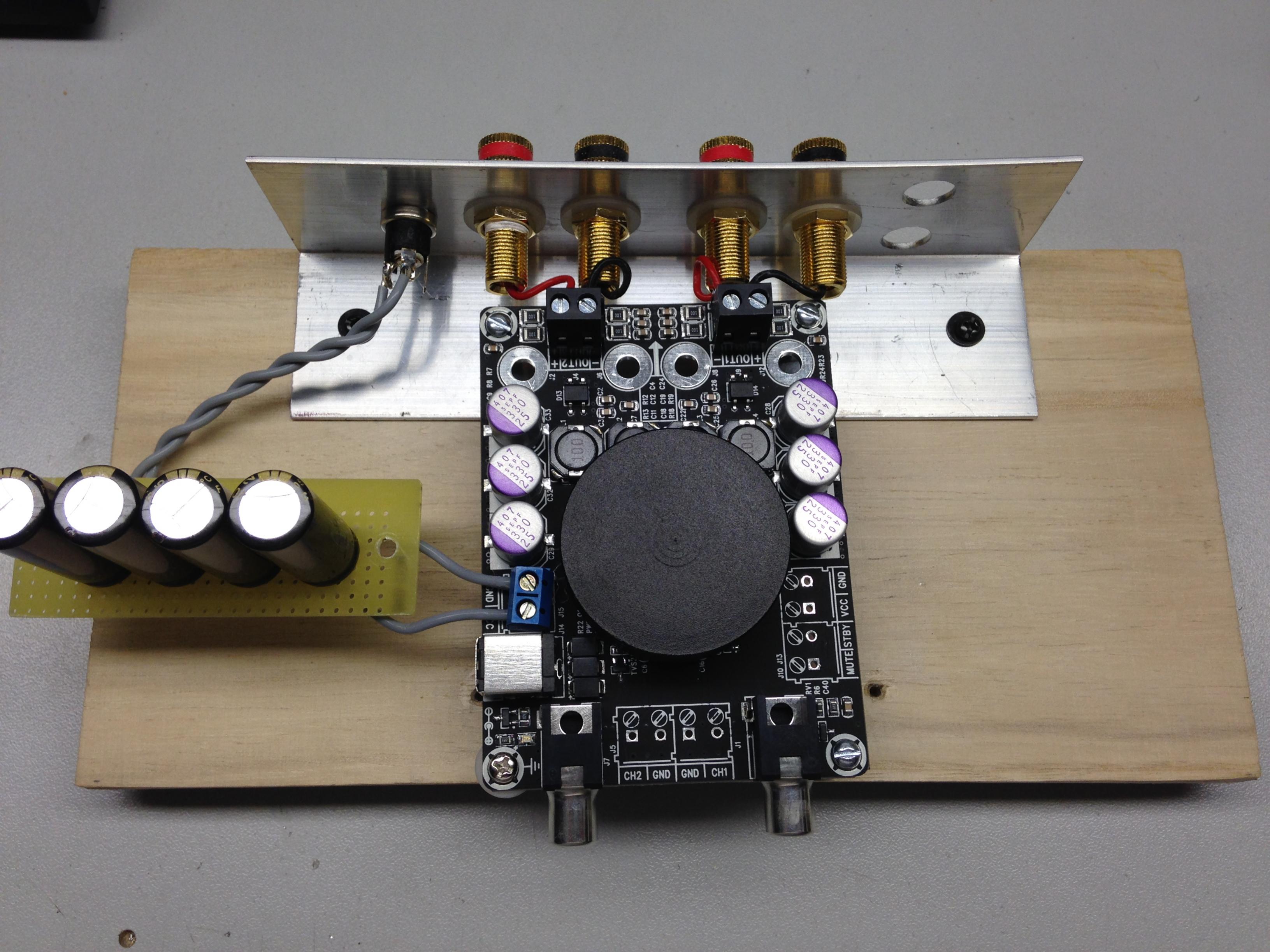

My Mouser order came in and I replaced the stock electrolytic caps on my Sure TPA3116 amp with the 330uF/25V Panasonic SEPF OSCON organic semiconductor caps. These caps have made significant improvements with the Sure amp in many areas: tonality, scale of the soundstage, a more focused image, timbral detail, and articulation.
One of my reference recordings is Yo-Yo Ma and Bobby McFerrin's "Hush." You can usually find a copy in the $1 bargain CD section at used music stores, but it is a gem that captures the acoustics of their recording venue. It is a very well mastered recording.
This along with other CDs and LPs are great for auditioning the effects of mods. Another favorite is Muddy Waters' "Folk Singer." With the OSCONs in place, the amp sounds more relaxed and musical. I don't hear that Class D etch to the sound anymore. It's smoother and more natural.
I won't say that this is now my favorite TPA3116 amp, because I haven't heard my modded YJ blue amp since the Sure amp showed up. The CineMag CMLI-15/15B input transformers came in yesterday. I'm debating whether to do the bootstrap snubber mod first or try the CineMag input transformers with the YJ blue amp. Either way, it takes some time to determine the effects of these mods, and I am by no means finished with listening to the Sure amp with the OSCONs.
Are those OSCONs on the Sure TPA3116 board surface mount flavor?
BK
BK
No. If I remember correctly, those cap positions are thru-hole mount only. Same with the output filter inductors and the 8x electrolytic caps.
Really? The 6 cap locations you upgraded today on your Sure amp are through-hole only? Looks like silkscreen and pads for surface mount. I asked because I'm thinking about trying a Sure TPA3116 amp and might add some parts to my order. Question is unrelated to my smsl board.
BK
BK
There are indeed pads. It's a feature that I like on these Sure boards.
