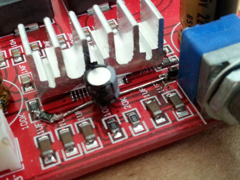

Want to reiterate y'all need to be listening to these TPAs with an Astron/TenTec linear power supply. You don't know what you're missing.
And anybody besides abrax do the pin 17 avcc RC filter yet? Come on guys there's more performance to get from these amps!
Well I am using a toroidal trafo, big caps and LM338 reg. Sounds good tho haven't tried any comparisons with SMPS.
As for pin 17 mod, just about to try it, looks like micro surgery! Got some 3.3ohm SMD resistors for it or should I use 10ohm?

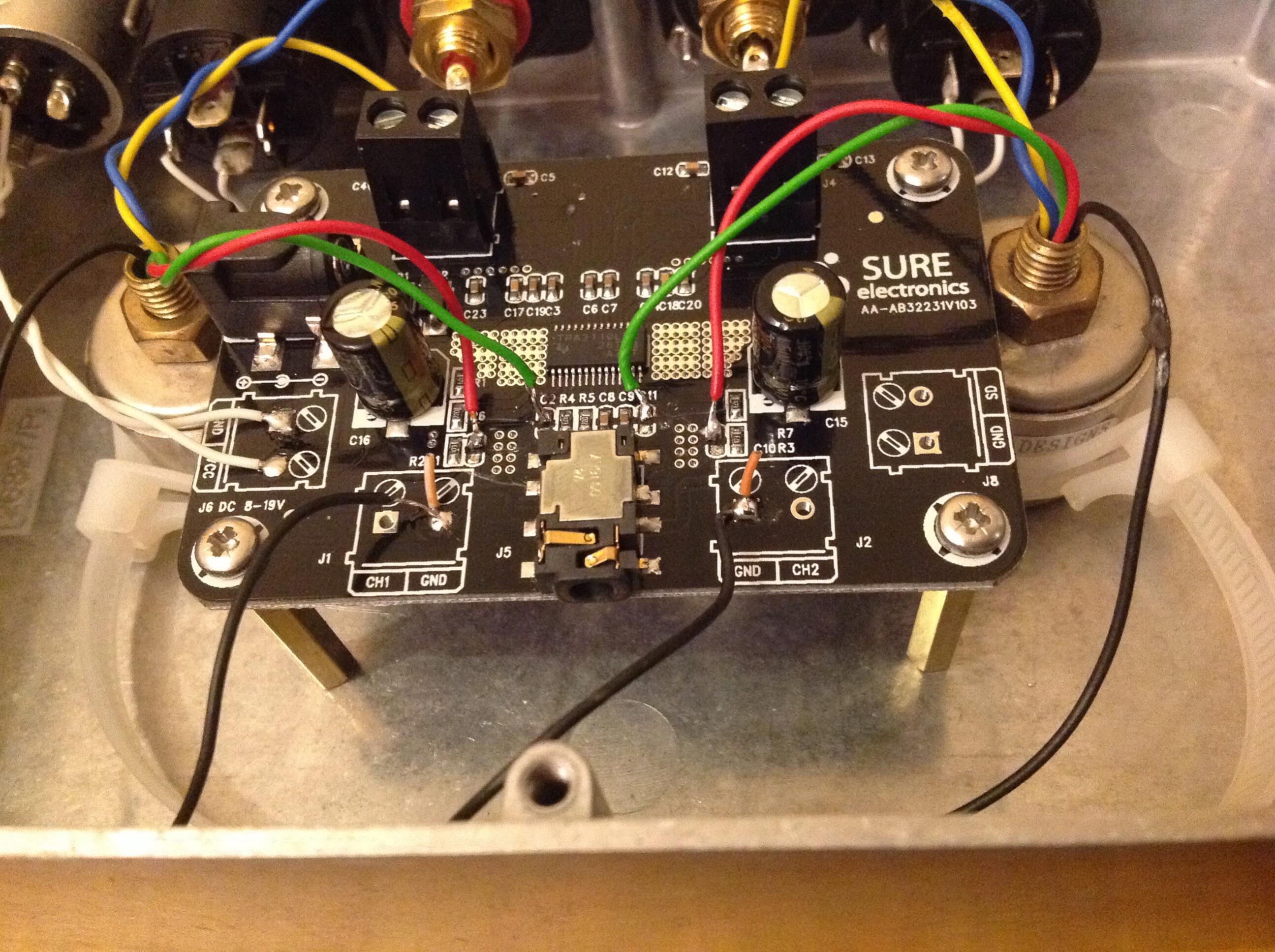

I've gotten and assembled a YJ's 3116 DIY kit.
Because I need a pre amplifier, I wanna remove the volume of 3116 KIT.
Usually I fix 3116 volume at maximum and adjust volume for my pre amp, after I turn on 3116 at minimum.
I wonder how I can fix the volume at maximum without causing any pop noise.
Or Isn't there any need to do this? I think "The less connectors, The better"
Thanks.

It's not pretty but it works great, thanks Giancarlo! No on or off bump anymore!
YJ, and other manufacturers building PCB's and amps should take note of this very desirable feature that costs almost nothing to include.

And anybody besides abrax do the pin 17 avcc RC filter yet? Come on guys there's more performance to get from these amps![/QUOTE]

Start here - http://www.diyaudio.com/forums/class-d/237086-tpa3116d2-amp-60.html#post3924399 subsequent posts provide further clarification.
I can report another successful input transformer modification, using Amethyst input transformers connected directly to the input pins on the TPA3110D2 chip. The transformers are specified for a 300ohm source and 10Kohm load, so not perfect for this application but good enough for testing. I now have no thump at power on (no input caps to charge). I have a pair of Lundahl LL1540 coming which should be a big step up in quality. Right now the amp sounds more relaxed and spacious than with a single ended source and coupling caps.
