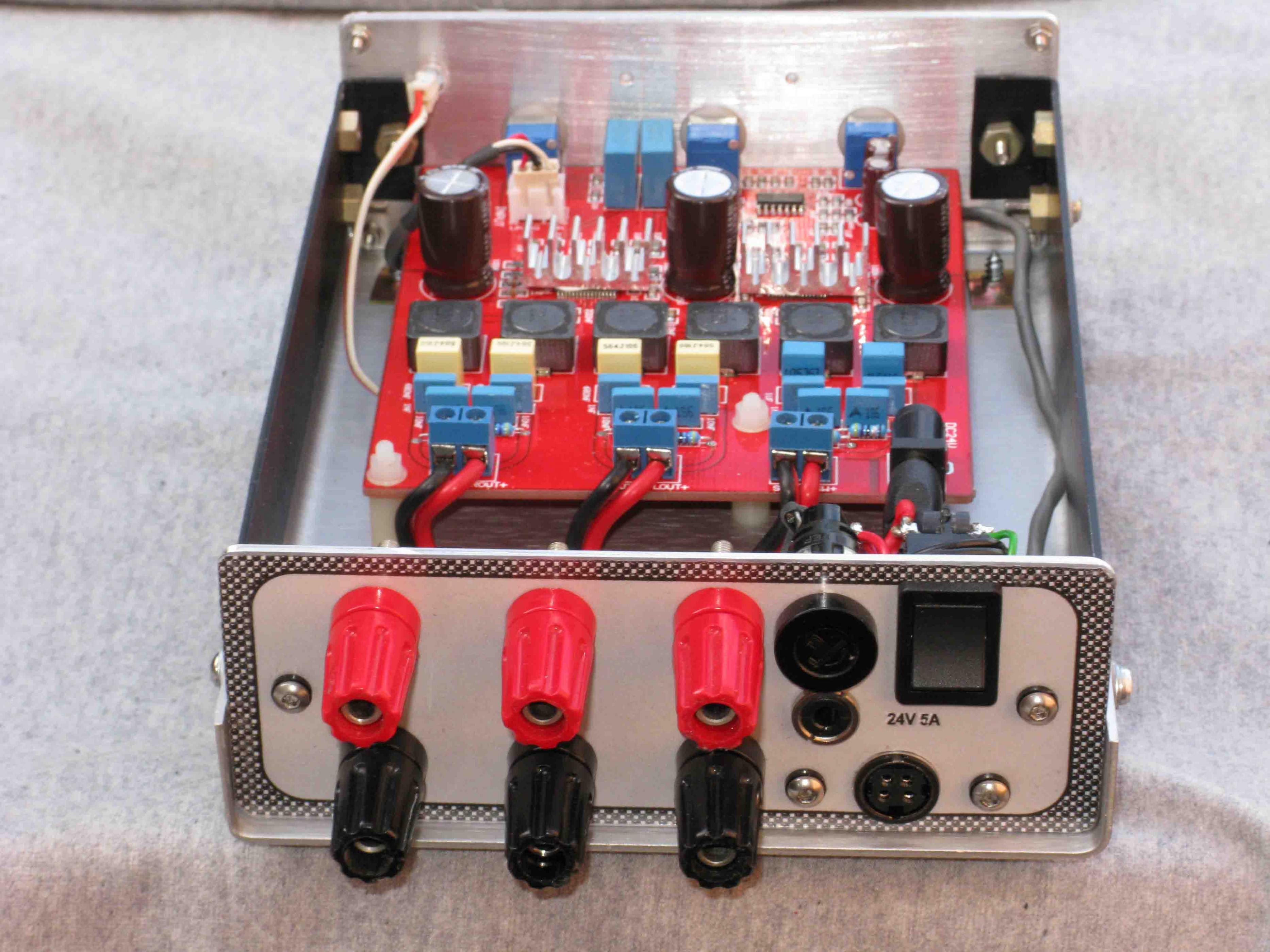

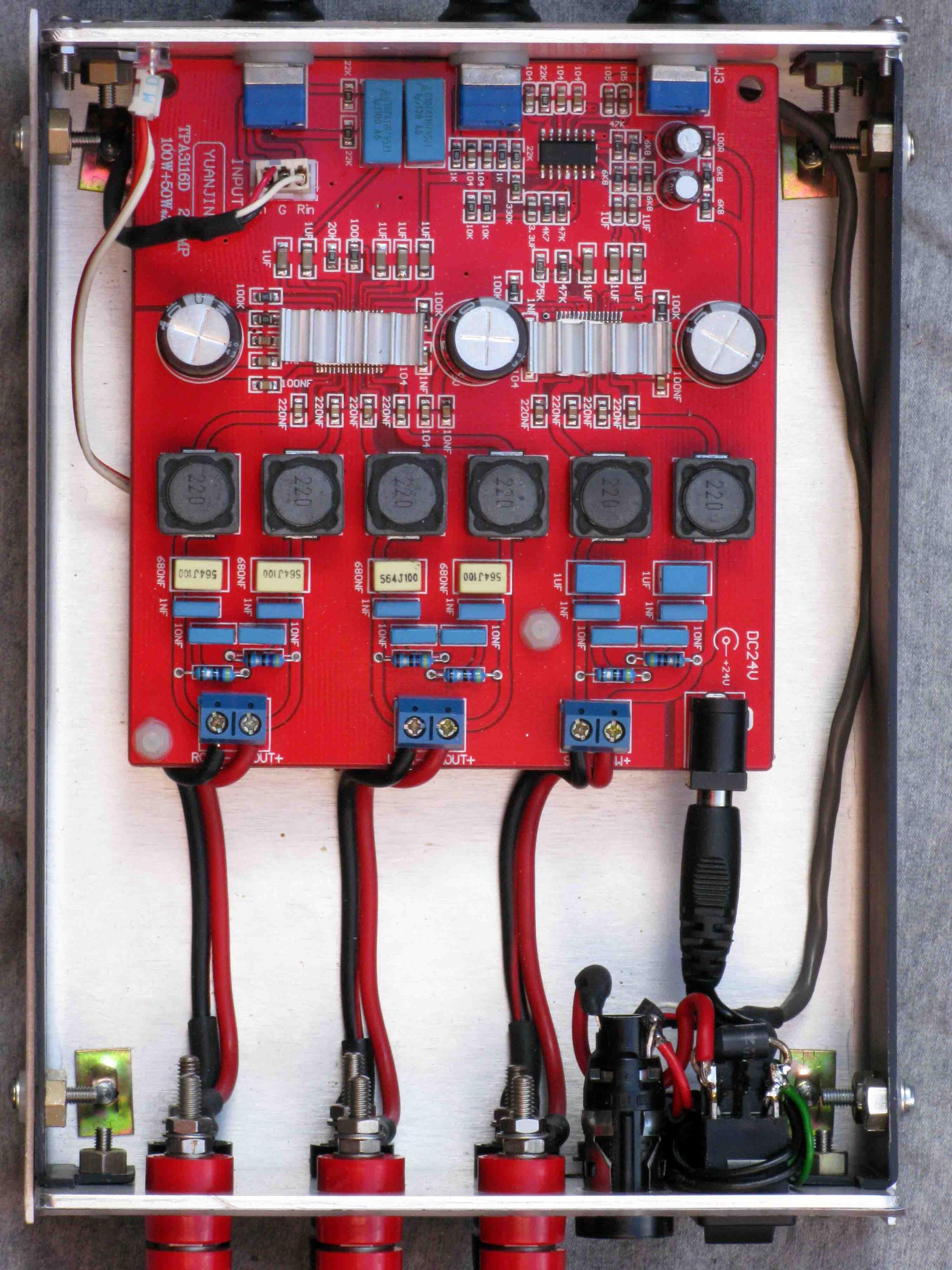

I have just finished putting one of the TPA3116D2 2.1 ebay boards in a case.
The performance, even without any modifications, seems to be very good and at $20 (£13.50) including delivery to the UK it is a real bargain.
The case 1 used originally housed a parallel printer switch. With a new front and back panel it was just the right height and width but it was little too deep.
The extra space was left at the back of the case for any extra decoupling electrolytics across the power supply but the on board ones seem to be adequate.
Running from a 24V bench power supply the current peaked at about 1.5A with the volume cranked up to be quite loud and everything ran very cool. Even at 12V the output was more than adequate.
I'll see how it performs for a while and if no extra bits are required I can reduce the depth of the case by about 40mm. The on board power connector will be removed and wired directly to the switch. I didn't modify the board at this stage just in case there was a problem.

John8,
Very nice work there - super clean and professional looking. Love the re-use of an old printer switcher box - in fact I think I have one somewhere and this is a perfect app for it. What kind of input connector are you using - is it a 3.5 mm stereo jack on the back?

The input is a 3.5mm stereo jack socket under the fuse-holder. The back panel was getting full with the speaker terminals so there was no room for phono sockets. I left plenty of space around the speaker terminals to give clearance for connecting the wires.
The 24V power supply I had was fitted with a 4 pin DIN power plug so I had to modify a PCB mounted socket to make it chassis mount.

John8,
Nice job. May I suggest that you bypass the on board (pcb) 2.1/2.5mm power connector, solder wires from panel conns, directly to the pcb. I guess you could use one of those screw terminals (spkr) as well, if it would fit.
Banana jacks (5 way binding posts) are great for spkrs & power. Did you space them out at 0.75"? for a dual plug?
