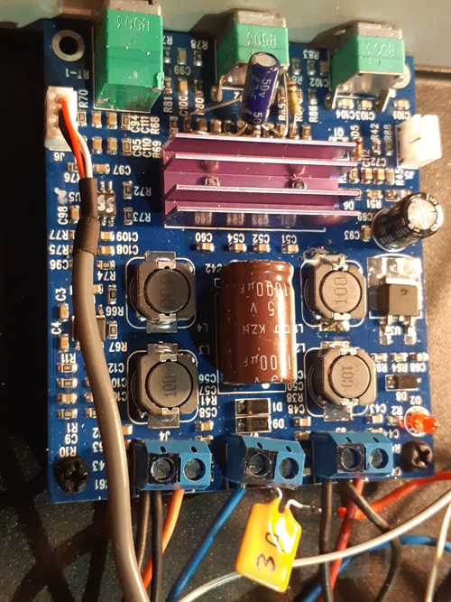

tpa3116 trouble
Good morning,
I have 2 tpa3116 modules from different sources.
One has a Mute connector provided, but with no connecting info.
Another has a USB reader and no Mute
None will work. Outputs keep silent.
I know the Outputs are not GND connected and kept them well separated from Gnd.
Any idea what is wrong ? Are they so very fragile that they die at a mere glance ?
Pwer: 0-20V
input: from Generator or USB
Thanks a lot for your help !

What is the DC level on the MUTE pin (#12)? If positive it's in mute mode and the outputs go Hi-Z though
I have no guess as to what the DC value of the outputs will be in mute. I use TPA-3116 for my TV but have
never used the mute function of the TPA. During normal operation the output DC will be 1/2 of the power
supply but being BTL, does not require blocking caps on the outputs.

One photo of each of the two boards, please. The TPA3116 is very popular here on the forum. Perhaps we already know the boards.
First test: One board at the time, inputs short-circuited, 8 Ohm resistors as dummy loads on both outputs (stereo), 12-20V supply voltage. The scope GND connected to amplifier board minus supply and the scope probe on each of the four output lines, one after the other. Do you have a 400KHz (almost) triangular-wave signal at any of the output lines?

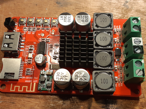

Here are the photos
Good morning
Here are the photos of the 2 sets I have.
One is integrated in a amp set I am making. It is PWsupplied through a Polyswitch, electronic fuse notes 3A.
It is also tweaked for a delayed 'on', to avoid the "plop" start.
Thanks for your advice.

Hi Billy,
Many thanks for the photos. They help us a lot because they show that at least the board to the right, but probably also the board to the left, includes more than just a TPA3116 amplifier. With "more" I mean a pre-amp circuit and perhaps other functionality. The board to the right also includes a control-circuit and USB/MP3 decoding. All this "more" may be the reason why the TPA3116 part seems not to work. A TPA3116 chip includes two pins (2/SDZ, 12/MUTE) with which an external circuit can disable the TPA3116 chip. This may be why your amplifiers do not give any sound because the "more" tell the TPA3116 chip to be quiet.
You ask: "Are they so very fragile that they die at a mere glance ?". Yes, if you work in a team with some of these super-heroes having laser- or X-ray sights and you have been staring intensely on the boards. Else, the reason may be more trivial (unfortunately). Such boards are produced out where the salaries are very low and the designs are known frequently to include errors or the boards are produced using wrong components. Many boards seem to have been shipped without proper testing. You are for sure not the first forum member to have problems with such boards.
Billy, are you confined (like I am) until 11 May such that you have time and energy to engage in investigation of the circuits with a good chance of failure?
If you go on with investigation, a TPA3116 chip is only active with pin 2 (SDZ) being high and pin 12 (MUTE) being low. BUT, it is not that easy to measure because the TPA3116 pins are so tiny that you cannot connect a DMM probe without risk of short-circuiting other chip pins. You need to use your Ohm-meter (without supply power to the board) to find out where pins 2 and 12 are connected and at these external points you have a chance to measure the logic levels when the board power is ON.
Are there any situations where pin 2 is high and pin 12 low on any of the boards? If not, you have no chance of sound at the outputs.
Hi FauxFrench,
Thanks for the input. Yes I did check on those pins and both are indeed to the proper V level, through somme on board 100K Resistors.
I will investigate further.
I have downgraded the gain to 20dB instead of the 26 dB there was, according to the data sheet.
Still it does not perform as expected, I will go on.
