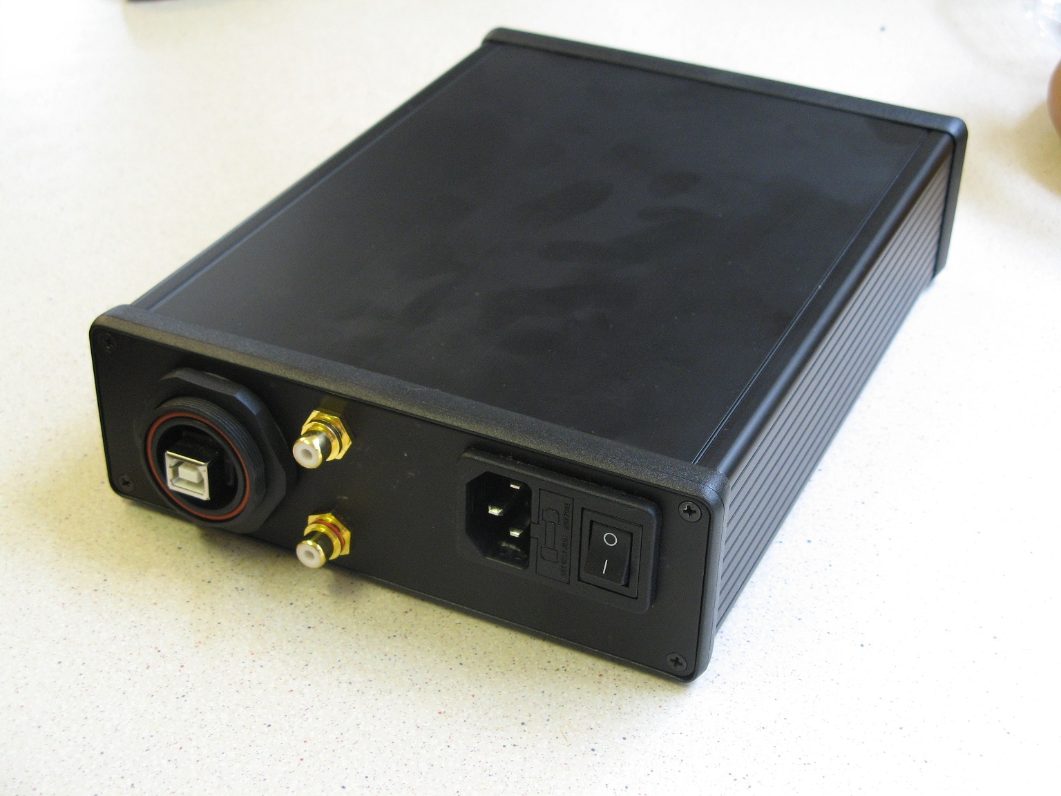

Take a look at those. The hole is larger than neutric but very solid and well isolated. Connection can be with molex type connector, not usb jack, PX0843/B Bulgin | Mouser
Regards
I've used those they are excellent.
Bulgins look great. They are not a standard (D-series) size though, so it might be difficult to swap it with a different connector at a later date.
The Neutrik ones are A/B reversible, have optional screen-to-chassis grounding and are dust/water resistant to IP65 when used with Neutrik cables.
I'm not paid by Neutrik in case anyone wondered. 😀
