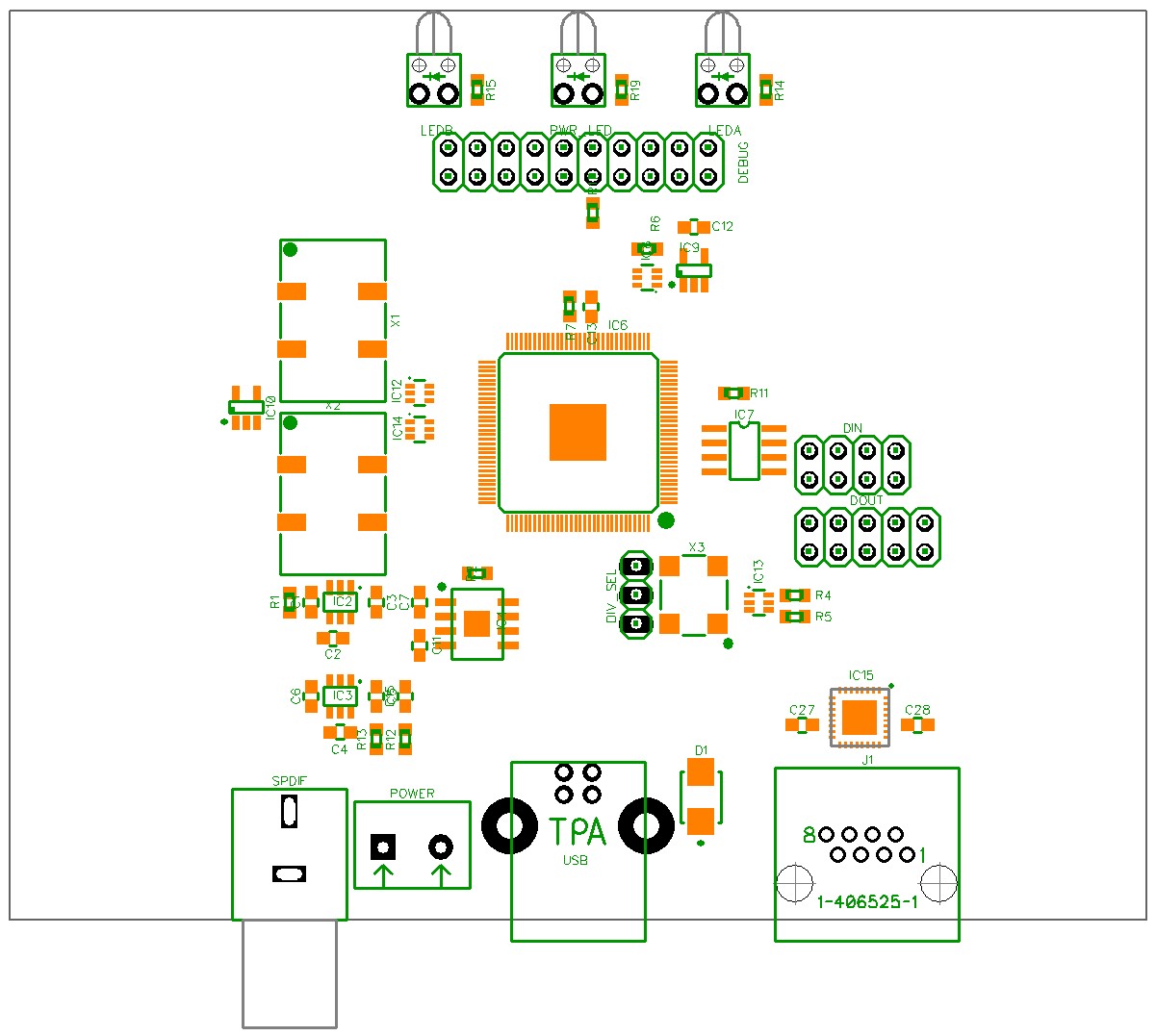

Just let you guys see I am still actively working on this. This is a new layout I am working on. Not all of the components are shown - and some are on the bottom. 🙂
The dimensions may change. The board as shown is design to slip into a case - with the LEDs in front, and the connectors on the back.
Note it has a teleporter compatible LVDS output.
I.e. with a LVDS transmitter onboard?Note it has a teleporter compatible LVDS output.
Output both I2S and DSD - and send a signal to BIII SE telling it to change registers accordingly?
Nic
The...
ESS 9018 will auto select for I2S/DSD when properly set up to do so. The only thing you "might" want to change woudl be the filters, but this is not really necessary to play DSD. I built a B-III DAC for a friend, and set the inputs up in the same config as on the B-II, and he has no problem playing back both DSD and PCM through the same (I2S) input path. He is using a USB interface which multiplexes dSD and I2S on the same output to suit...
Nic

Yeah I am just saying to do it would require custom firmware. I am sure it is possible.
For everyone else out there DoP transmits DSD data over PCM.
Honestly - it sounds interresting, but its not a huge priority for me to start. But it could easily be added by the user since we will expose the JTAG interface.
If we find reasons to update the firmware people can apply such updates (or optional firmware) themselves. 🙂
I hope...
that the TPA USB solution will also have single ended I2S output on U.FL for those of us who may want to place the board in close contact with a DAC board without the LVDS signaling.
I prefer to keep everything in one chassis for simplicity.
