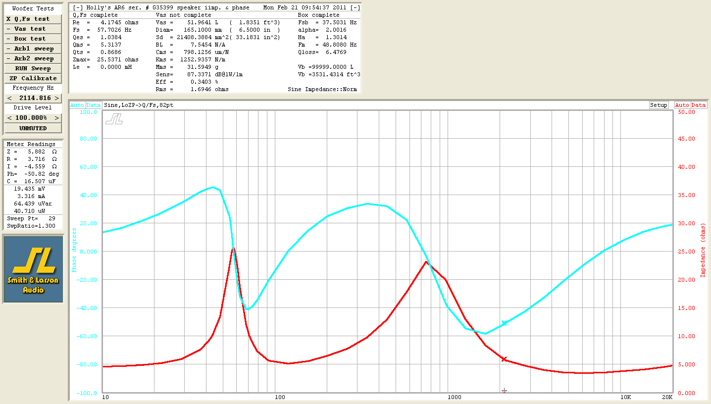

Here's what an impedance reaction looks like for a 2 way speaker. The red line is the impedance plot. It can easily be measured with a woofer tester (WT2 or 3). As you can see, it varies quite a bit with frequency.
as in the impedance reaction plot as shown above, if the impedance is not 'constant' across frequency band of its operation, then is not xover point will change as the impedance changes? do i only need to consider impedance at xover point and not bother about its value at rest of the band while designing xover network?
What you saw in my post was a SYSTEM impedance of a speaker. What you want is the impedance plot of the individual drivers. Then you can pick off those plots the impedence value at your xover point of choice and plug those values into your xover calculations.

Choosing one point is the best you can do unless you take measurements. Which point? ... you will need to follow up until you like what you have. Shown below, you can have good summing at one point but further out, phase issues can cause cancellation. You can also have level issues.
