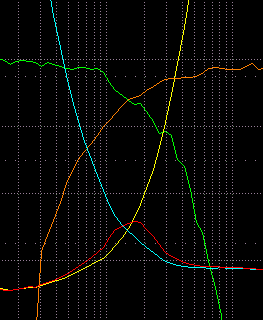

Choosing one point is the best you can do unless you take measurements. Which point? ... you will need to follow up until you like what you have. Shown below, you can have good summing at one point but further out, phase issues can cause cancellation. You can also have level issues.
