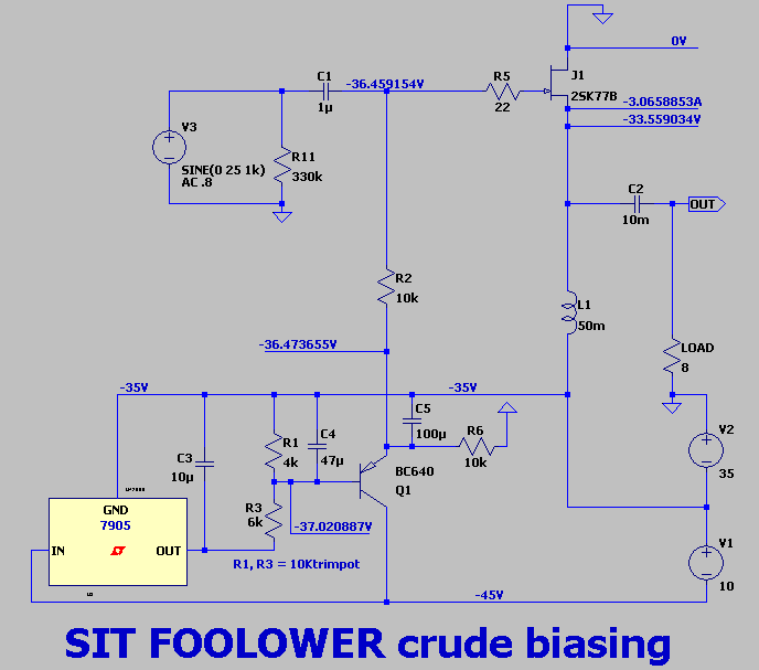

well, I like things little more controlled
if nothing else, I would use buffered potential divider (pot), then properly dimensioned gate shunting resistor to bring biasing voltage to gate
small TO92 bjt is appropriate for buffer duty
attaching napkin sshot impossible, typing on dumbphone

here it is, napkin level of sophistication
though, I'm sure that ra7 will say - it's complicated and he want something simpler, but to allow even dead SIT to work flawlessly

Thanks for posting. Doesn’t look too complex. I tried something similar with FETs. Actually I tried many, many combinations with FETs but was not happy either with the complexity, stability, or sound.

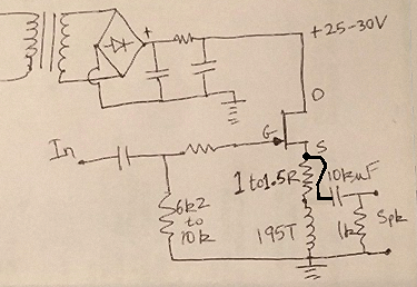

Back Biasing!
Below is a drawing of a couple of simple versions of the amp.
#1 is simply a bit of added resistance on the source pin to get the Vgs in the right zone. In the two devices I have, one needs about 1.0R whereas the other needs about 1.25R to get about 1.4 amps. This resistance is in addition to the choke, which has a DCR of about 0.68 ohms. The gate resistor is 10k or if that proves unstable, then go down until it stabilizes.
#2 is called "back biasing" where you obtain a negative voltage from the same supply and winding by inserting a resistance between the negative rectifier terminal and ground. I read about it in Blencow's book. The idea is as old as tubes and was used in old tube receivers to develop the negative bias needed for tubes. (ZM, you mentioned Papa did this at some point too. I have not seen it, can you share more?).
Both these arrangements are kind of self-regulating. More current leads to more negative Vgs, which reduces the current.
With this arrangement the choke is directly connected to the source. Not yet sure if that is better, but I find this very neat. I am listening to it now. No noise, no hum. Bias is very stable. It retains the thundering bass at least. More listening impressions later. Fun stuff!

Would it work if the load connection is moved "above" the bias resistor? That also gets the Ohm out of the direct audio current path (a loss of audio power and reduction of damping).the choke is directly connected to the source
Yes, that works just the same, except now the resistance is in parallel with the 1/Gm of the VFET in terms of output impedance (depending on which one is the dominant one, it might be better this way). I did hear it briefly and it sounds perfectly good. In fact, I'm feeling like both simple #1 and #2 are better sounding than the one in the first post.
Edit: PRR, I see it now. Taking the output from the source directly might be better from an output impedance perspective and also getting some more power.
