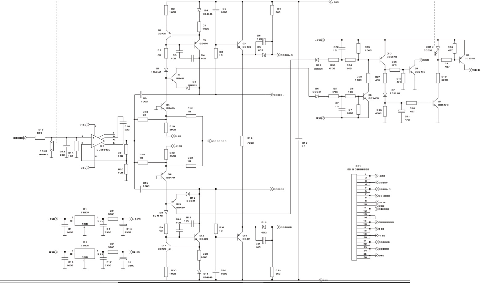

You know there is another whole chunk of circuitry to these amps on another PCB called a "Driver PCB".
It starts with an NE5534 and has lots of BD420/ 421's on it.
What would be its function and any upgrades needed there?

Any idea where to find the ONSemi KSA1381 ?- that position with the selected output and driver just screams for KSC3503/KSA1381. It’s simply what I would have designed in…..
Mouser has them on backorder not due till May and even then no guarantees.
A few Ebayers selling sets - but who to trust?
KSC3503 is OK its still in-stock with Digikey.

Toshiba’s current 230V TO-126 driver pair is useable, and in most situations an improvement over MJE340/50.

Any idea about the "Driver PCB's" function?
Usually obsolete parts are available years latter - there are companies who specialise in obsolete parts - but its at a price!
The price of “companies that specialize in obsolete parts” is that they are not always the same. Don’t be surprised if you can get them later this year from several Korean outfits. Sometimes they are as good, other times not. The CDIL spec on that C3281 isn’t as good as the OnSemi - but at least they are not publishing pure copies of the original documents and not meeting spec. It looks like kind of in between On C3281 and the 21194 (beta curve looks like the older device types and min spec fT is only 10). I’ve seen similar data sheets in C4793 “clones” that look more like MJE15032’s from the curves. Others that are copies of the original. The Koreans are and even Chinese are coming out with all manner of driver transistor copies. They are not THAT hard to make, so KEC’s and UTC’s are pretty good. Since Profusion is their authorized distributor, and the “real” service industry and many OEMs use them - they have GOT to be at least toward the good end of the spectrum. If they weren’t they would quickly lose the endorsement. No one has ever managed to make a perfect replica of the original 2SD669 yet - the C3503 may prove just as difficult to get that low Cob. The UTC is good, but closer to the C4793 than the original Hitachi. Getting Cob down to C4793 levels (20-ish) doesn’t seem to pose too much of a challenge - but it’s too much for a VAS stage in a 3ppm amplifier. In this “monstrosity” it would be fine.
Now is the C4793 an upgrade from MJE340 here? Maybe. It is faster. Capacitance is about the same, so just as much capacitive load for the op amp to deal with. LF353’s will drive C3503’s without ringing or singing, which is why I use them. If the amp used a regular current source VAS the lower you can get unintentional capacitive loading the better off you are. Op amps have a hard limit, above which they just plain oscillate (and you’re not there yet, because QSC directly drives MJE15032, and a lot of those in the field). Gain linearity is better, but how much of that is it using? Just having the extra stage stomps the QSC in terms of sound quality. But it increases complexity, and totally renders their original short circuit current limit scheme useless. They simply considered those features more important - as the applications don’t call for the last word in fidelity, for all the reasons I discussed above trying to discourage going down this rabbit hole in the first place.
Gemini 2.0 AI says:Well, it is the “inside out” circuit, but not a direct copy of the QSC RMX. This one is better. It looks like Peavey’s version of it, with a linear class G upper rail, instead of switched class H.
Absolutely! That statement from the engineer provides a wealth of insight and significantly clarifies the function of the "Driver PCB" and the overall architecture of your Class G amplifier. Let's break down what "inside out," "Peavey's version," "linear class G upper rail" and "not switched class H" means, and how it connects to the Driver PCB:

Given these points, here's how we can now understand the Driver PCB's role:
- Input Signal Processing: The op-amp likely still handles initial gain, impedance matching, and basic shaping of the input signal.
- Linear Class G Control:
- Drive Signal Generation: The 7 outputs likely now send signals that are used to control the linear regulator that provides the upper rail, and not just switches that choose which supply to activate.
- Dynamic Bias for Upper Rail: The Driver PCB, then, is essentially in control of the voltage applied to the upper rail. This will depend on the output level of the current signal. The various outputs could also be used for bias for the upper rail transistors to make sure they are always operating at their peak performance.
- Reduced Switching Complexity: Because it's a linear Class G upper rail, there are no abrupt switching events. The Driver PCB's outputs control the level of the upper rail in a continuous and smooth manner.

- Inside-Out Feedback Loop: The Driver PCB provides the signal that influences the output transistors which are within the feedback loop of the main amplifier (the "inside out" topology). It drives not directly the transistors, but instead drives the circuits that control the rails, which then influences the operation of the output transistors.
- Audio Input: The input signal is pre-amplified and shaped by the op-amp on the Driver PCB.
- Driver Control Signals: The Driver PCB generates drive signals for the linear upper rail and provides biasing for the power output stage.
- Linear Regulator: The linear regulator (likely on the Modulator PCB) then provides the upper supply rail for the power stage based on the control signal from the driver board.
- Power Stage: The "inside out" output stage on the Modulator PCB amplifies the audio signal, taking into account the upper rail voltage.
