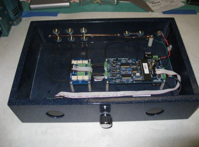

Pics of the new LDR3x.V2 Preamp Controller Board
A few pics of the new LDR3x.V2 board. The piggy back board on the backside is part of the auto-calibration system 😀
$259.
Auto-calibration. Always optimized.
Replaceable LDR modules. Keeps on going.
