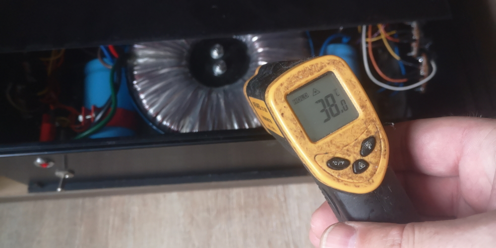

useful tool although certainly not super accurate

osscar looks likt the one they use to measure your forehead temperature before entering the supermarket nowadays 😀

- Toroidal transformer suitable for recaping
