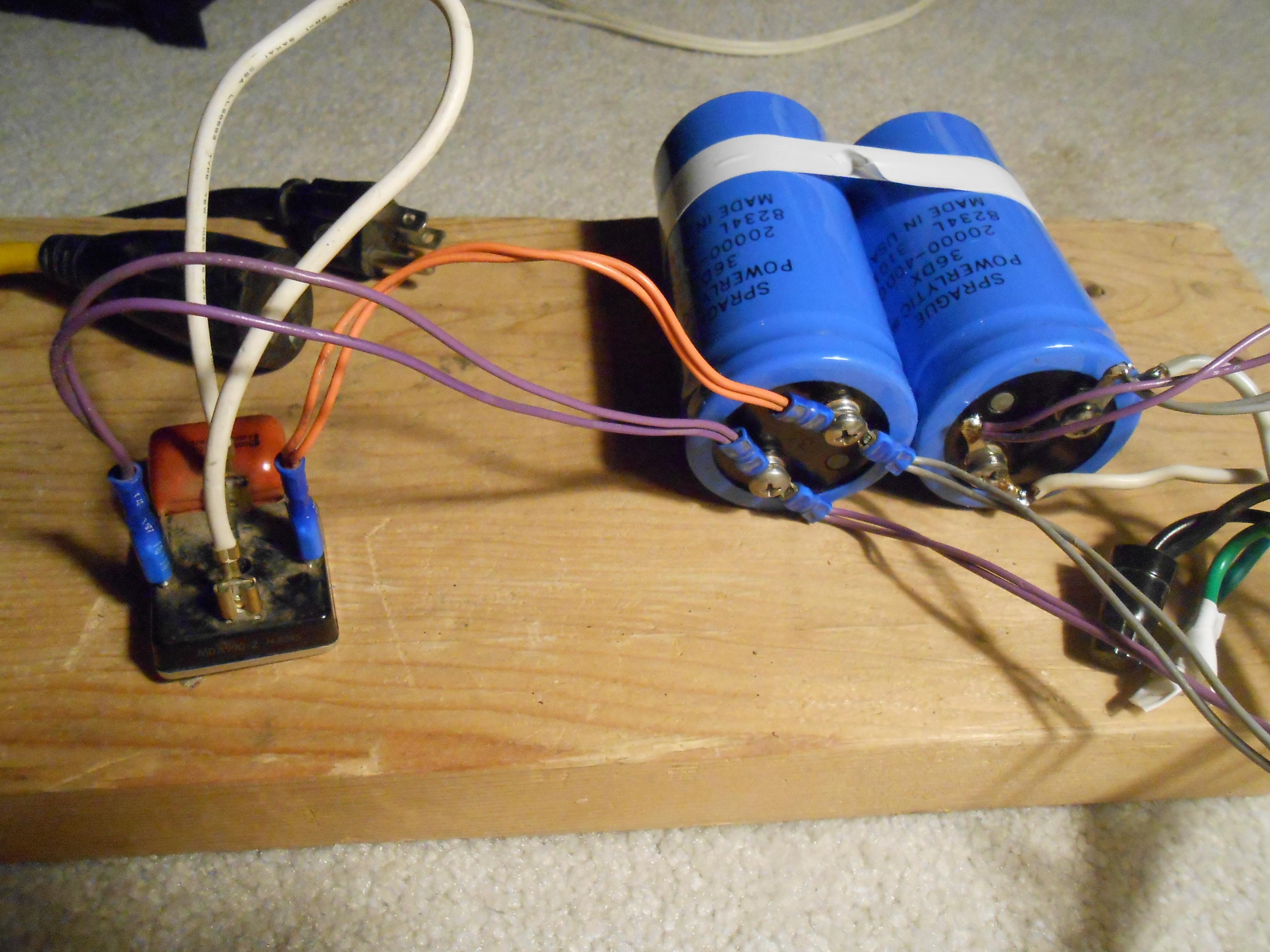

At the risk of abusing your expertise;
I am finally throwing together a test set-up of a DC Blocker, I am out in the sticks, so quick access to parts is limited to my electronics 'grave yard'.
Can I use a large 30 amp bridge ( MDA990-2) ? It only has a Reverse Voltage rating of 100 V. Given the type of connection, my thinking is this bridge will never 'see' more than just under 2 Volts.
OK, after 66 posts, I have built a 'DC Blocker'. The bridge (above) with + connected to -. Two 20,000 uF , 40 V caps, reverse paralleled. This circuit had no effect on the noise level from the Toroid.
I had the circuit set up so it could be rapidly bypassed for comparison. (no difference)
I installed my Fluke DVM across the blocker and measured 1 mV or less with the meter set to DC, and about 90 mV AC, with the amp idling. I did see a spike in DC voltage when the Micro wave was started, but the DC Voltage returned to an almost immeasurable level within a fraction of a second, but the noise remained.

Parden the appearance of my thrown together setup, but electrically, it is the same as the Bryston 4B circuit. I still want to investigate the noise or DC situation on the line voltage, but has anyone ever treated the windings of a toroid trans, post manufacture?

Yes there were a couple of reports on trying to impregnate windings of transformers.
Ordinary varnish will not work well.
The big problem is getting the transformer impregating resin inside the insulation to fill all the air spaces. Vac/Vac impregnation is good at sucking the air out to be replaced with resin.
Then you have to cook it till the resin sets.
Probably need to repeat to fully satuarte the outer windings.
Almost no hope od saturating the inner windings due to too many layers of tightly wound Prim to Secondary insulation. Absolutely no hope of impregating the toroid core.
