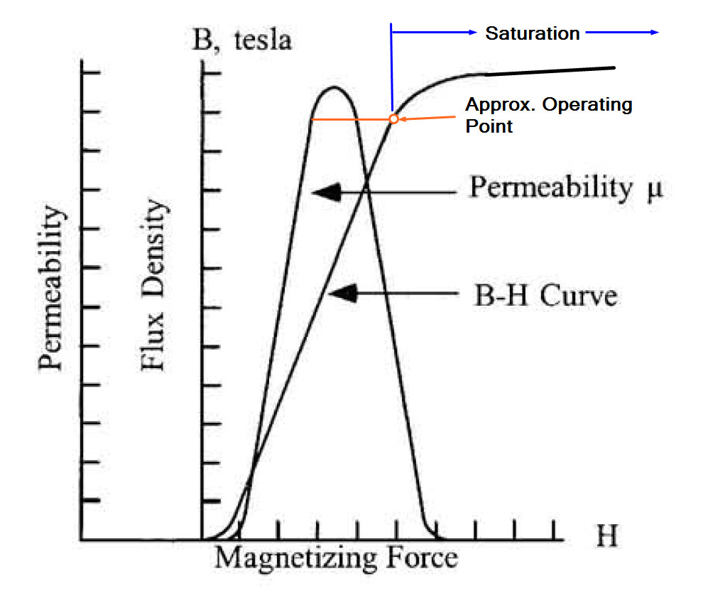

Matys problem is probably not DC at the mains but core saturation.
If you have a variac (variable transformer) it is easy to pin the problem.
Otherwise you can f.ex use a smaller transformer (1/10 of power of the device transformer) with a 12VAC secondary and connect the primary to the mains and the secondary out of phase in series with the mains transformer primary, to lower the mains voltage by 12VAC
Then you'll move the operating point to max permeability and out of the saturation knee, were the permeability (& inductance) goes down very quick and cause noise and heating losses.
See diagram below borrowed from Wiki: https://en.wikibooks.org/wiki/Electronics/Transformer_Design
Of course you lose some max output power, but the difference is almost inaudible.
