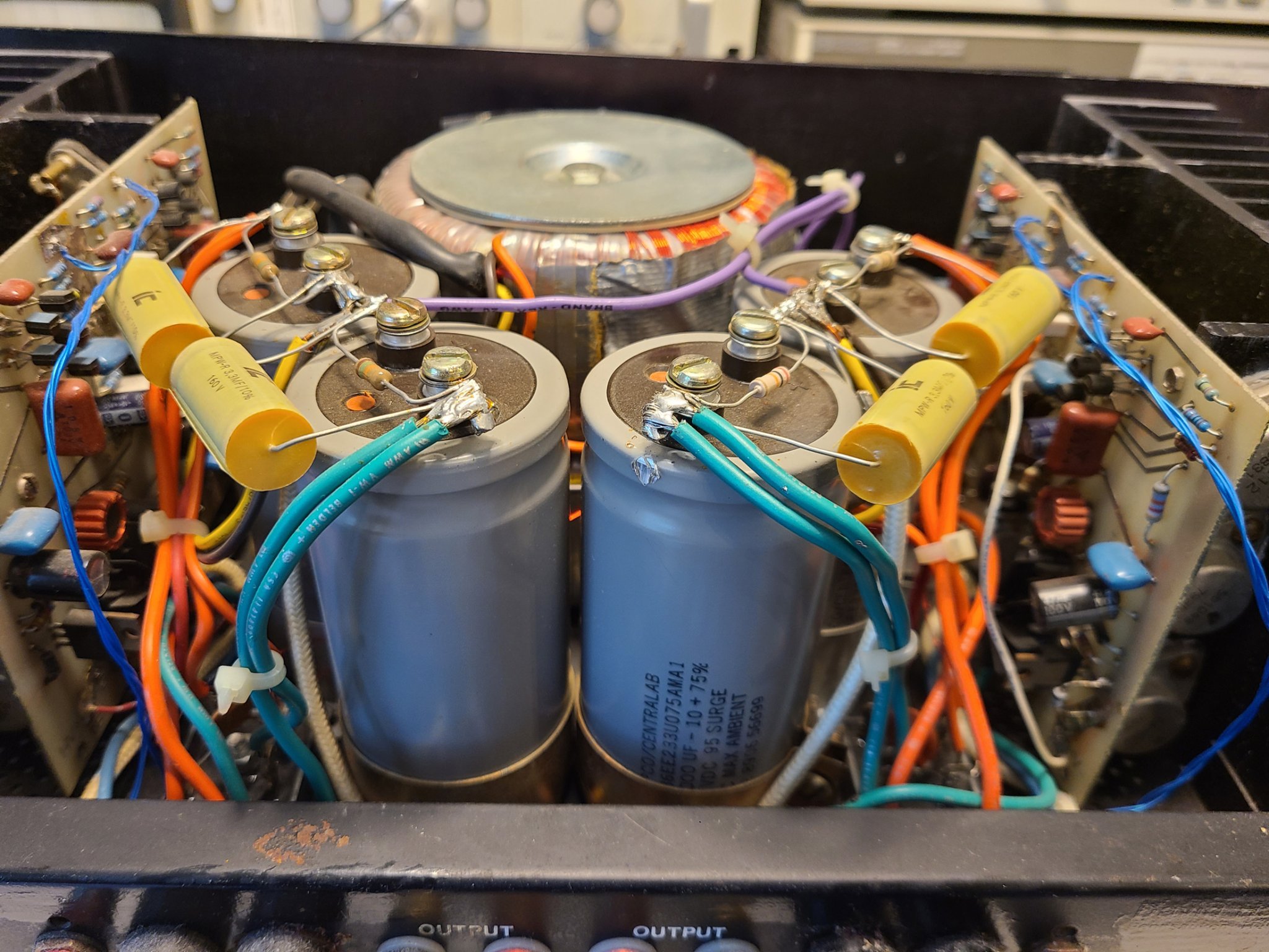

I had bought two toroidal transformers from Toroid.com in 1987 or 1988 when they were in their infancy. I made a dual mono power supply in a Hafler chassis and stacked two 360 VA transformers to shoehorn it in. I have never heard a sound all these years, except the amazing light dimming when I turn the amp on.
Naturally prices have gone since then. But I was the first to ask for two secondaries to give me +/- 70V DC after filtering. At that time they made them custom for what I considered normal prices and then your design became part of their catalog. I never stacked toroids before, but encountered no problem over the years.
I just read the founder retired in 2006 and his daughter is running the company now. I am sure now that I talked to her personally back then when I ordered the transformer from them. Was actually looking for a new transformer for one of my projects. I certainly would pay extra to have one made in the US.
Anyways this is just my experience. I actually have no line filtering except a small cap across the line.
