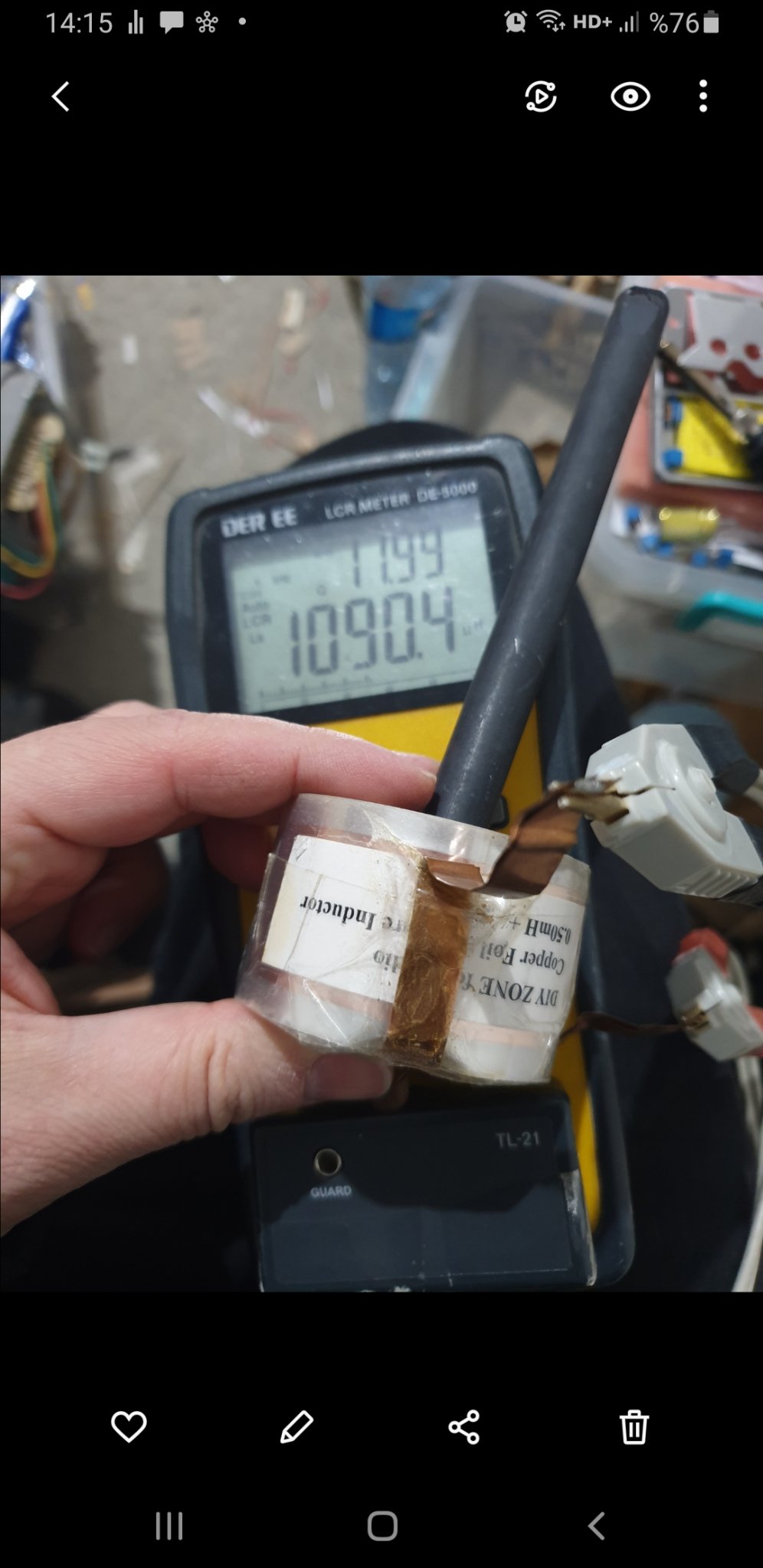

Hi. I already found a core in my stock afaik it is ferrite but don't know if they are similar material as you sent here. Can I cut it in half and use it for my low frequency purpose?
I would just leave it alone and deal with the extra length of ferrite rod, or maybe try to push it in so that it is more symmetrically oriented with respect to the coil.. Keep also in mind that the other inductors in the crossover will need to be oriented at right angles to this one ( if they are similar style construction) to avoid spurious pickup.
