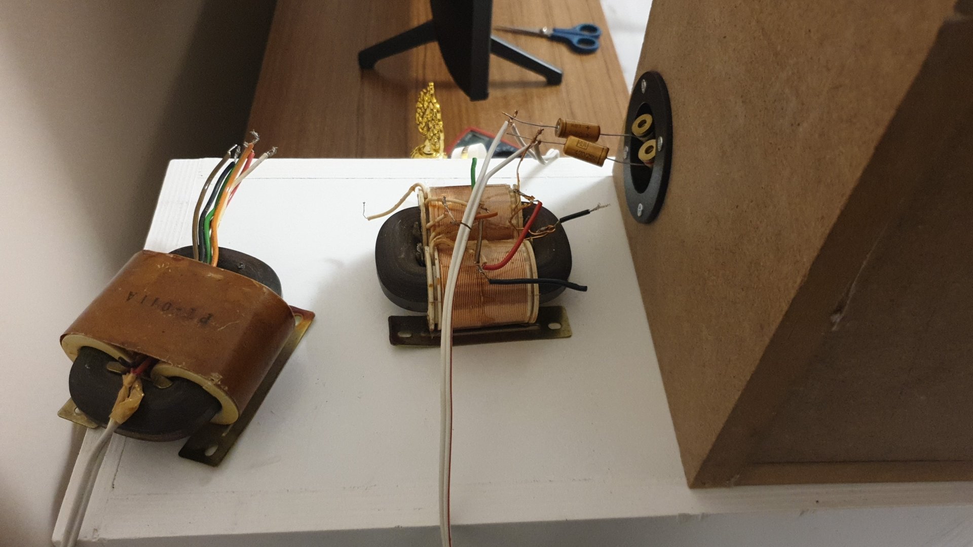

İ did an interesting try. I measured secondary of R core transformers which I have in hand and it was 72mH - 72mH. ( Center tapped ) I short circuit one side of 72mH and measured the other and it appear about 7mH Maybe short circuit decreased the magnetic flux a lot. I connected in series to sb34nrx75-6 woofer and put 235uf for full ranges (series 470uF made bipolar 235uf)and sound is surprisingly good

It is important not to short circuit windings on a core unless you mean to. Keep the other winding open if you don't need it. The fact that you didn't measure zero could be down to inefficiencies (resistive losses and leakage inductance).
