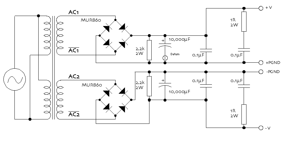

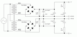

This is the correct drawing, the one shown earlier is probably just an older uncorrected version . I expect the boards are right though....
