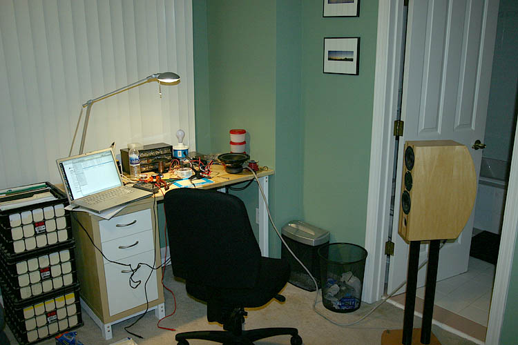

The speaker on the desk is indeed a B20, there's a more "up close" photo in the additional photos I linked to. Nelson Pass was very generously giving them away at Burning Amp. At some point I'm going to put them in a set of Curvy Chang enclosures.

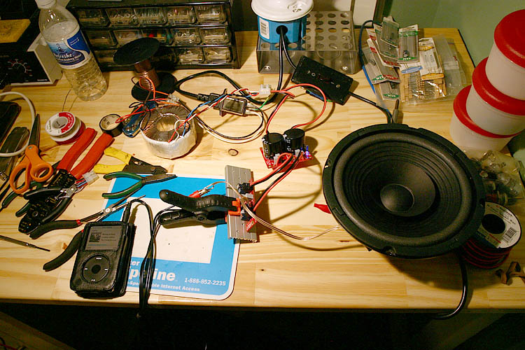

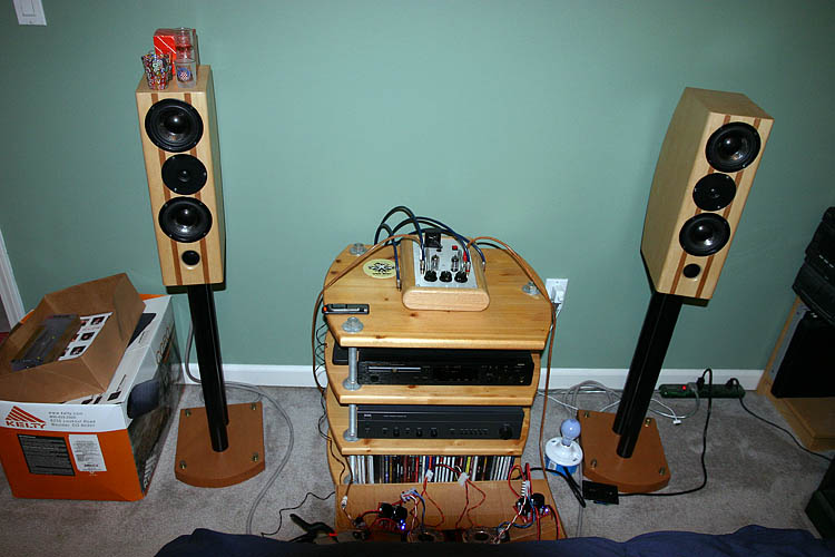

The amps are wired and playing music (Dire Straits) as I write this. Here's a photo of the test setup:

The chips are on undersized heatsinks and not yet mounted using any compound, the heatsinks are running ~101 deg F while playing at a low volume.
I was hoping for rails around 30v and wound up with 35v rails, so I'm a little concerned about issues with a 4 ohm load. Hopefully decent heatsinks will solve that issue. Is there anything I should watch out for as an indicate of amplifier distress?

Ok, so enough technical business, how do they sound? 🙂 (caveats: no enclosure, wired through ancient and corroded rca jacks, still using a 60w lightbulb as a fuse)
So far I am impressed. I'm not sure if I'm ready to say they sound much better than the NAD, but I haven't had a chance to turn up the volume yet. Imaging and "space" around instruments are very impressive. The sound is very clean, though I'm worried that the treble might be a little bit too thin since cymbals don't have a lot of ring or air to the sound. I'll have a much more detailed review tomorrow when I can turn up the volume a bit.

slomatt said:The chips are on undersized heatsinks and not yet mounted using any compound, the heatsinks are running ~101 deg F while playing at a low volume.
With no input connected I hear a slight hiss in each speaker from a distance of ~3". . .
. . . The chipamp has considerably more gain and the [preamp] hum is very noticeable, I'll have to work on debugging the preamp soon. . . Another issue is that the tube preamp puts out a lot of voltage on the outputs, when coupled with the high gain of the LM3886 this means the usable range of the volume pots is about 1/4 turn. I might consider padding the input of the chipamp to compensate.
Hi Matt! Those speakers are gorgeous!
101F is an excellent temperature for those amps, indicating good health.
For 4 ohm loads with 35vdc rails--its just fine on more generous heatsinks. That's a nice voltage to use because it helps prevent clipping (in comparison to 30vdc rails). So, its good.
Please do check the temperature of the power supply caps, as their temp indicates the health of the power supply.
For a little gain-drop along with a little less DC, replace the 1k at the input with 2.2k, but save that 1k for the next step.
Next, recycle that 1k instead of 680R at the NFB. Specifically, that's using the 1k in the NFB instead of the 680R. That will drop the gain sufficiently for use with a preamp.
With no input connected. . . Okay, if the amplifier doesn't have a potentiometer, you can use a plain resistor as an additional load. This additional resistor would go, from signal, to signal ground at the amplifier input signal connections. Usual values here are 20k, 22k, 33k, 50k, 56k, 100k, and any of those should stop that little noise. 😉
An extra, precautionary measure, is to measure the DC offset while the preamp is connected, but outputting no signal. That will identify if your preamp contains a DC blocker or if you need to add one. The measurments would be "slightly" higher, but not a huge figure, if there's already sufficient protection.
